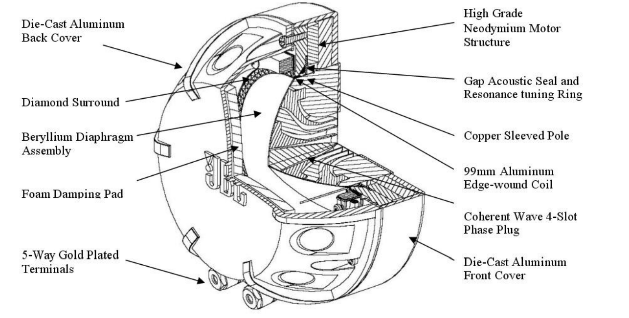

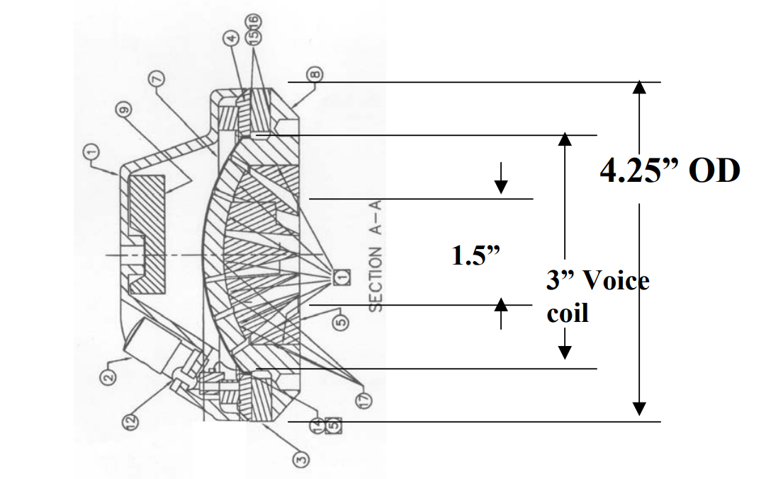

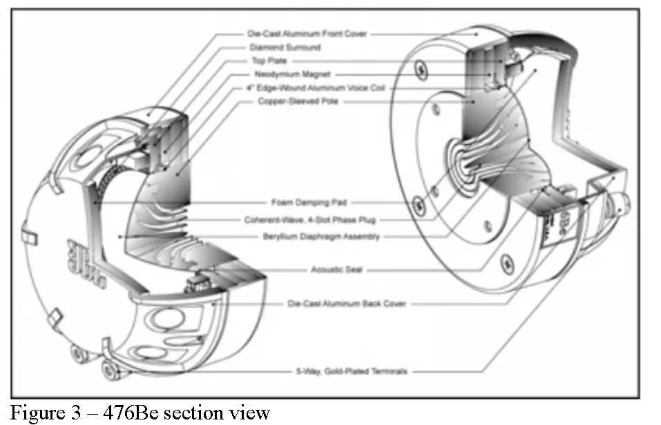

Also as for the HF dropoff that is partly due to the phaseplug/throat of the 243X drivers, not only due to the 1,5" exit.
You can see the difference in the cross sections i added between the Cohherent wace phasing plug of the 245x/476, and that of the 243X (2435 in the pic) which has a more 'traditional geometry.
