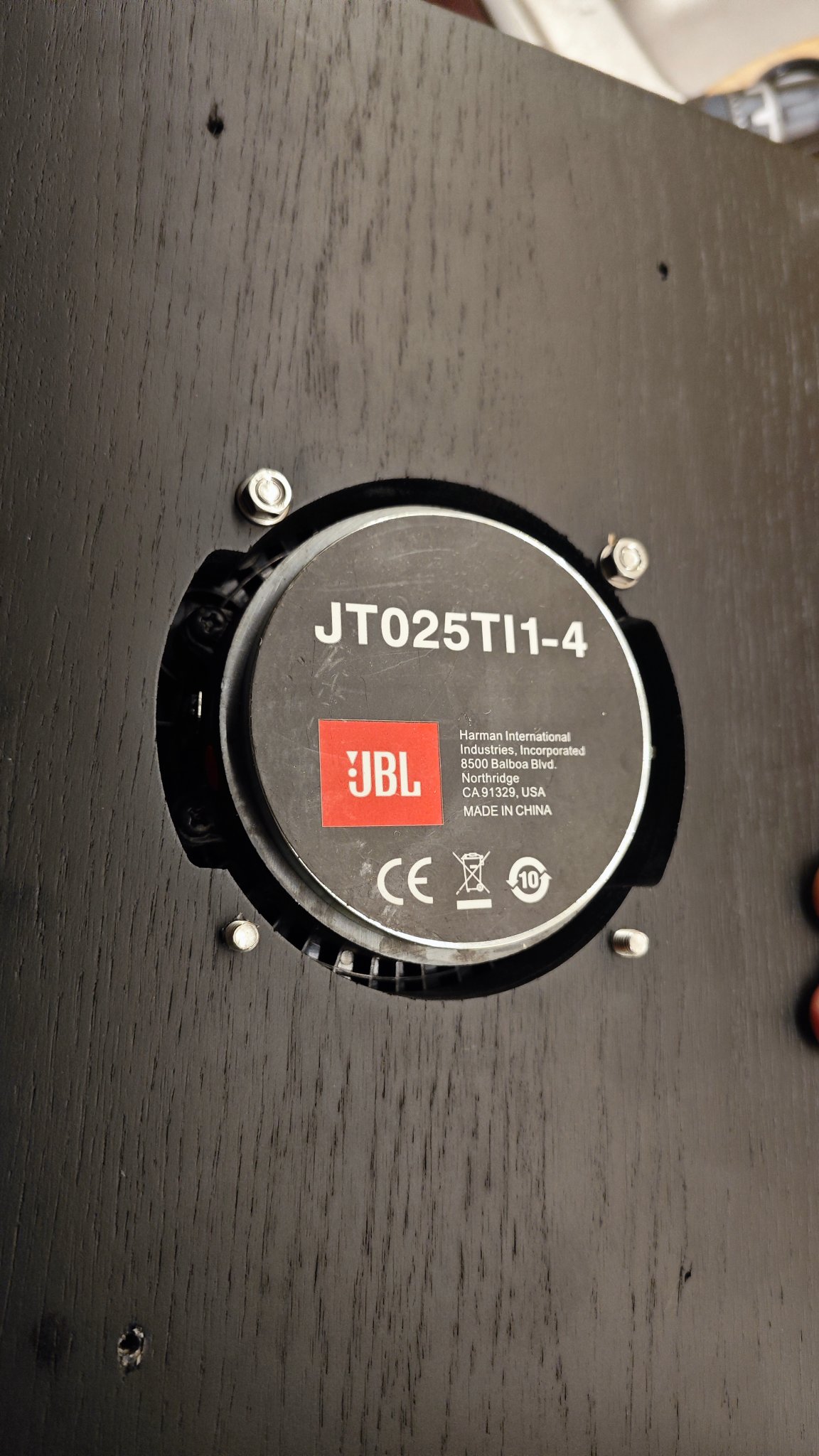

I have JBL Studio 580 that are budget, but pretty interesting speakers, however their horn driver crossed over at 1500 Hz really lacked definition or beauty and just didn't do justice to my amplification. However I really really like the titanium tweeter in the new JBL classic line (L100 and L82 classic) and since I know that L82 crosses over at 1700 Hz I thought I'd give it a shot. I tried connecting it directly to my amp with DSP and it's pretty much linear from 1500 Hz and the same cannot be said about the horn driver that was originally in the speaker. So now I just want to create a third order filter (like is also found on the bass drivers in my 580 or at least I think it's third order based on my limited understanding) and put very simple third order filter on the titanium tweeter. I already tried integrating it with DSP and it works beautifully. Now I just need passive crossover and I'd like to utilize the components that are already present in the high pass filter. The level I will adjust easily with a resistors, but since the original horn driver had a high frequency roll off and some other irregularities, the high pass filter doesn't work with my titanium tweeter. Could somebody point me in the right direction in terms of what should I remove from this circuit to make it the most basic third order filter, what should I add?
So yeah, looking for advice that a novice like me could take action on in terms of modifying and simplifying this crossover, namely the high pass filter. Many thanks 🙏🏻

The titanium dome tweeter is JT025TI1-4 (people from ASR forum were unable to find the specs), the same that I have in the picture and the same that L82 and L100 classic have. When I measured it without baffle outputting sine wave straight from my amp it appeared to be very linear down to right around 1500 Hertz at which point it started dropping off and if I recall correctly 1200 Hz it looked pretty out of shape but it was totally fine until right around 1.5k. I know it crosses over at 1700 Hz in L82 classic, hence my gamble on buying these. Well, that and the fact that I really love how these tweeters sound. They have to me a little bit of that B&W 700 series tweeter sound which is super detailed and which I love. But since I have measured them to be pretty linear all the way to 1500 Hz I would like to just keep the filter on the bass drivers and come up with something for the high pass.
The 580 have pretty cool and interesting cabinets for the relatively low price that they used to sometimes go for. Pretty well braced and thick MDF boards with pretty much no parallel walls.
By the way the titanium dome tweeter is over twice the weight despite not being in a compression enclosure and the waveguide is plastic too. So while it's not as efficient, it's actually pretty efficient as a dome driver, definitely a lot more magnet on it. Still of course the resistors will have to be replaced. Should I just buy a bunch of cheap ones and see, listen, measure which ones work the best or how is that usually done?

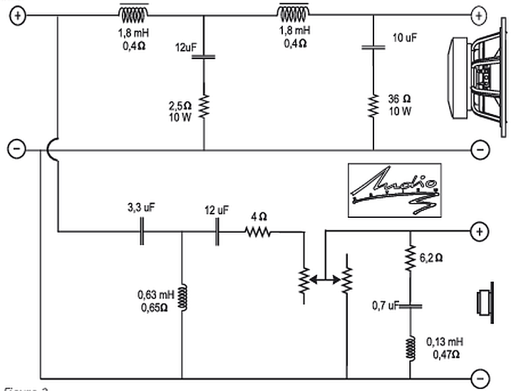

Here's a pic of the JBL L82 schematic ( it comes from an Italian review of the L82 > which I've included as a pdf file attached below ) .
Assuming you actually have the exact same tweeter as the L82 ( you didn't clearly state that, you just inferred it ), > then build up the high-pass portion of this pic and then give your new ad-hoc creation a listen.
The variable Lpad seen in the pic is most likely the 8 ohm variety.

Yes, I have the same exact tweeters as in L82 and L100.
Building just the high pass portion wouldn't work as I wish to keep the low pass filter, but it is crossed over at 1.5 khz. Still, thanks for the schematic, I might ultimately decide to just build 1.7 khz crossover from scratch, but I'll try modifying the existing high pass filter first, maybe use some DSP which I usually use anyway to bring it to where I want it.

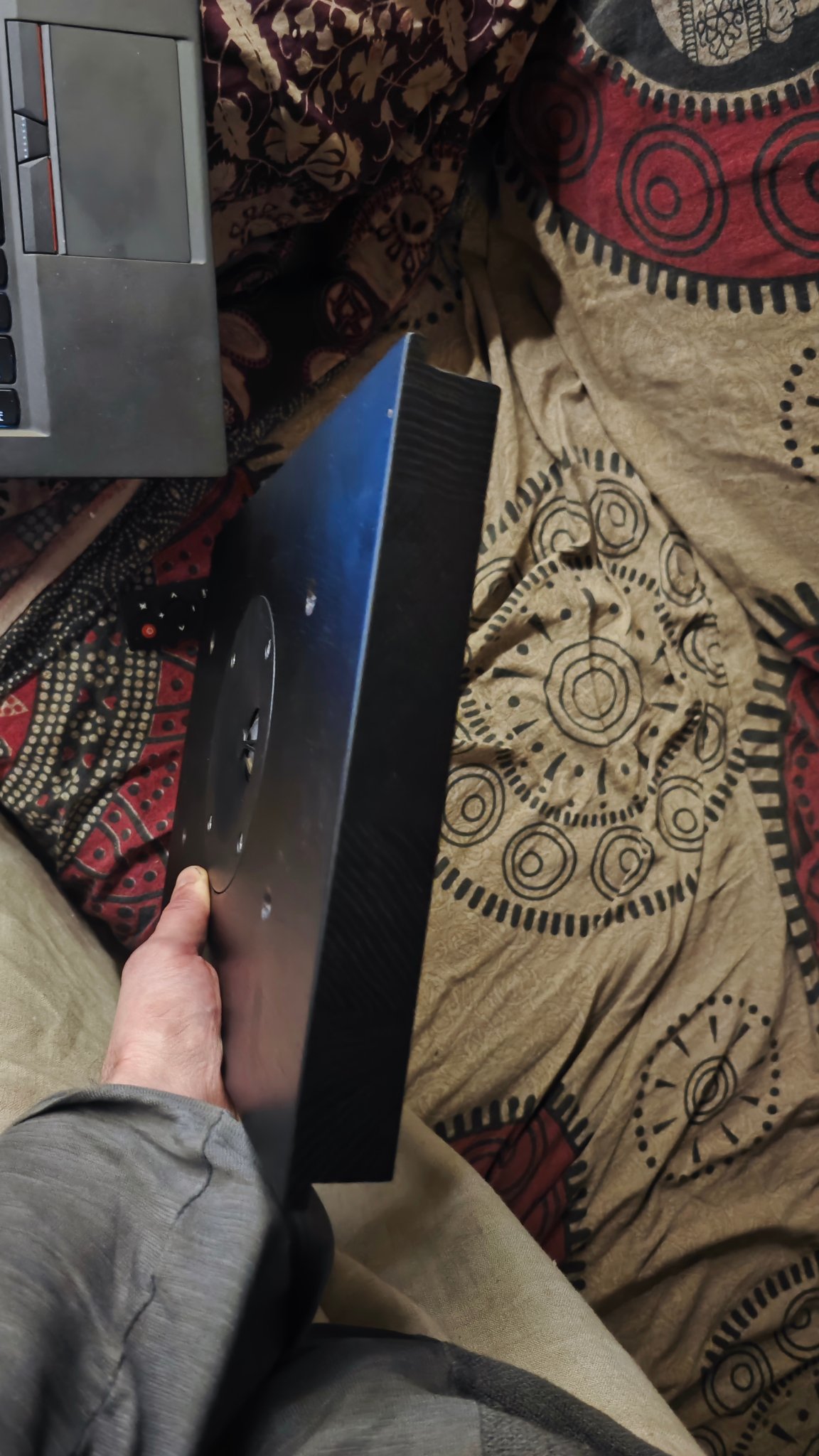

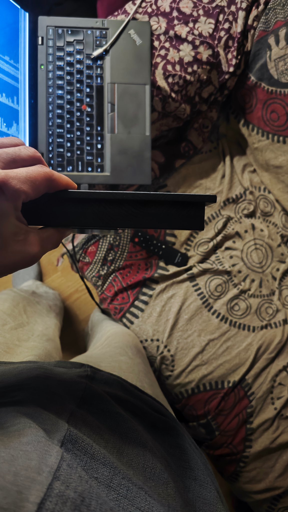

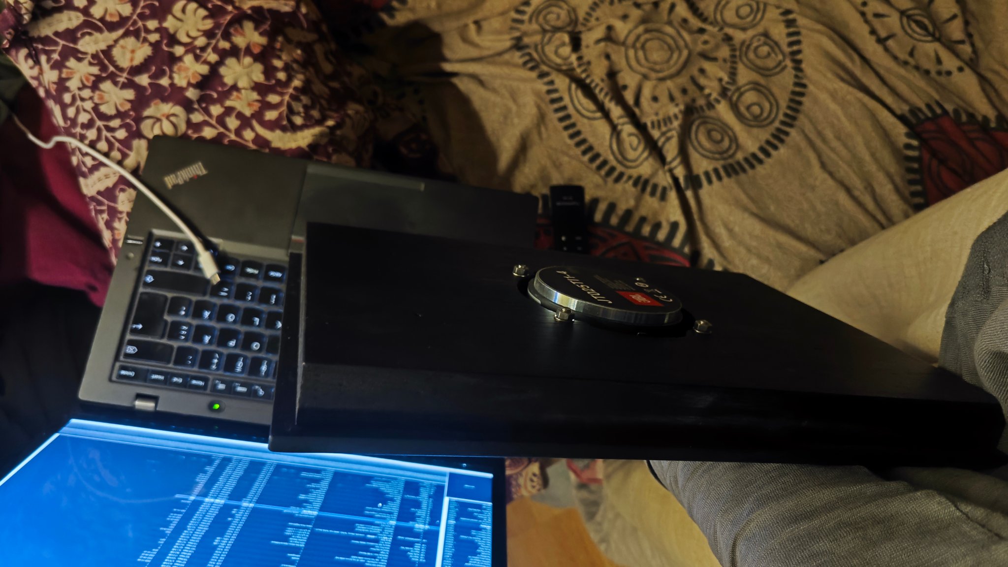

This is just an oak board. Millimeter or two too narrow but otherwise quite perfect. I attached the CNC file if anyone wants to repeat it.
To be able to experiment with more different crossovers and not have to drop a bank on the parts as well as simplify the design and have much easier way to get time alignment I decided to go with digital crossovers and got myself a Topping DM7. Still working on some DIY amps and I need to make cables but I have pretty much all the parts I need, so it's just a matter of time now.
I will probably be using REW software, since it's freeware and I have Umik. I also have Equalizer EPO for global EQ on Windows.

.dwg file doesn't seem to attach, but here are a few pics
I'll post the speakers perhaps when I have better lighting to capture them

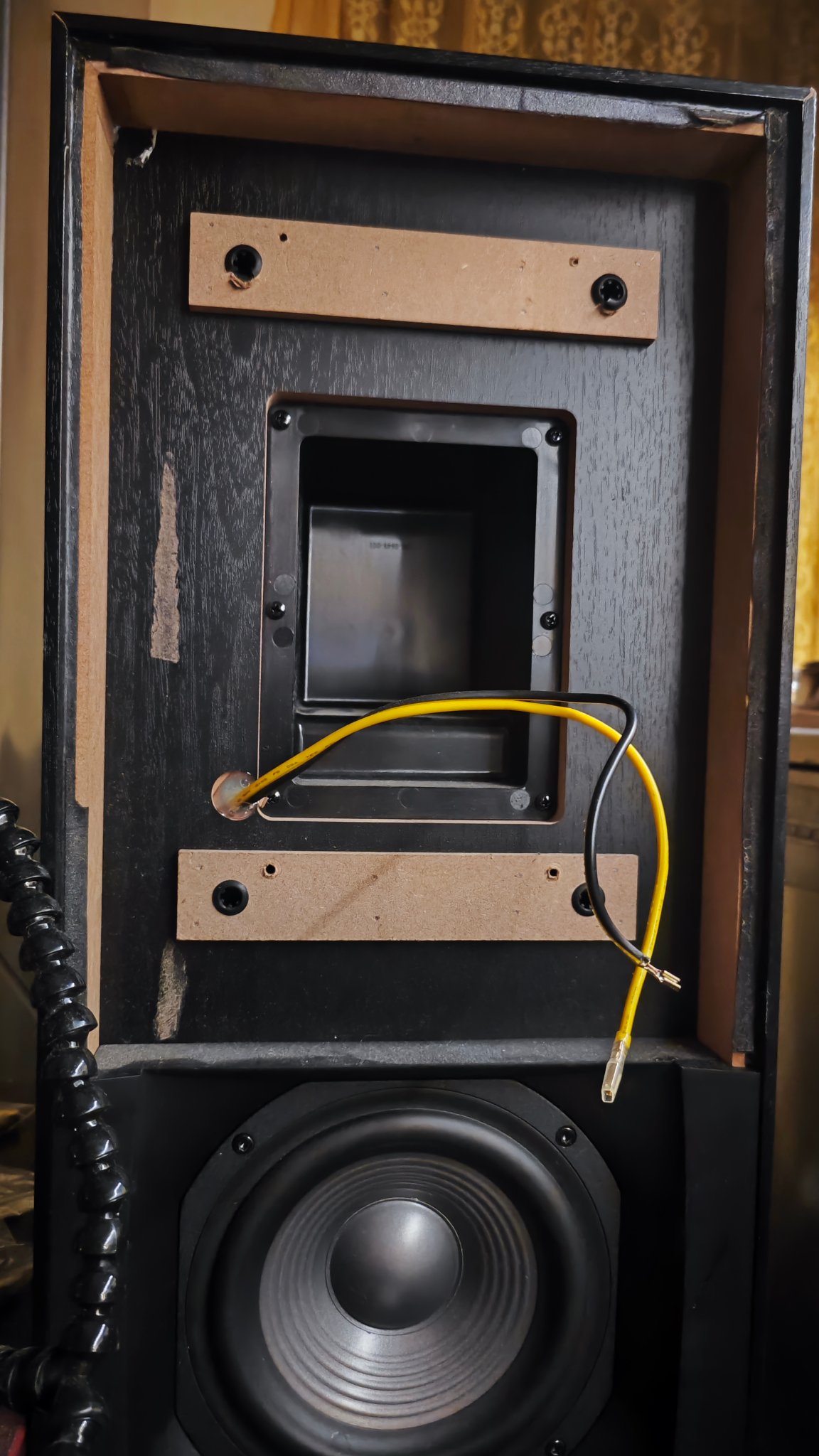

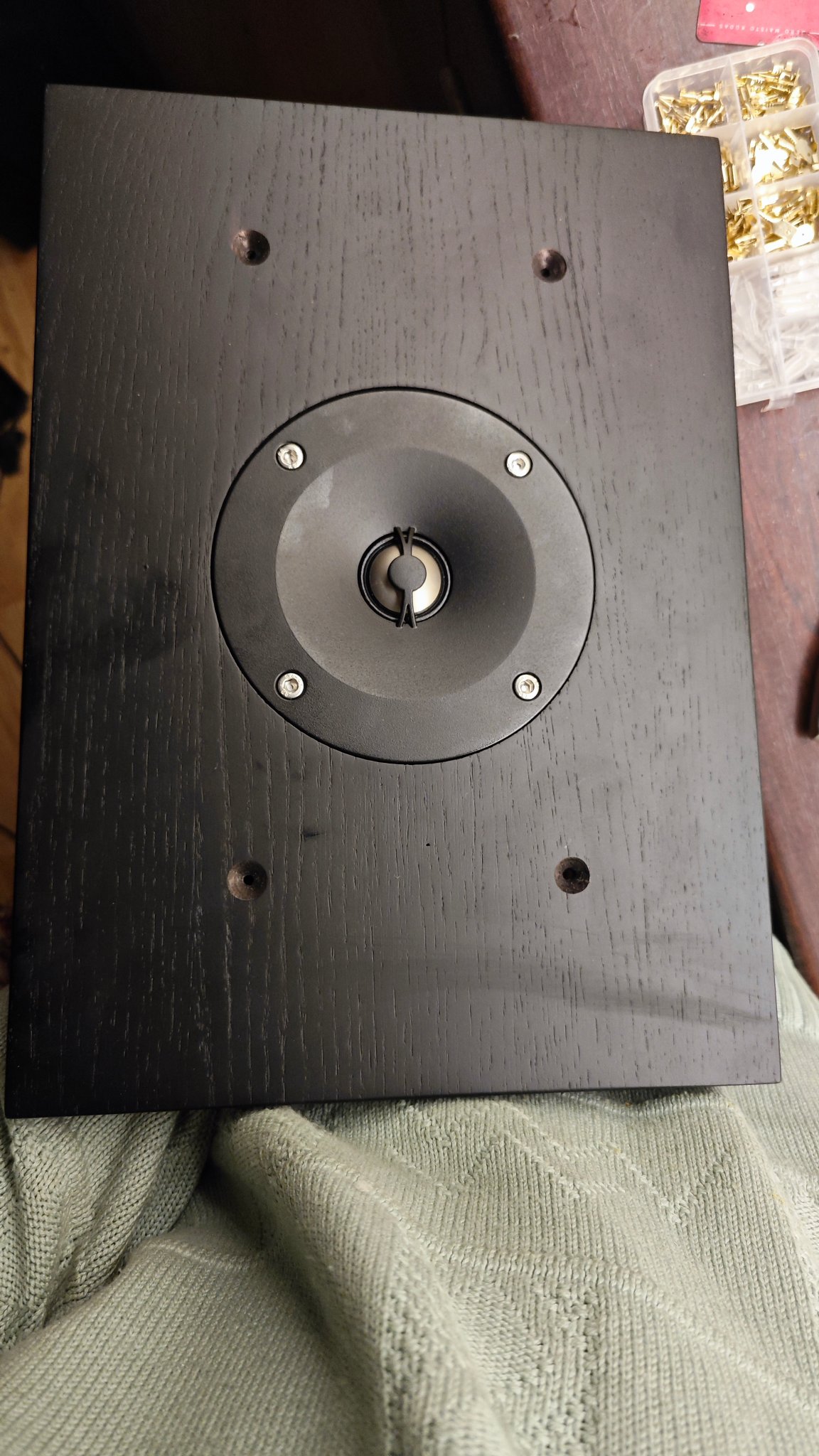

Another perspective. The overall width is about 1.5mm to 2mm too narrow, otherwise turned out quite perfect. I am planning to replace the internal wiring.
This tweeter is on a completely different level relative to the original compression driver. It also goes pretty low comfortably.
