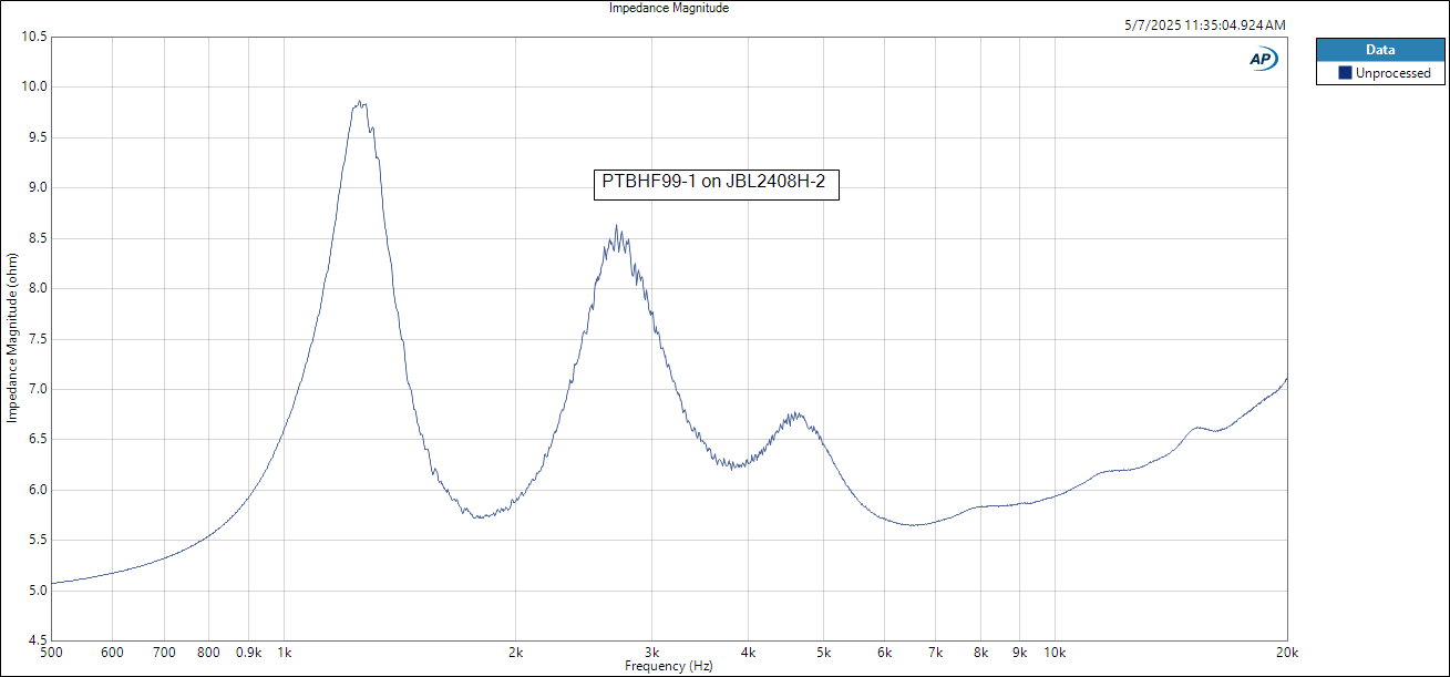

Hello,

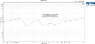

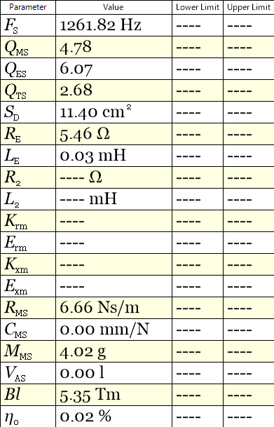

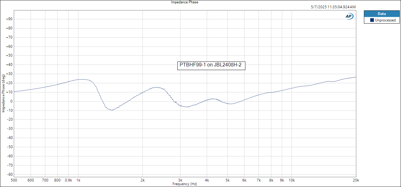

Using the AP tools on my bench I measured the PTBHF99-1, JBL2408H-2. This is what I got for impedance, phase and TS/P. More measurements to follow.
I did not see any wild resonance stuff in the higher frequencies, good news. Sometimes there is breakup that shows up as high frequency resonance.
Note: these are raw data curves. The saw-tooth appearance happens with Compression Drivers and Waveguides/Horns. My suspicion is that some of the output bonces around on the hard surfaces on the longer reflected path out of the waveguide.
Impedance Magnitude PTBHF99-1 on JBL2408H-2.PNGImpedance Phase  PTBHF99-1 on JBL2408H-2.PNGThiele-Small PTBHF99-1 on JBL2408H-2.png

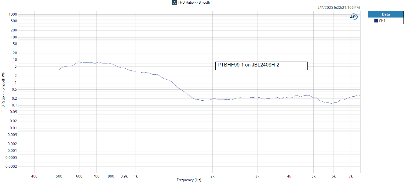

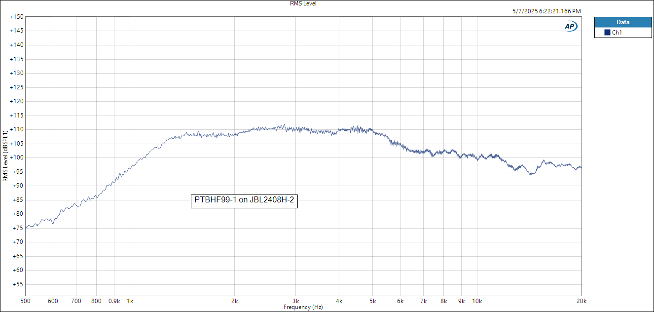

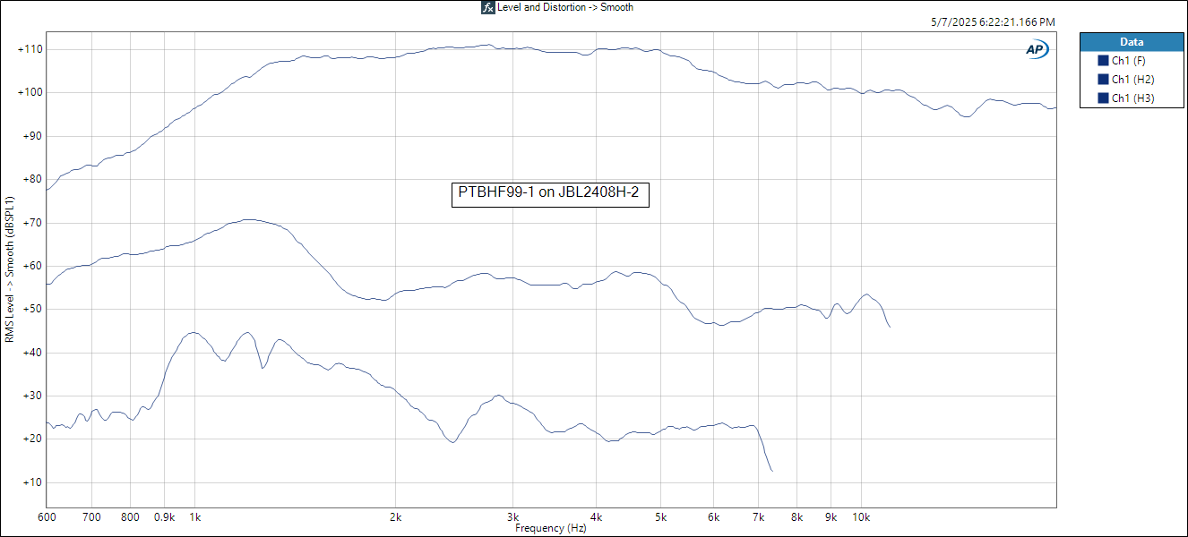

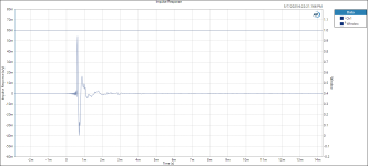

See the attached PTBHF99-1 on JBL2408H-2 plots, typical waveguide/horn roll-off that will require some EQ plus some padding.
If I recall the input voltage was0.5 volts The microphone was ~ 5 inches from the plane of the waveguide flange.
loud output.
low distortion.
Perhaps crossover at 2.5kHz or higher.
Thanks DT
Impulse Response  PTBHF99-1 on JBL2408H-2.pngLevel and Distortion -_ Smooth  PTBHF99-1 on JBL2408H-2.PNG
RMS Level  PTBHF99-1 on JBL2408H-2.PNGTHD Ratio -_ Smooth  PTBHF99-1 on JBL2408H-2.PNG

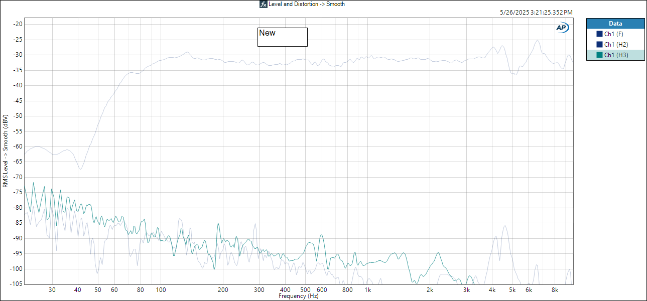

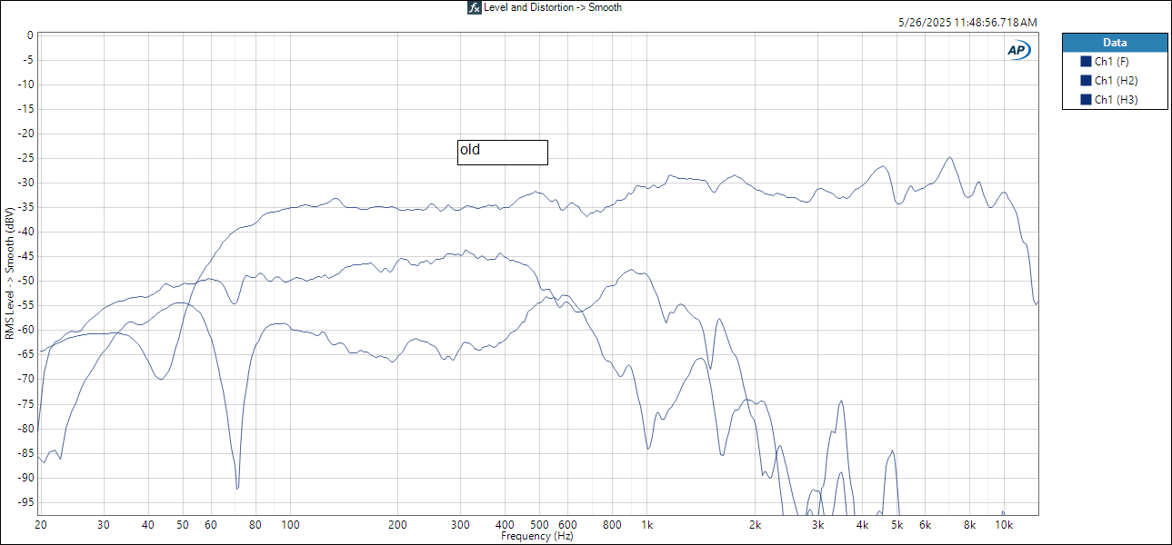

Back to that pair of JBL AC16 speakers that I purchased. One of the pair had a rumbling grumbling coming from the low end of the frequency bandwidth I bought a new JBL 226J driver from the usual JBL sources.
I took the driver out of the enclosure and ran a separate pair of speaker wires in through one of the reflex ports bypassing the crossover network.
I ran some frequency and distortion sweeps of both the old damaged driver and the new replacement driver
Plus with the APx500 software I made wave files of both the damager driver and the new driver.
You know all that contention about A X B testing needing to double blind to be valid take a listen to the attached audio files. The test sweeps and applied 1 volt applied to the drivers was automated and identical.
Thoughts?
The wave files will not post here on diyAUDIO, ideas on how to post audio files? They are short only 10 seconds each.
See attachments:
Level and Distortion -_ Smooth old.PNG Level and Distortion -_ Smooth new.PNG

Hello All,
Thoughts?
See attachments:
View attachment 1466050 View attachment 1466052
Hello,
Okay
I have Zipped the two .WAV audio files of the old broken JBL 226J woofer and the new JBL 226J woofer.
You can hear the painful difference between them.
Tell us what you can hear.
DT
