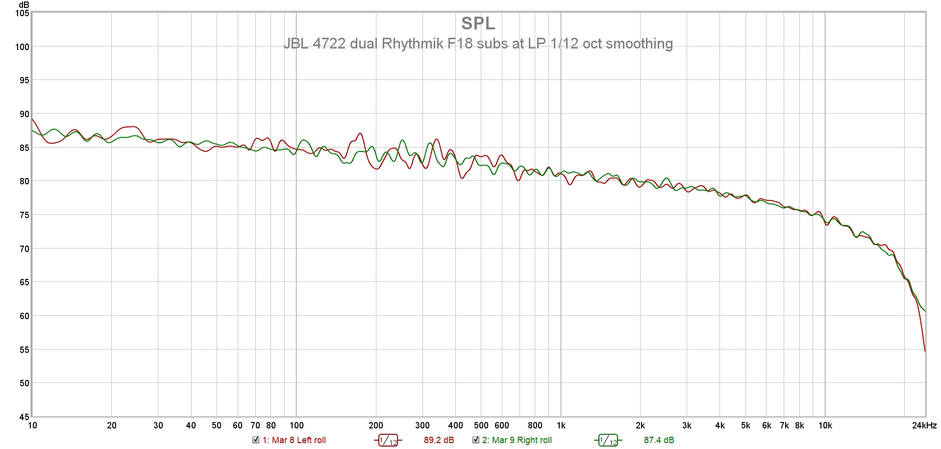

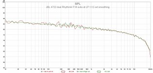

Hello DT, thanks. Yes, I use a software DSP package to smooth out the frequency response. It also provides linear phase digital XO, time alignment and excess phase correction capabilities.
Full range response of my system ~10ft at the LP:
attachment.php
I can make adjustments to the target fr response or other parameters (including timing), generate the FIR correction filter and be A/B'ing music in near real time in a couple of minutes.

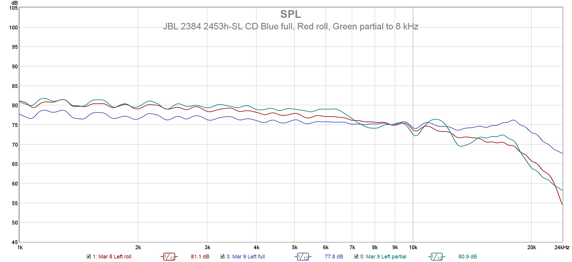

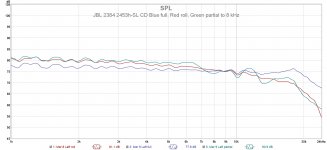

Below, Red trace is the same as the response above, but zoomed in a bit from 1 kHz. The target design follows the natural fr rolloff of the 2453h-SL CD. The Green trace is the same target as Red, but partial correction to 8 kHz and then let the horn and CD do its thing. The Blue trace is a straight line target correction from 20 Hz to -10 dB at 20 kHz:
attachment.php
Same 1/12 oct smoothing. Listening to music while switching back and forth from the three responses with a 3/4 second switching delay (linear phase FIR filter with 65,536 taps). The correction following the natural roll off of the CD sounds best (Red).
DT, I am looking forward to hearing your adventures with the M2 waveguide as that to me seems to be better waveguide than the 2384. I would welcome a wider pattern. But I don't know how low it will go...? Are you going to use a 4" or 3" diaphragm?

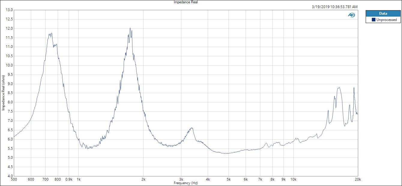

Hello All,

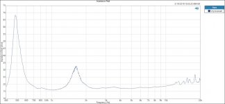

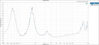

We went into Sparky’s Lab (Sparky is the cat) this morning.
We connected a JBL 2432H to the PT 1010HF-1 and then a JBL 2451J to the same waveguide. Later we will do frequency response. First off we did impedance plots.
The large peaks at 1.75KHz ish surprised me. This happened with both CD’s on the same waveguide. Looks like wave guide loading to me. This 100 X 100 waveguide is looking less magical to me. Seems to me that you can tell a lot about how a horn / waveguide loads by looking at the impedance plot.
Frequency Response plots to follow.
Thanks DT

Actually, i think it looks real good.
Check out the jbl 2380a Z plot, it has a few impedence bumps past 1khz.
I bet in many straight path (straight then small corner, then straight again) cd horns (ev hr90, hp640), every break in horn path would cause a Z spike.
I bet the older pth has a blip near 10khz.
Magical ?
Minimal reflections make for a more accurate (hear into the details) sound.
I bet it is a very very good horn.
I expect the horn + freq response plot to be similar to plane wave response.
Without narrowing the response as you go past 3khz, you won't get free hf boost, that is actually lost off axis just to get more on axis.
Thanks for all your work on this.
Norman

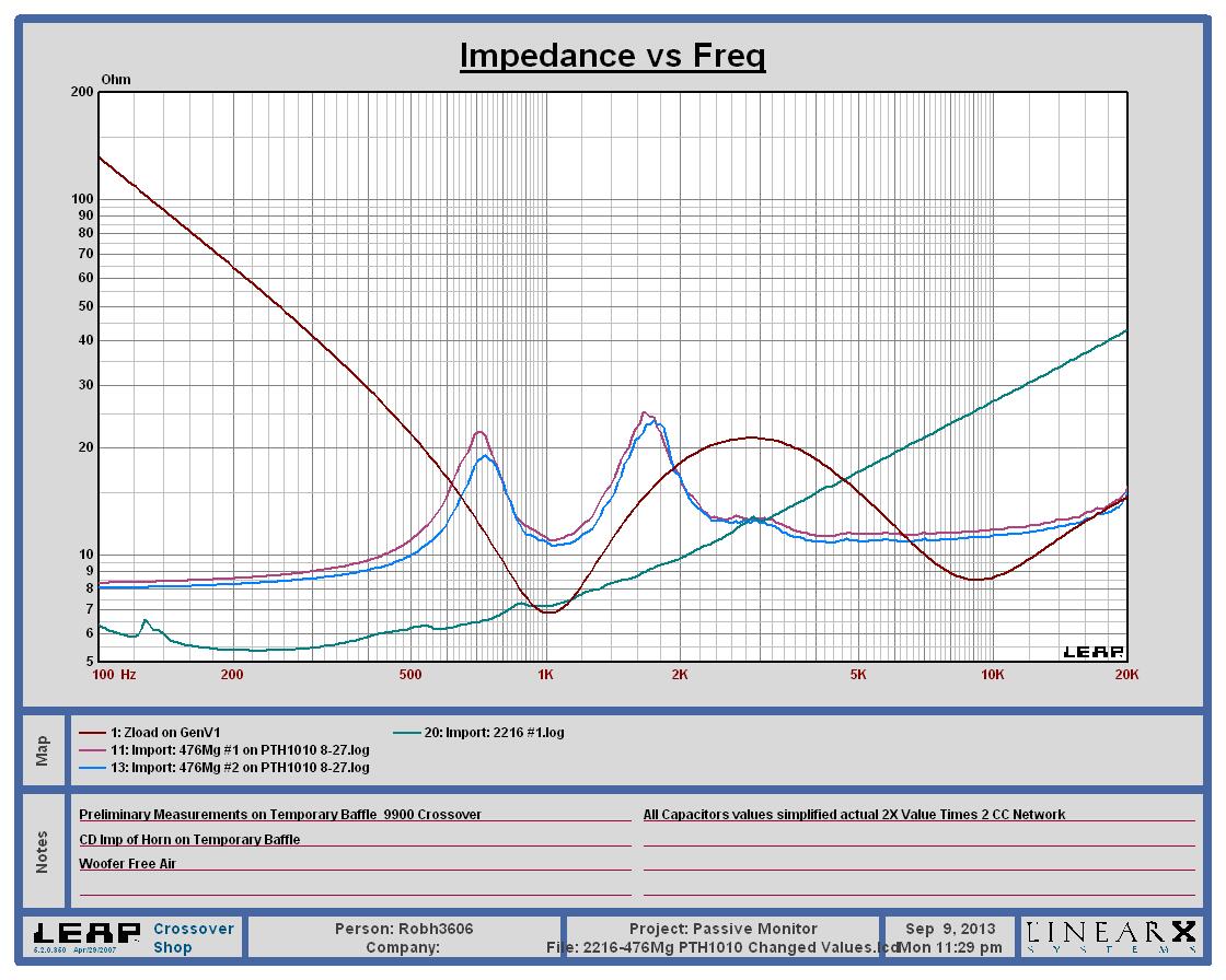

Wait until you do the FR measurements. I have the older version of the waveguide and it loads the bottom end quite well especially with a 4" driver. I am really curious how the 2 compare. Looking forward to seeing what you get
Rob🙂

That's not the waveguide it's the compression drivers they are both in break-up modes above 10K. Here is a 476 on the older waveguide and it's clean up there.
The more important concern of interest to me is if the 2431/35 or the 2432H have problems on certain horns, and if so, which ones? The comments made by JBL transducer Engineer Doug Button regarding the short throats on 2431/35 drivers and some horns keeps echoing in my head... but he didn't elaborate on which horns in that discussion."
It's the short phase plug that makes them hit or miss. You would get a notch in the response. The 2435 works well on the older PTH1010. We wrestled with this a lot on LH and it really was hit or miss I don't think we ever really built a list of "good' horns/waveguides.
Rob🙂

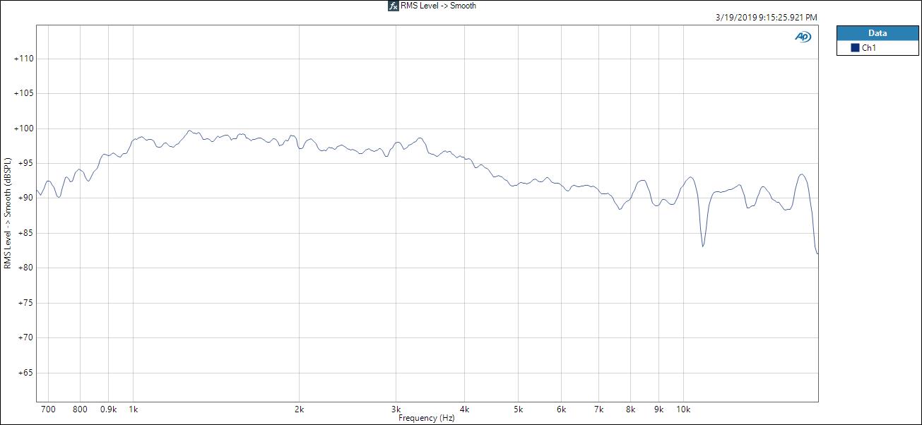

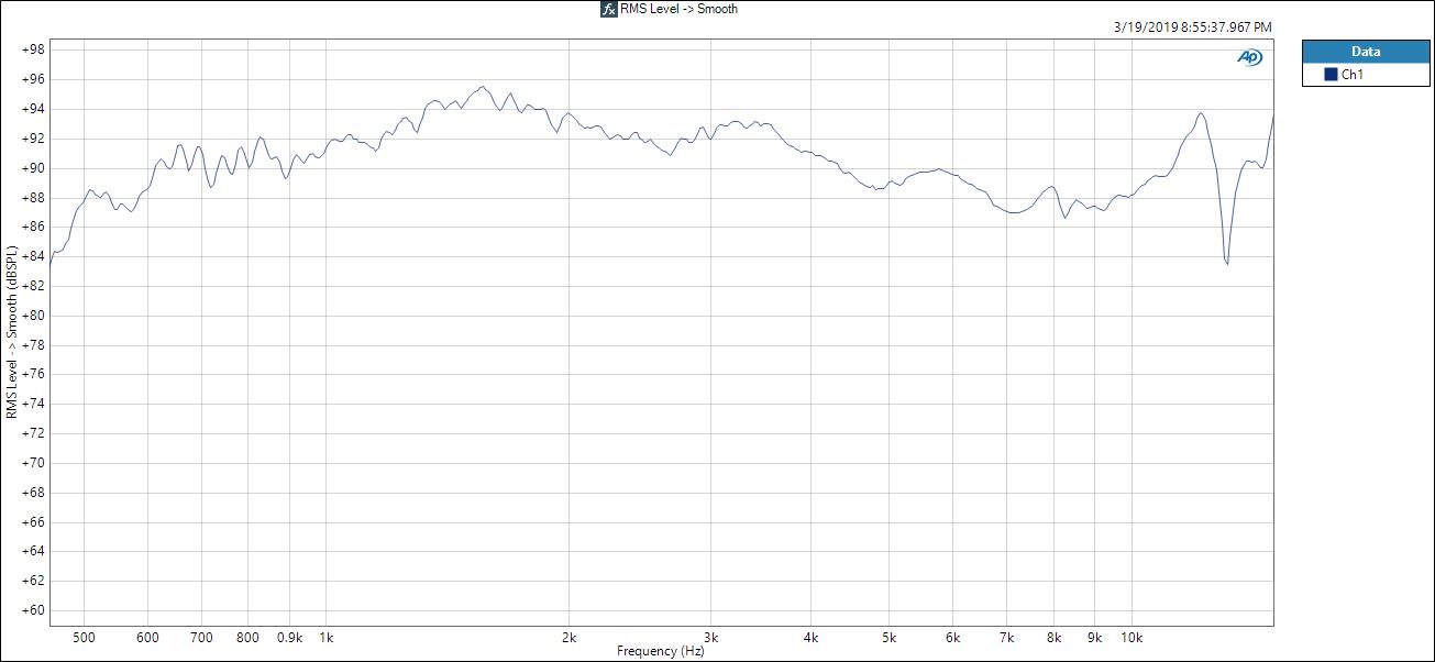

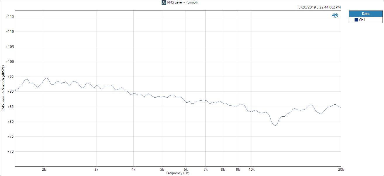

Hello,
I still have some bugs to work out but I am operational.
I did not go outside or into a large room, not a standard distance between mic and driver so not calibrated.
With 1/24 octave smoothing here are the RMS frequency plots for the PTH1010 HF-1 with the JBL2451J and JBL 2432H Compression Drivers.
Thanks DT

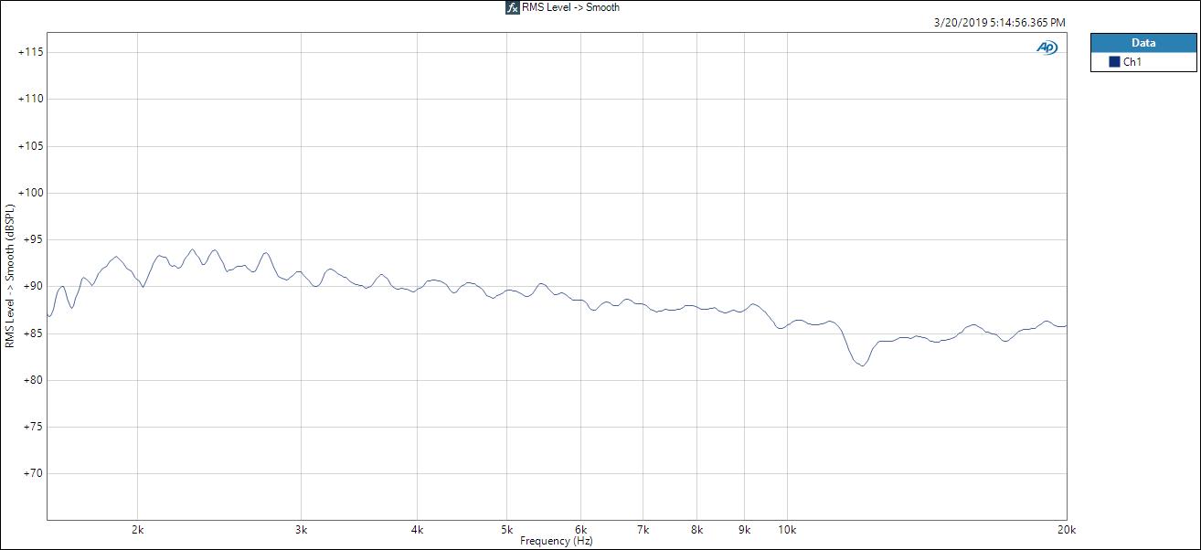

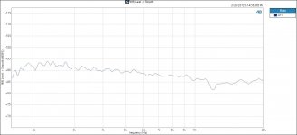

Hello,
A couple more plots before Sparky and I leave Sparky’s Lab for a couple of weeks.
Still using the microphone for frequency response plots, not using JBL parts. This time it is a FatialPro HF 111 CD and a FatialPro Short throw 1 inch horn and a Eighteen sound 80 X 60 elliptical horn. The plots are first the FatialPro short horn and second the Eighteen sound horn.
This FatialPro HF 111 CD is the smoothest fregquncy response tested so far. Both plots are with 1/24 octave smoothing.
Thanks DT

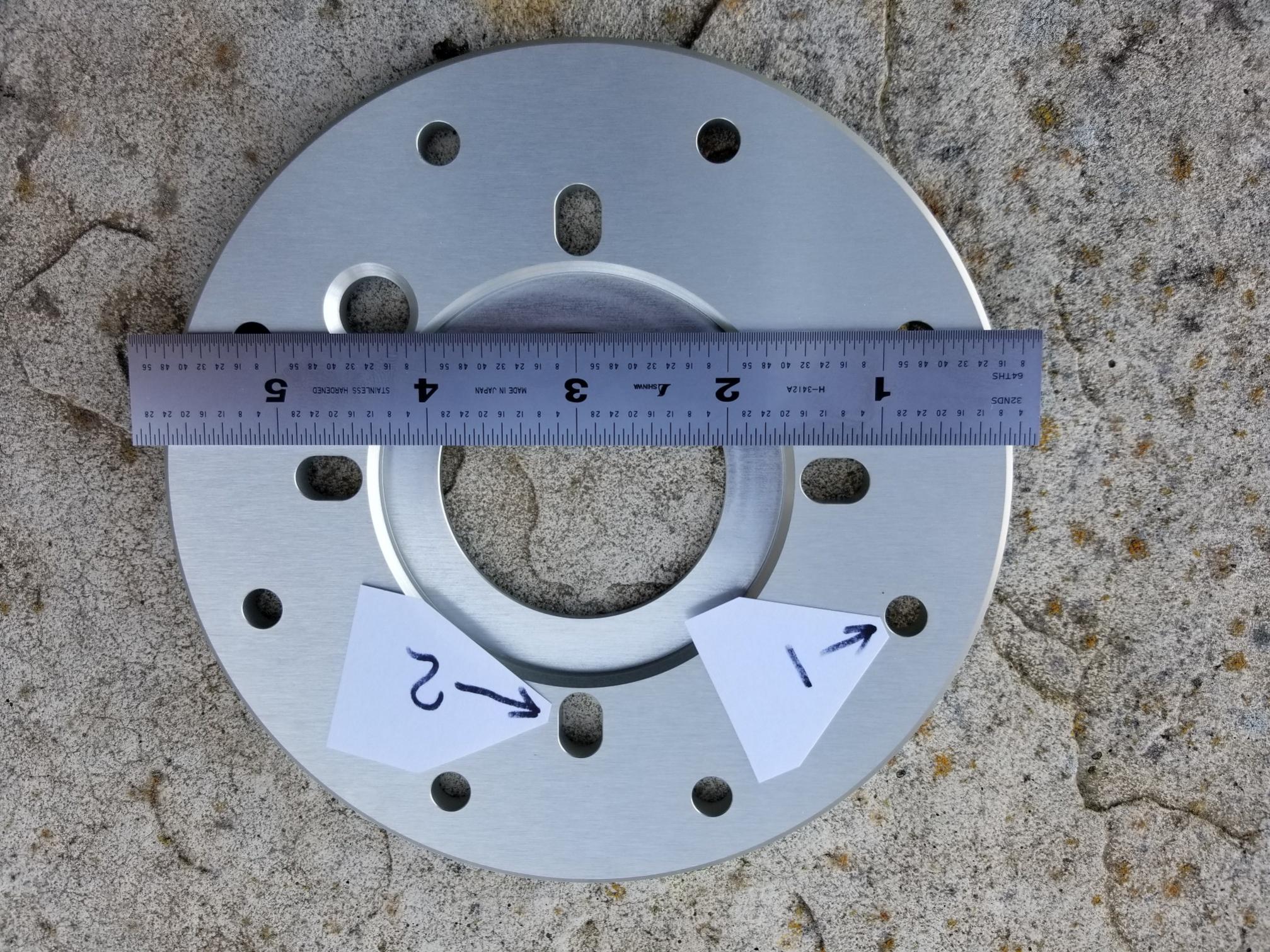

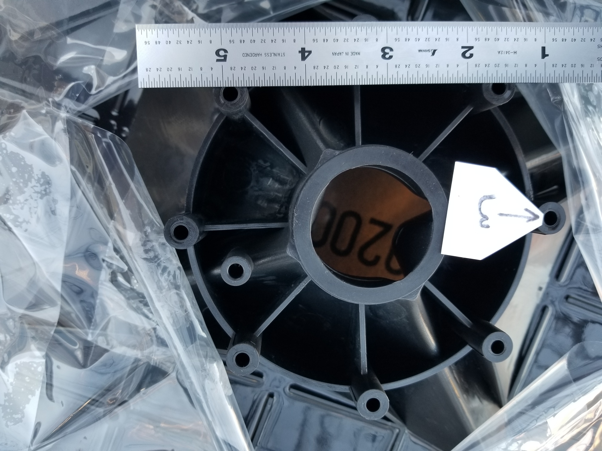

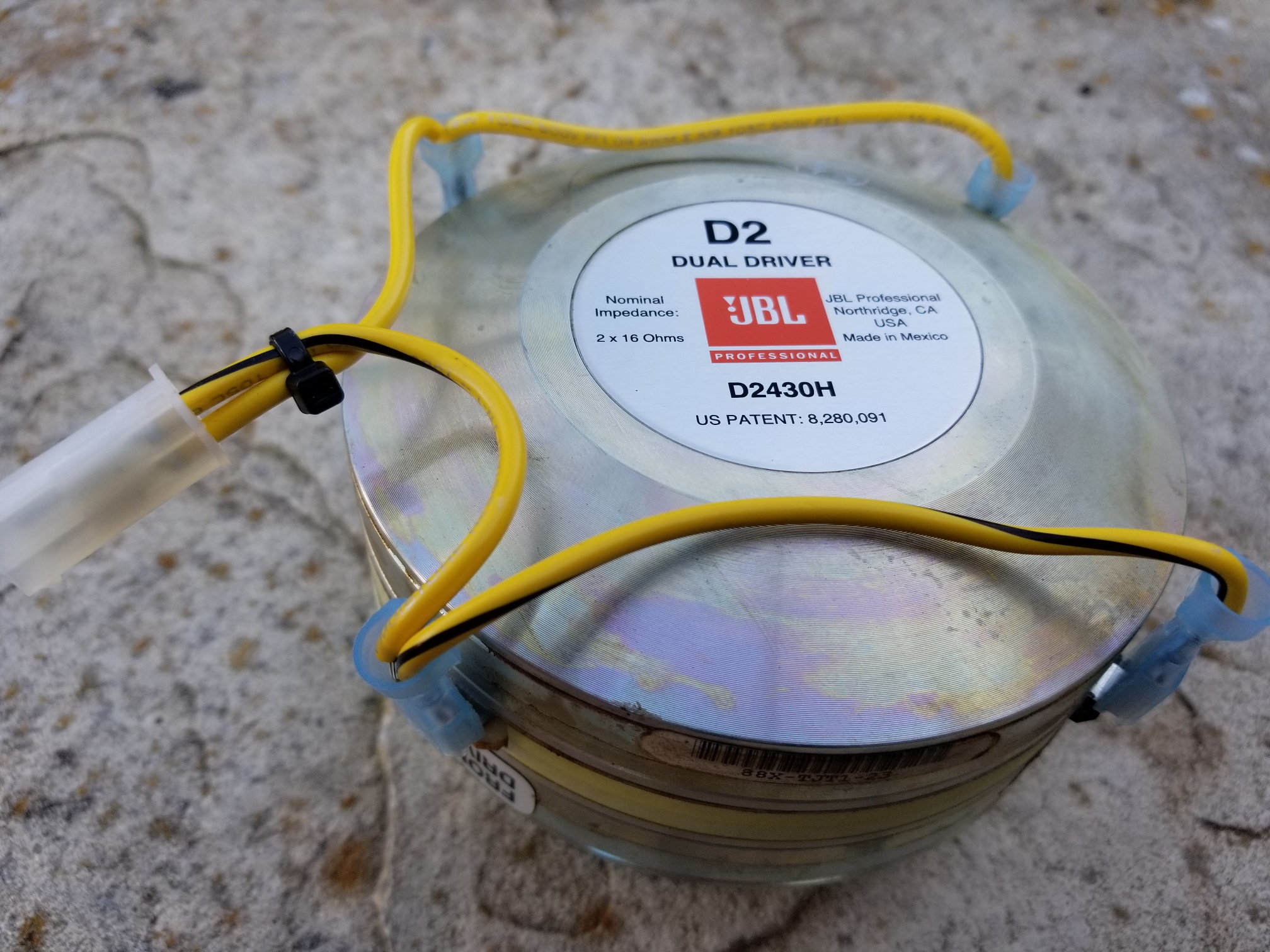

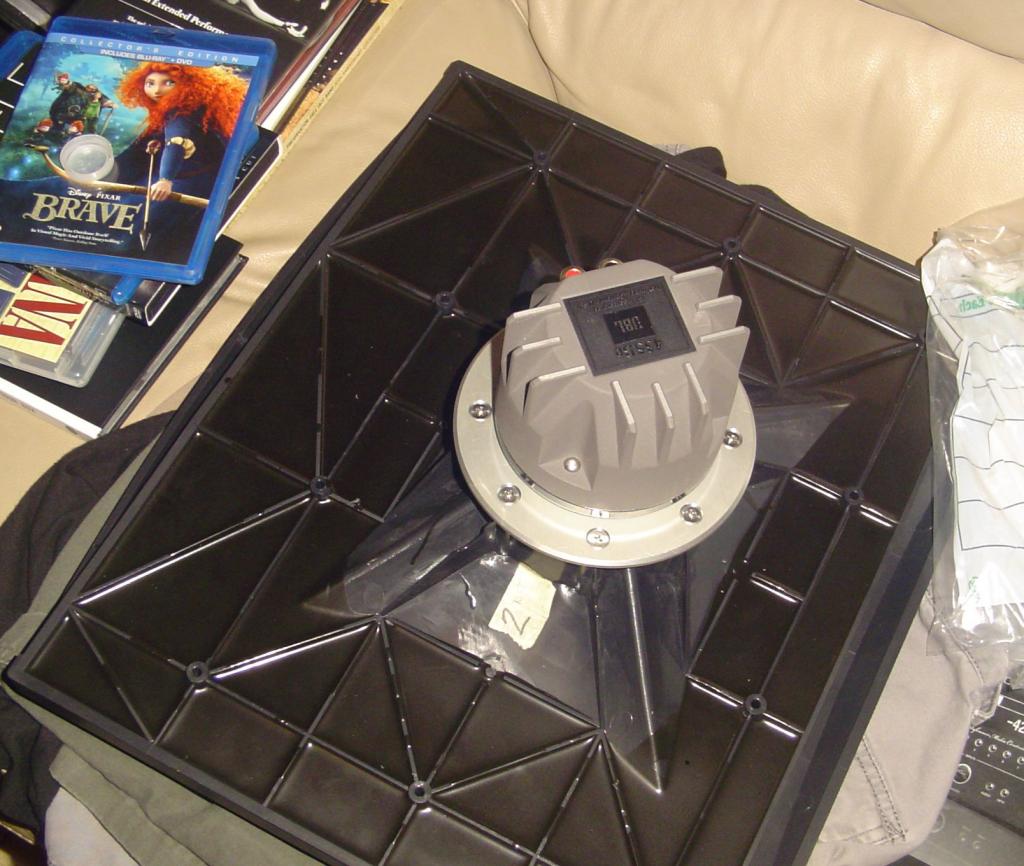

Hello All,
More 100 X 100 waveguide and driver stuff today. Today I received the D2 drivers and M2 waveguides.
I have a couple of questions if you all can help. These D2 drivers do not attach to the M2 waveguides in the traditional way. There is an adaptor flange that is installed between the waveguide and the driver.
See the attached photos:
The driver attaches to the flange with 4 each ¼ - 20 threaded bolts. See the slotted holes tagged #2 in photos.
The flange then attaches to the waveguide with 8 “screws” that install through holes tagged with #1 and fasten into the plastic holes in the waveguide tagged # 3 in the photos.
Anyone been there done this with the 8 screws before. Plastic thread forming screws? What size? Anyone have a part number? I do not want to destroy this thing?
Thanks DT

Hello DT
I had the holes tapped and put in helicoils. You can do it yourself if you are comfortable doing it. It worked out well as you could repeatably remove the plate and not worry about loosing a mounting hole due to wear. I think they are 10/32 easy to see which one with screws in hand.
Rob🙂
