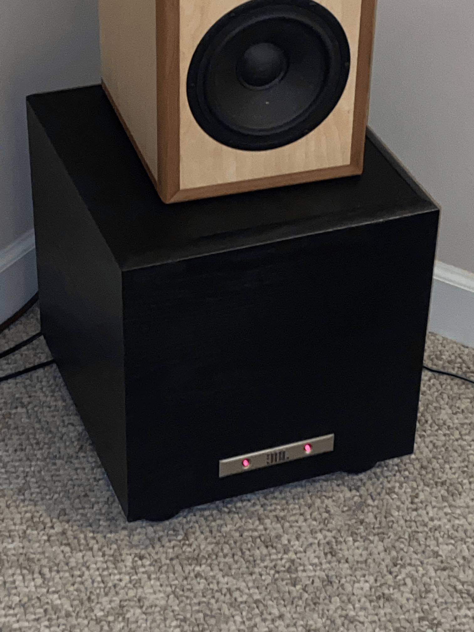

The HT sub started to act crazy, it would work ok for a couple of hours, but then the bass would eventually disappear.
I pulled the amp out and noticed a pair of caps were swollen, replaced them easily with the same value and it started working again.
That was encouraging but soon noticed the transformer was getting hot, very hot and this plate amp wasn't even back in the enclosure; which is a sealed plastic box inside the speaker box. I left it out on purpose just in case of something like this.
Not a lot of components on the plate amp, and they all look in good shape.
Since the plate amp is not in the box, I didn't reconnect the LEDs - Con3a1
Would hate throwing it away, any hope with this?
Thanks for looking!
