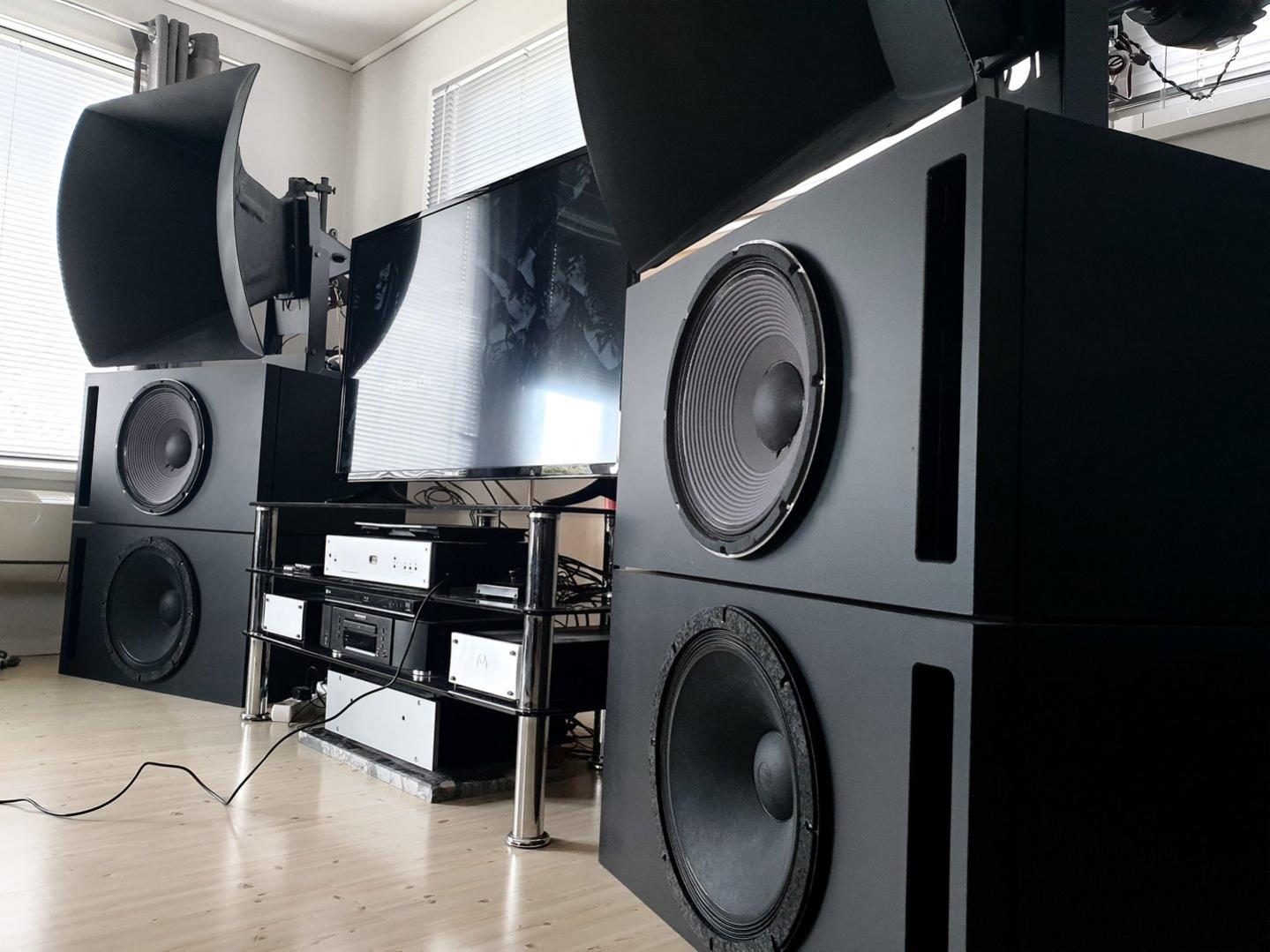

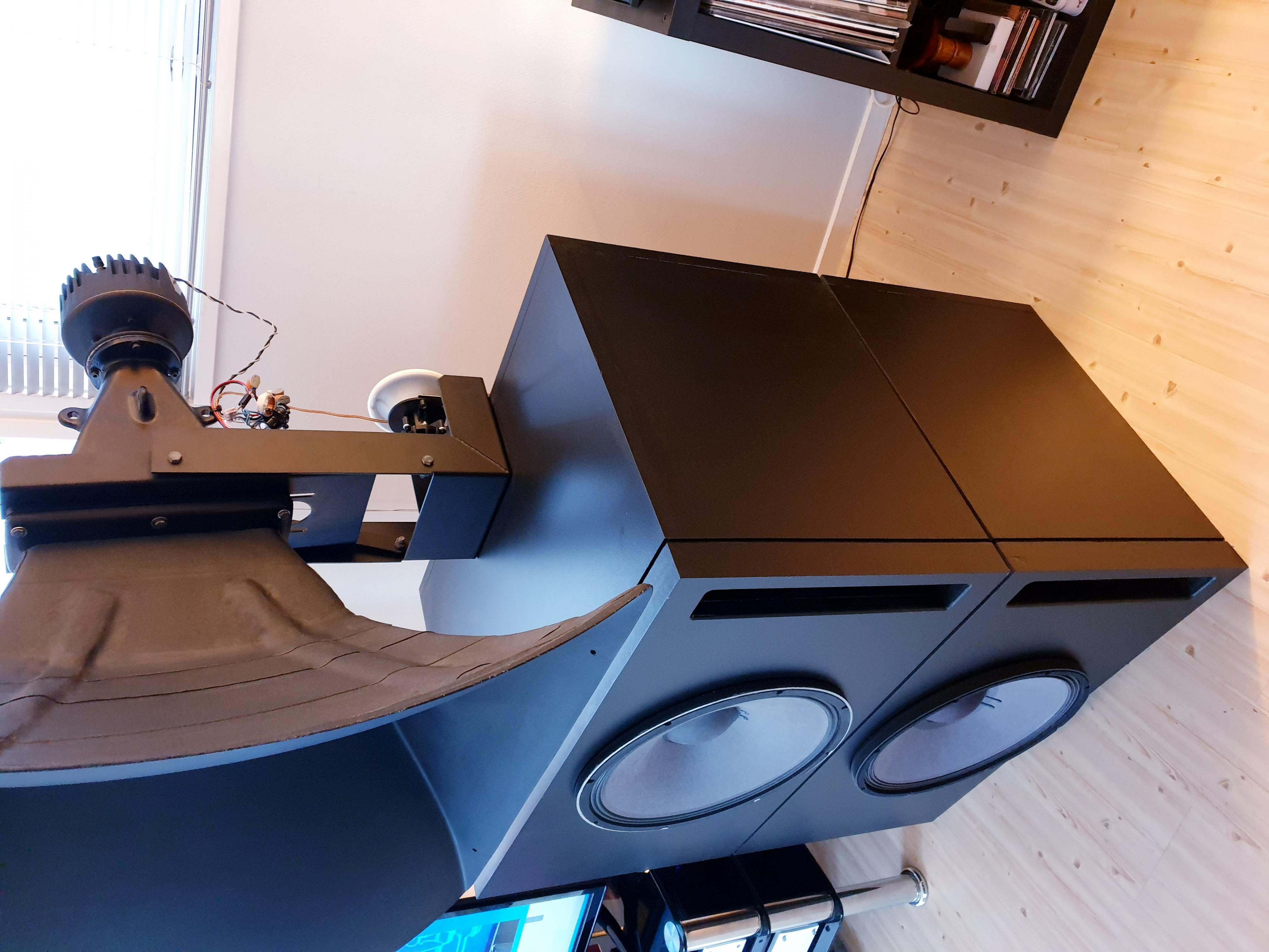

Two years and som changes later.... 🙂
TAD 4002 on the 2360`s.
JBL 2220 upper bass, JBL 2227 lower bass.
JBL 2405 playing backwards.
DEQX HDP3 as DSP.
Musical Innovation 2x15w class A amp for horn.
Midgard Oberon 4.1 for the bass.
Tweeter just added with the horn, with a 0,5uF capacitor in series.
22uF capacitor for protection on the TAD 4002.
DEQX HDP3 as DSP.
Because I wanted to test it.
Got a bit deeper bass.
The stack is lower so the horn is in more correct height.
Drawback: Can`t use passive filters, must have DSP as the JBL basses in these cabinets need EQ boost in the bass.

With 0,5uF cap 2405 start rolling of at about 9khz.
Can`t really say to much about it, maybe som ambience is added 🙂
Helping the 2360`s beaming over 10khz.
Edit: Tested now on same song with tweeters on and off, there is a little difference, more air in the top with tweeters.

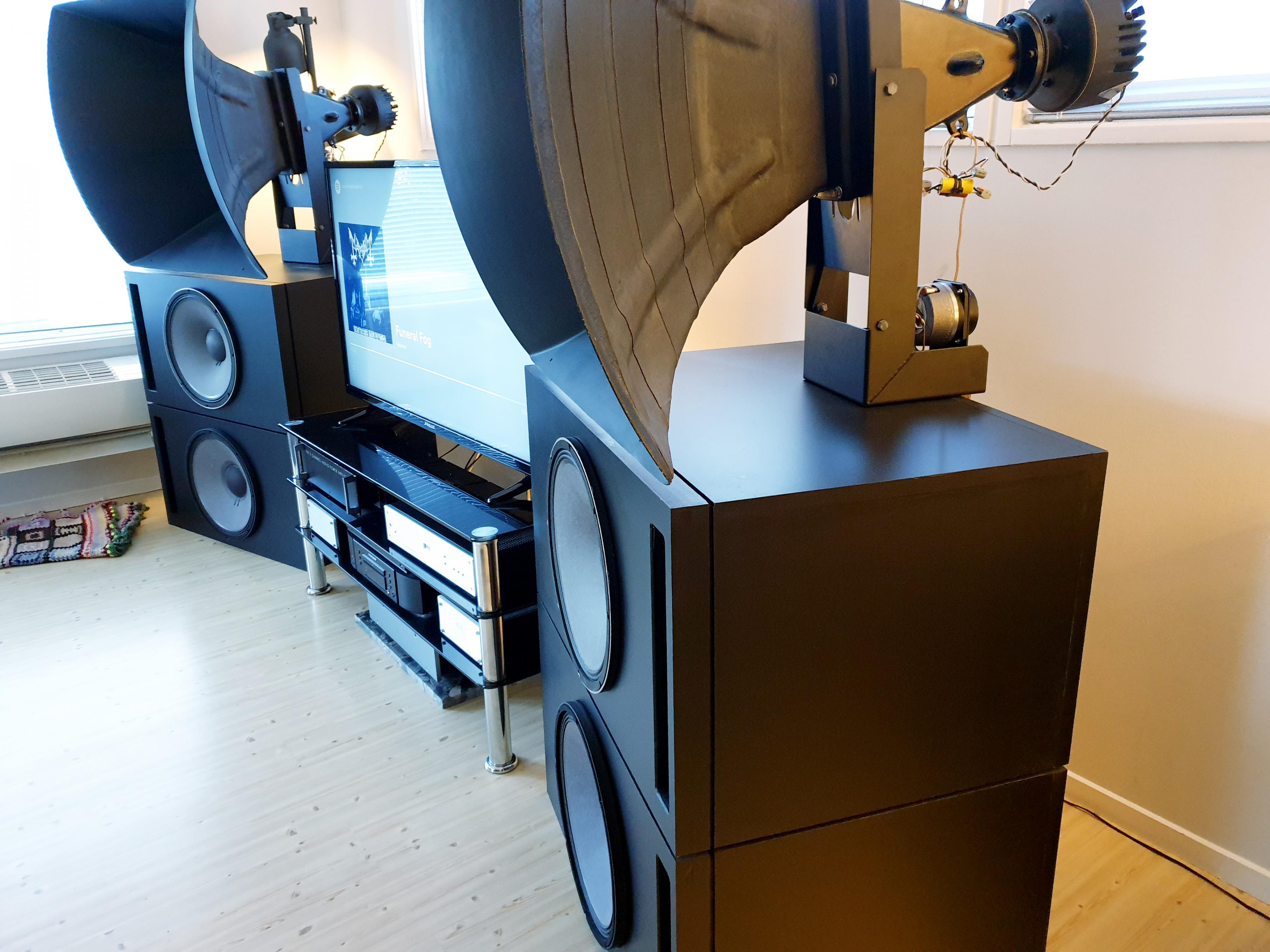

Why 2405 backwards? how good are the 2360's imaging? 2405 pointing forward should enhance imaging, how does it sound when backward and integrated with 2360?
Sorry for late reply!
The 2360 imaging is very good. The idea with 2405 backwards is as Ambient Tweeter.
Filling in the area >10k where the 2360 start beaming.
One of the 2405 diaphragms got broken 🙁 they are old.
So got a pair of JMLC 1400 and Celestion CDX1-1430 instead.
Also have worked with crossover in DEQX and got it down to 500hz between woofers and 2360.
