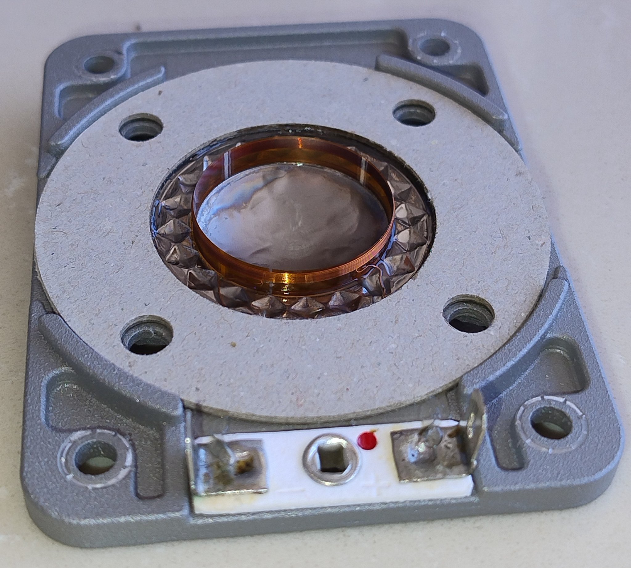

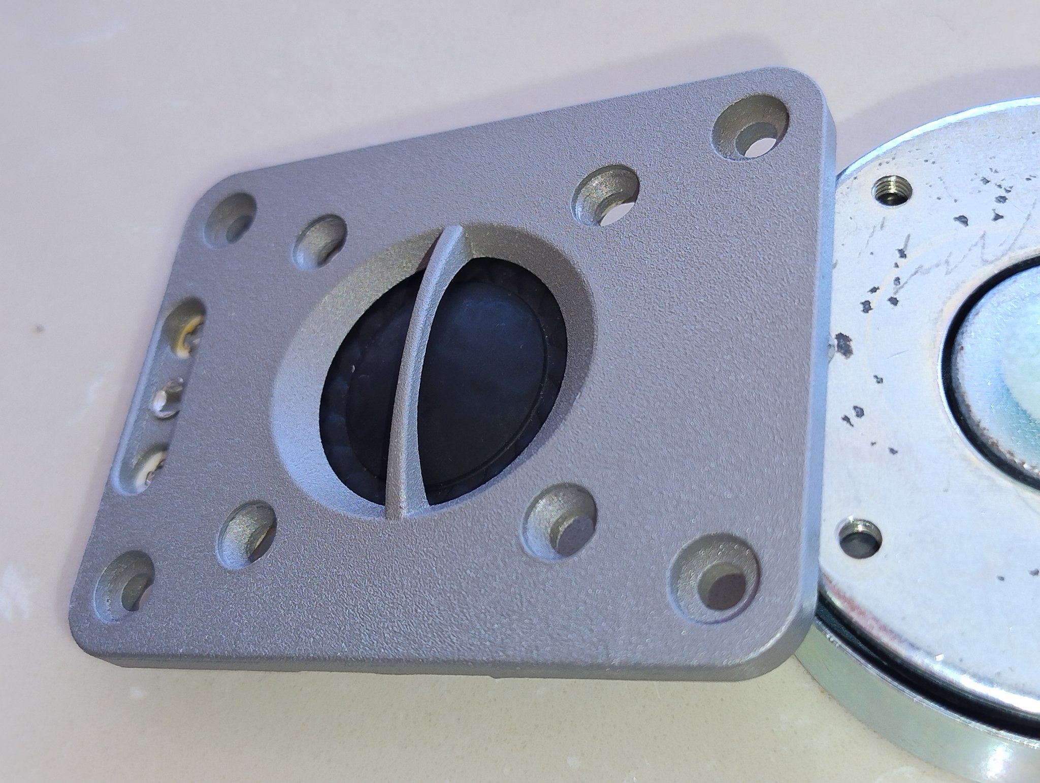

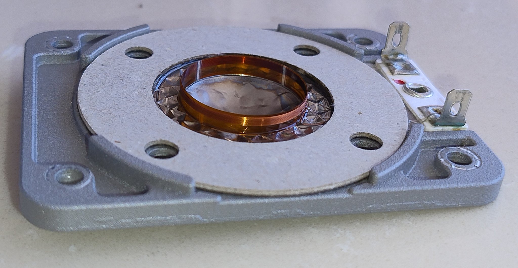

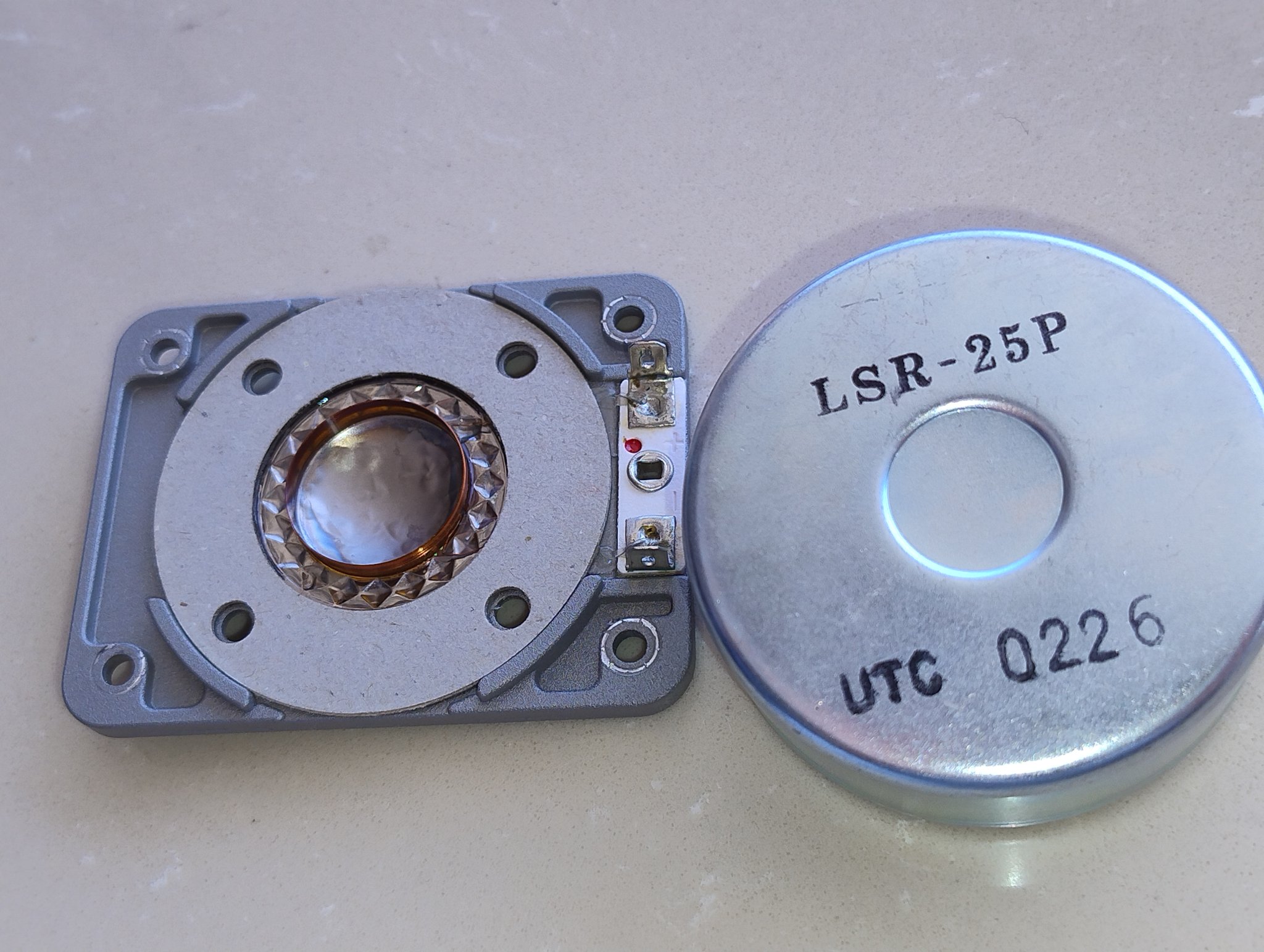

Okay, the woofers are working. I won't change them, it will be like this. I bought defective LSR25Ps. The tweeter dome is wrinkled. And the bare one is broken (no chain) in the tweeter head. Who knows where it's broken? I don't see overheating

I have this idea - the tweeters were damaged as a result of a surge of current from the amplifier when turning it on or off. Because the amplifier is connected directly. The thin coil wire. it could not stand it and burned out somewhere in a thinner place. This happens in Pro systems. The same will happen with the next ones. What to do about it? What do you say friends?
Hi Aleksei19731,
If the turn-on thump burned them out, the amplifier is defective and has serious problems. DC offset, no excuse.
Wiping out a tweeter is done by sending them too much energy. Or, the amplifier was oscillating (it has a serious problem). When using a passive crossover, burning out tweeters is a classic amplifier clipping issue. Not enough power.

By the way, I took it apart and looked inside. I don't see anything that really impressed me. simple woofer on a ferrite magnet, no "Differential Drive" system from JBL, A regular Tweeter on a ferrite magnet. With a regular titanium membrane covered with "Aquaplass". Modern compression drivers are installed - this is better.

Thanks for your answer. But the coil doesn't look like it overheated. And that's strange, because there's a break or burnout somewhere.
The magnetic gap doesn't care what kind of magnet generates the field. Not one bit.
Most of what can be seen from the outside of any speaker may look similar. The magic is in materials, and magnetic circuit design, plus voice coil.
What "sounds better" may or may not be better. If you like it - great. For a tweeter, resonant frequency and Q matter, as do resonances and sensitivity. Just to name a couple factors. The crossover frequency may r may not be compatible, plus any frequency correcting networks. A woofer to a capacitor - tweeter (with or without a pad) isn't great
If amplifiers are working properly, switching on and off will not burn the tweeters! Check the amolifiers first, but you anyhow must replace burned tweeter diaphgrams.
No, if amplifiers are working properly.

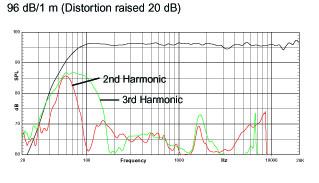

JBL LSR 25P performance will impress anyone:

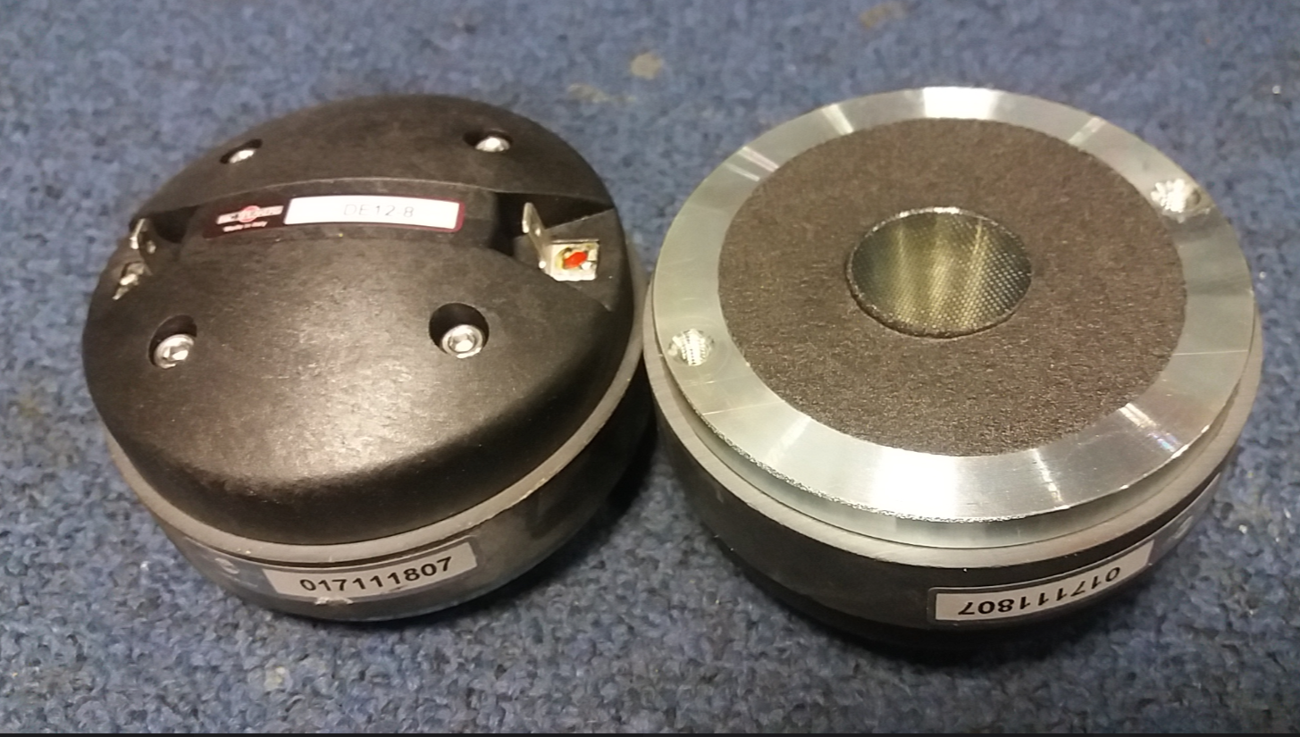

No. Frequency response of any active monitor is carefully tailored to the original drivers. You can't replace original tweeter with any other tweeter - frequency response will be ruined.

Since you cannot find the original recone kits or replacement tweeters your options are limited to a couple things. Either find something close, and probably modify EQ and crossover points. Or, abandon the project since the required parts cannot be found. You can wait until a pair shows up. It's up to you.
