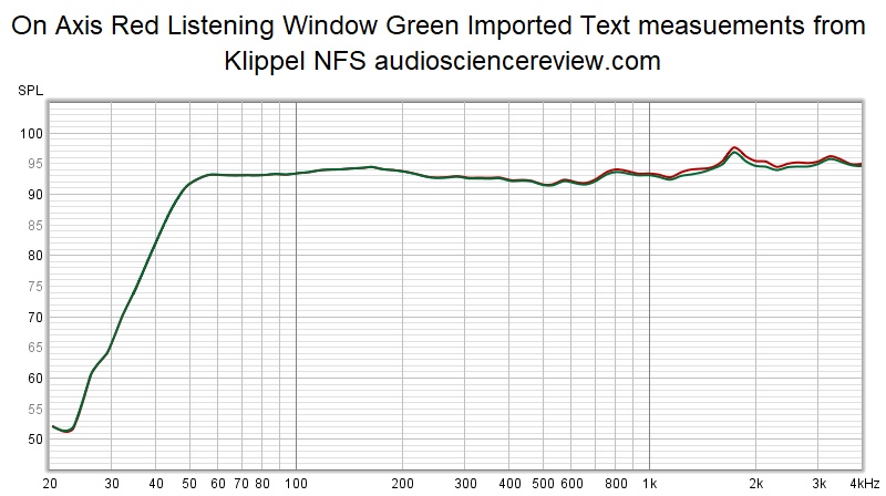

There was one for the JBL LSR 305P MKii speakers and I happen to have a pair so I downloaded the measurements to have a look. After a bit of fiddling I got the On Axis and Listening Window responses into REW. They are very similar with a little bit of a rise in high frequencies for the on axis response.

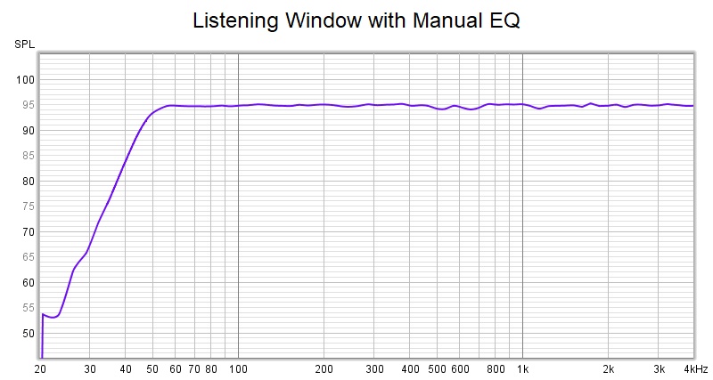

I used manual EQ to flatten the curve as much as I could without micro managing it too much, the result was much flatter.

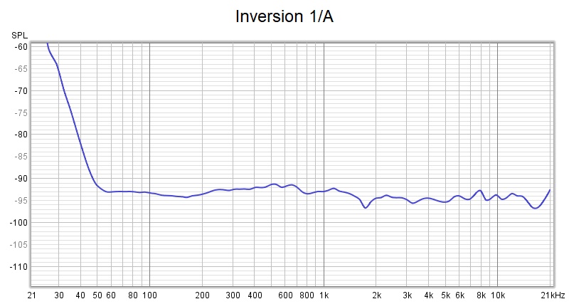

I used REW to invert the Listening Window response using 1/A in Trace Arithmetic. This isn't very usable as it is with the huge boost to flatten the low rolloff.

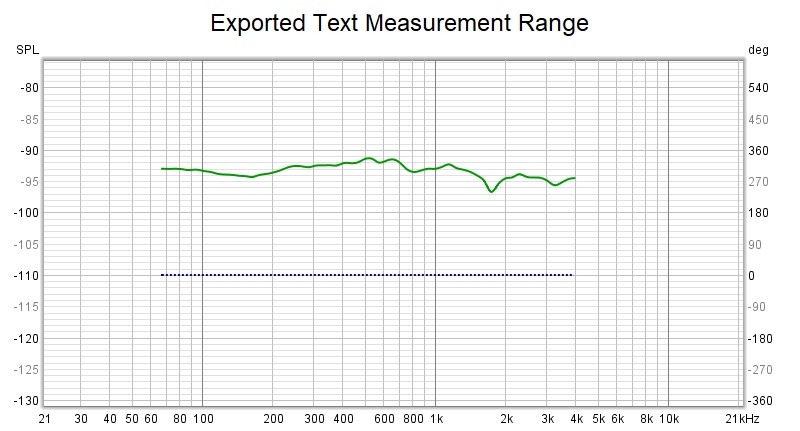

There is a way to use DRC_FIR to apply a target response to a dirac pulse so you end up with an impulse from a text file. I exported the measurement as text and only used the portion between 67Hz and 4K to avoid the excess boost and not correct above 4K as apparently the measurement is not valid over that point due to an error in the operation of the Klippel, this speaker was the first test measurement.

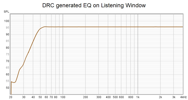

A couple of edits to the text file to make it work with DRC and this is the filter that came out. It corrects the measurement to flat between 67Hz and 4K very nicely.

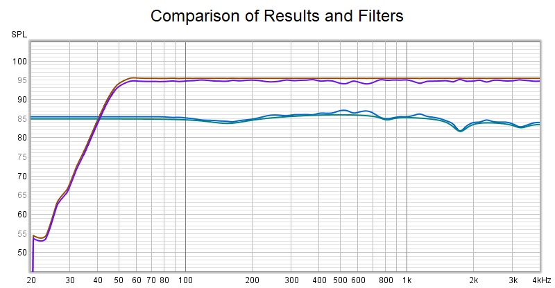

Here is a comparison of the basic REW PEQ and the DRC filter. My manual filter is very similar to the inversion so I'm happy I did a good job there.
