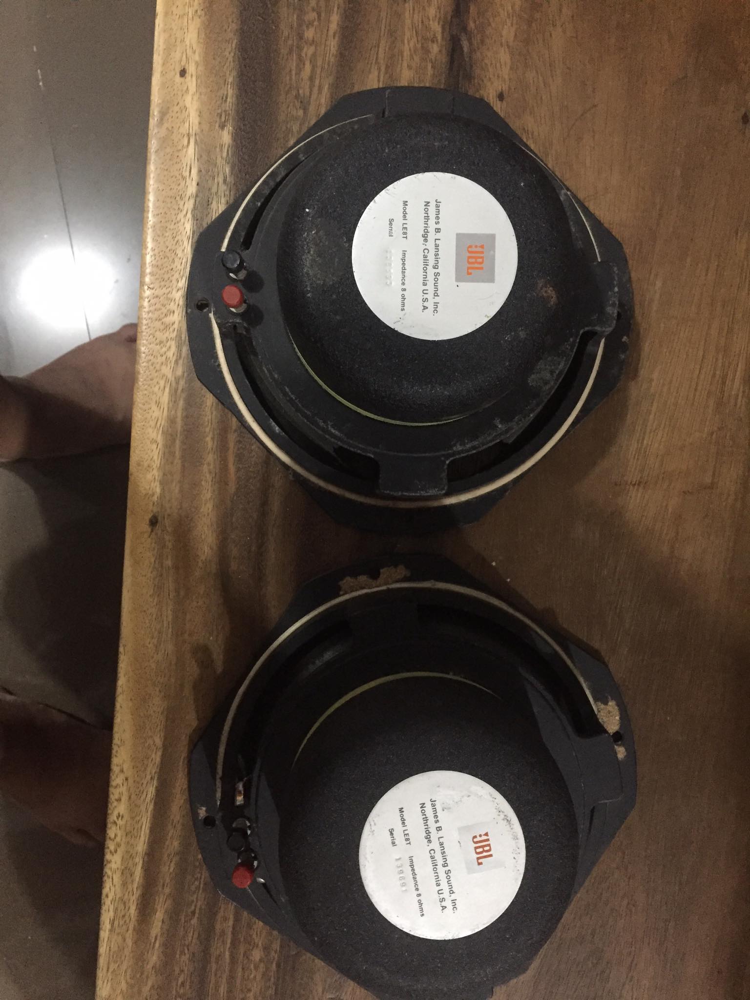

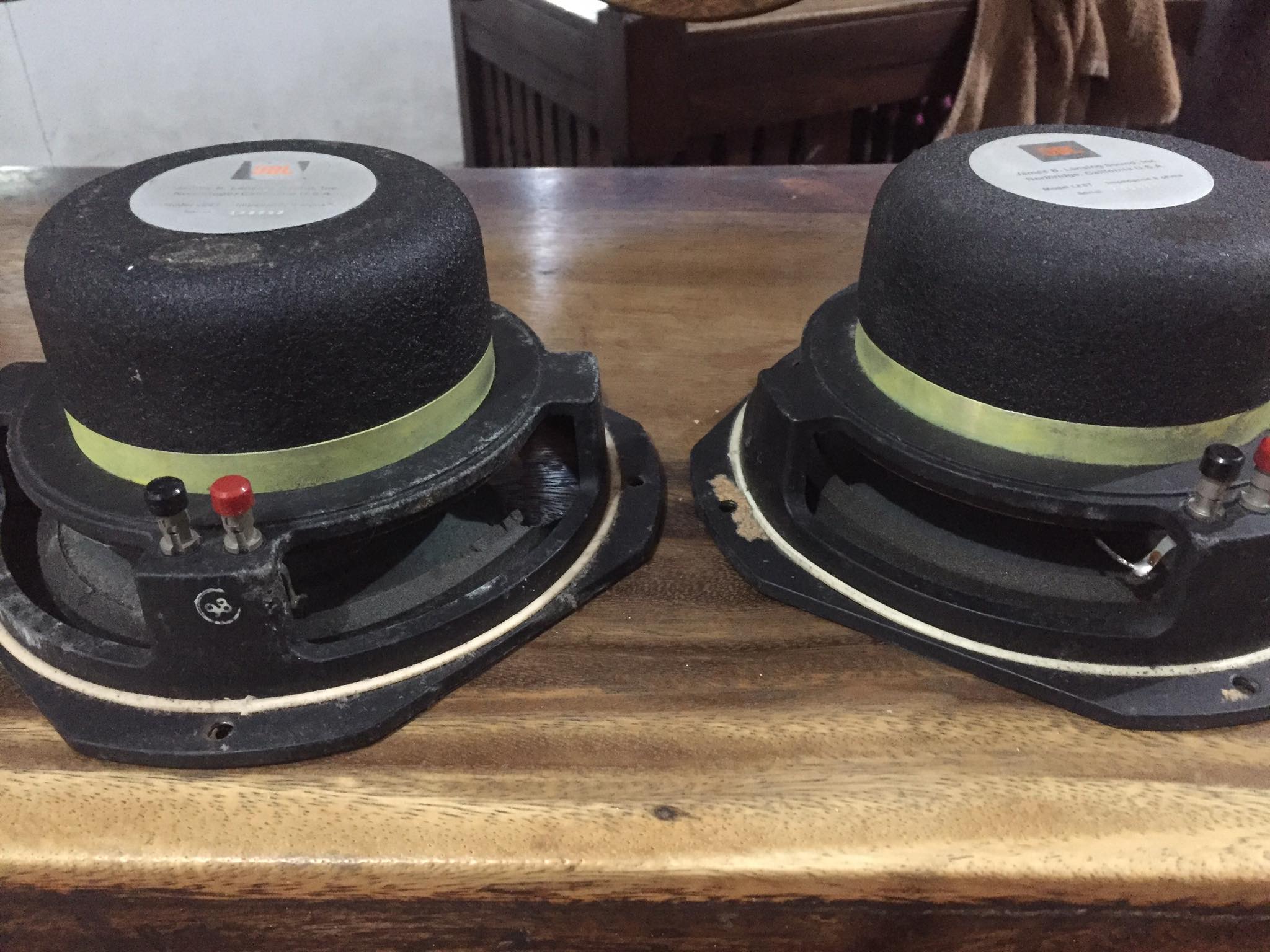

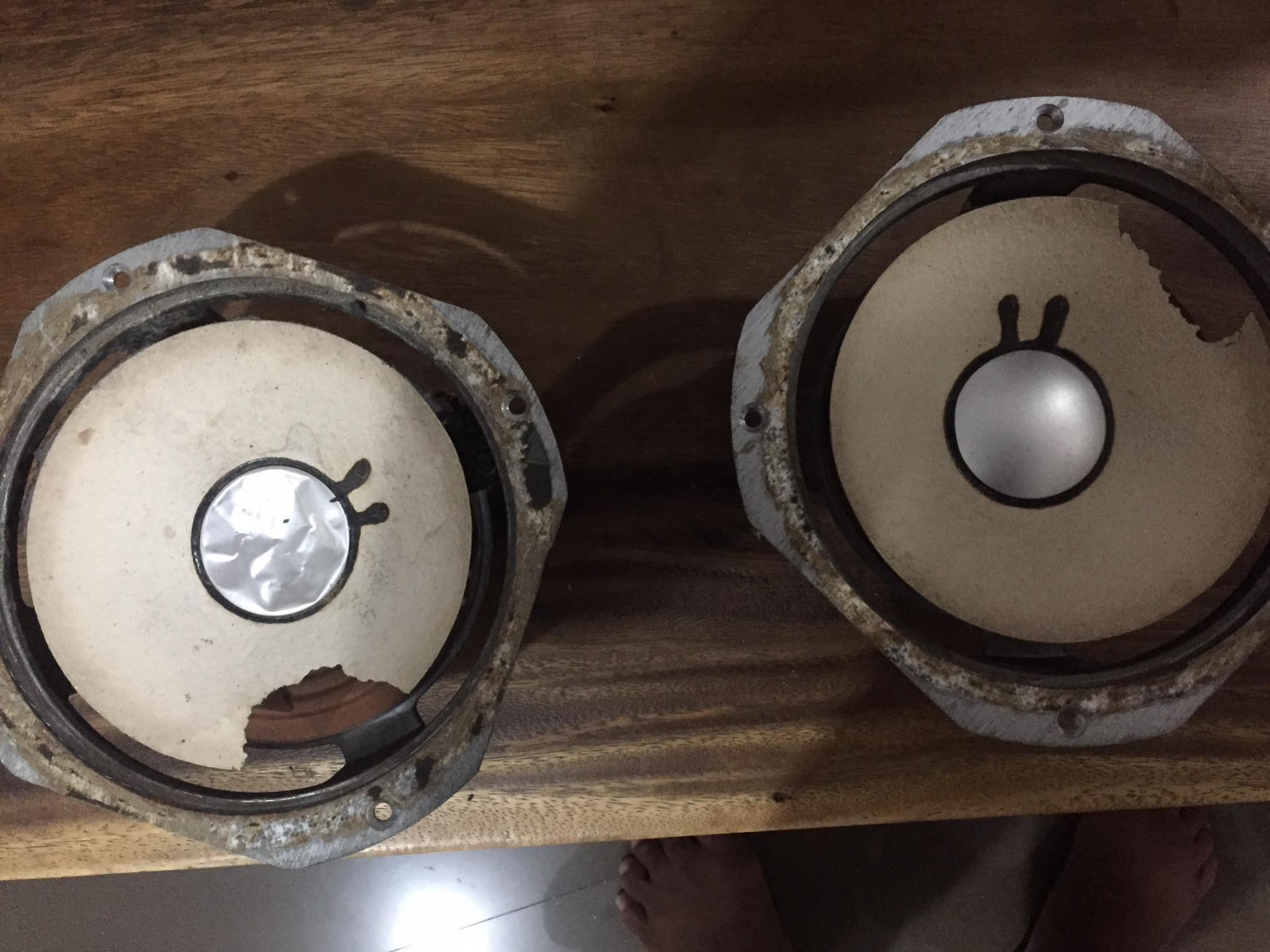

Excellent!!!!im pretty happy with how the repair have turned out!
Just which parts did you use?
its a patch up job. the guy i brought them too have a large inventory of cones from jbl, altec, ev and almost every brand imaginable. luckily he found a some torn cones from some jbl le8ts that he reconed from before he used those to patch what is missing . the surrounds arent original but the guy has a diy rig to cut the edge to the right sie. now they sing wonderfully in temporary 3 cubit feet cabs with 4*2'' vent.
- Full Range
- JBL LE8T eaten by rats
