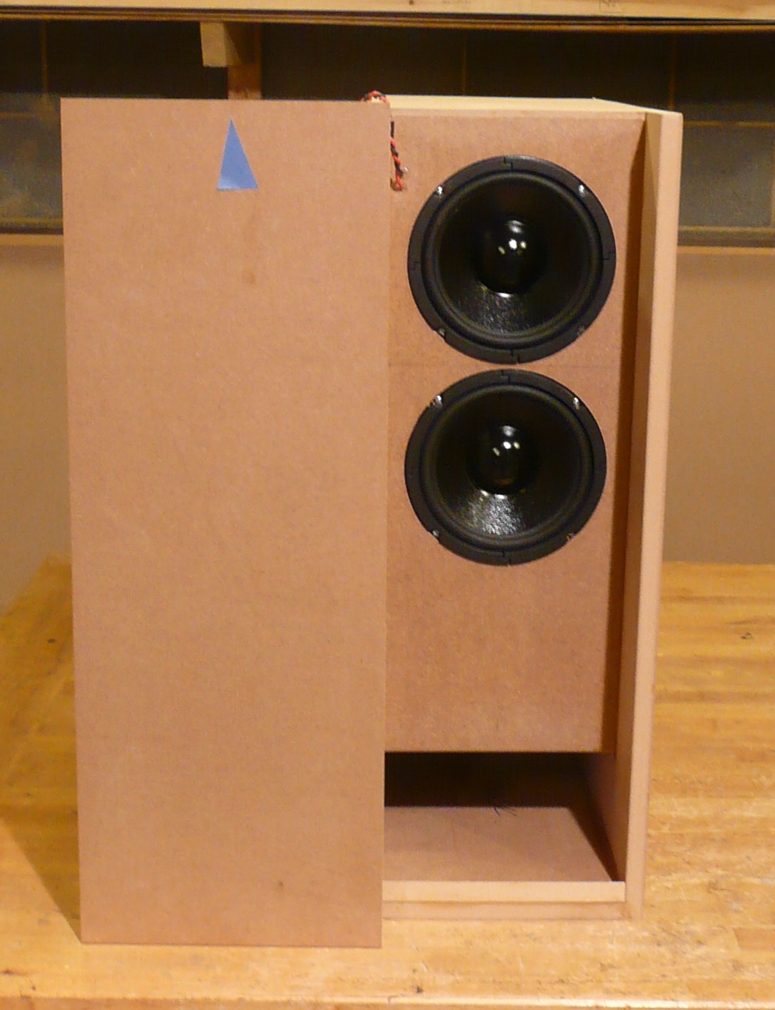

yeah that jbl, the th i have now is brilliant for quite listening, but as i turn the volume up it doesnt perform idealy at louder levels, but then again im using cheap skytronic 6.5" woofers, they're 8ohms 125watts rms and ive got two in parralel, ive got the plans on sketchup but i dont know how to post them in here, its tuned to around 35hz and goes really loud and the low end, i'd like to use the jbl and tune it to around 30hertz or lower if possible without having a big box

dual 6.5" woofer th by 2009thread1 - Google 3D Warehouse

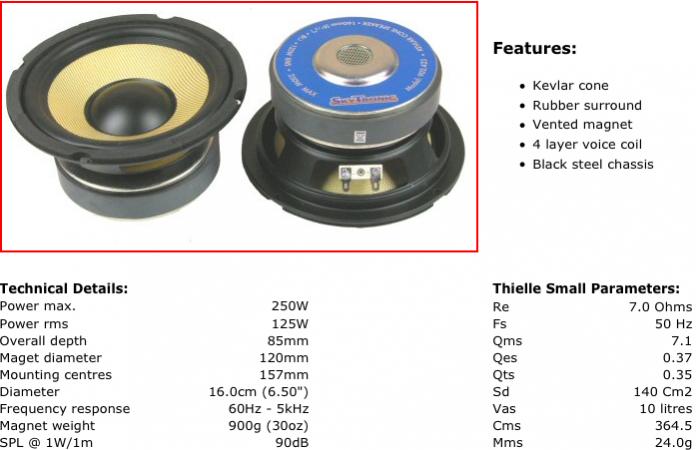

hope this works, the woofers are - SkyTronic 6.5" Woofer with Kevlar cone Subwoofer: speaker price comparison - prices at idealo.co.uk
ive got two in parralel on 250 watts rms, but as they're cheap they make some machanical noise at high xmax

for 11.99 each and there power handling i thought it would worth the attemp, they've held up good so far

If so we have?:
Code:
ID=28.80
Ang=2.0 x Pi
Eg=2.83
Rg=0.00
Fta=0.38
S1=120.00
S2=126.87
Par=17.50
F12=0.00
S2=126.87
S3=273.04
Par=215.00
F23=0.00
S3=273.04
S4=280.50
Par=19.00
F34=0.00
S4=0.00
S5=0.00
L45=0.00
F45=0.00
Sd=140.00
Bl=12.97
Cms=3.58E-04
Rms=1.25
Mmd=27.35
Le=0.80
Re=7.00
TH=2P
Vrc=0.00
Lrc=0.00
Ap1=0.00
Lpt=0.00
Vtc=0.00
Atc=0.00
Pmax=100
Xmax=5.0
Comment=SkyTronic
thats for the skytronic woofers, or am i confused ? ive got the two jbl's so i want to use one of them for a tapped horn lol
