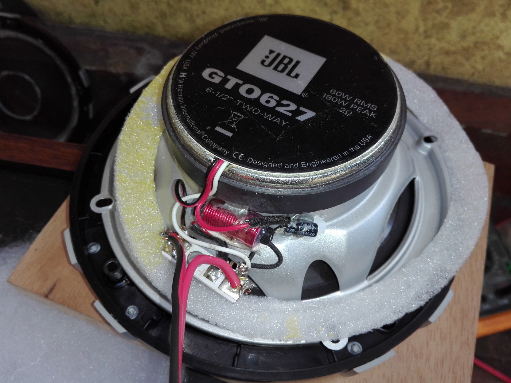

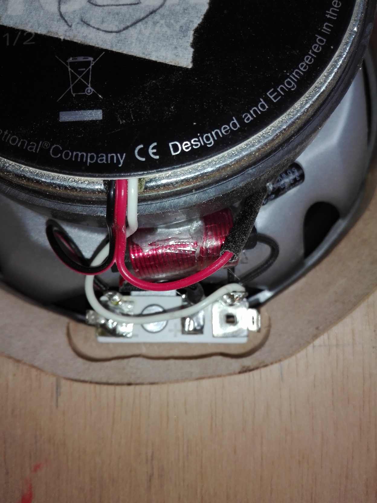

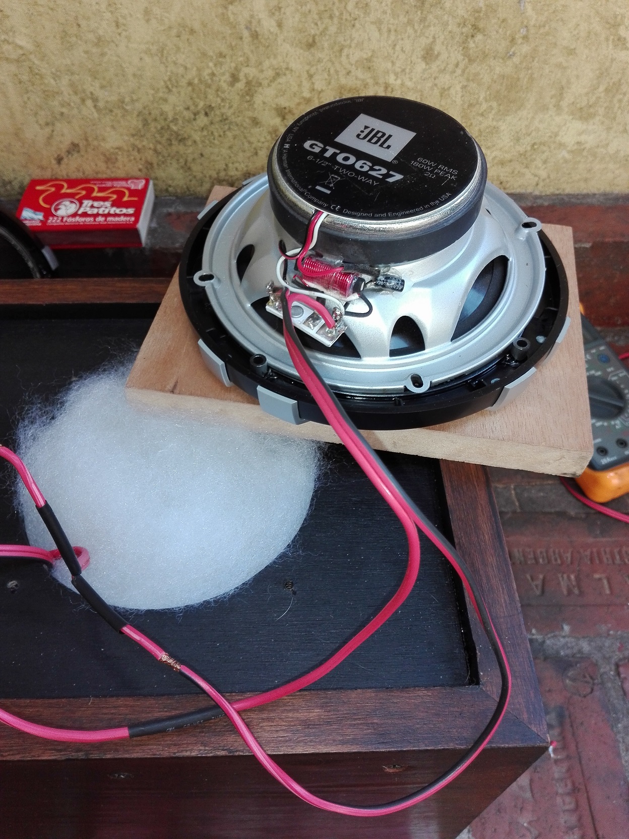

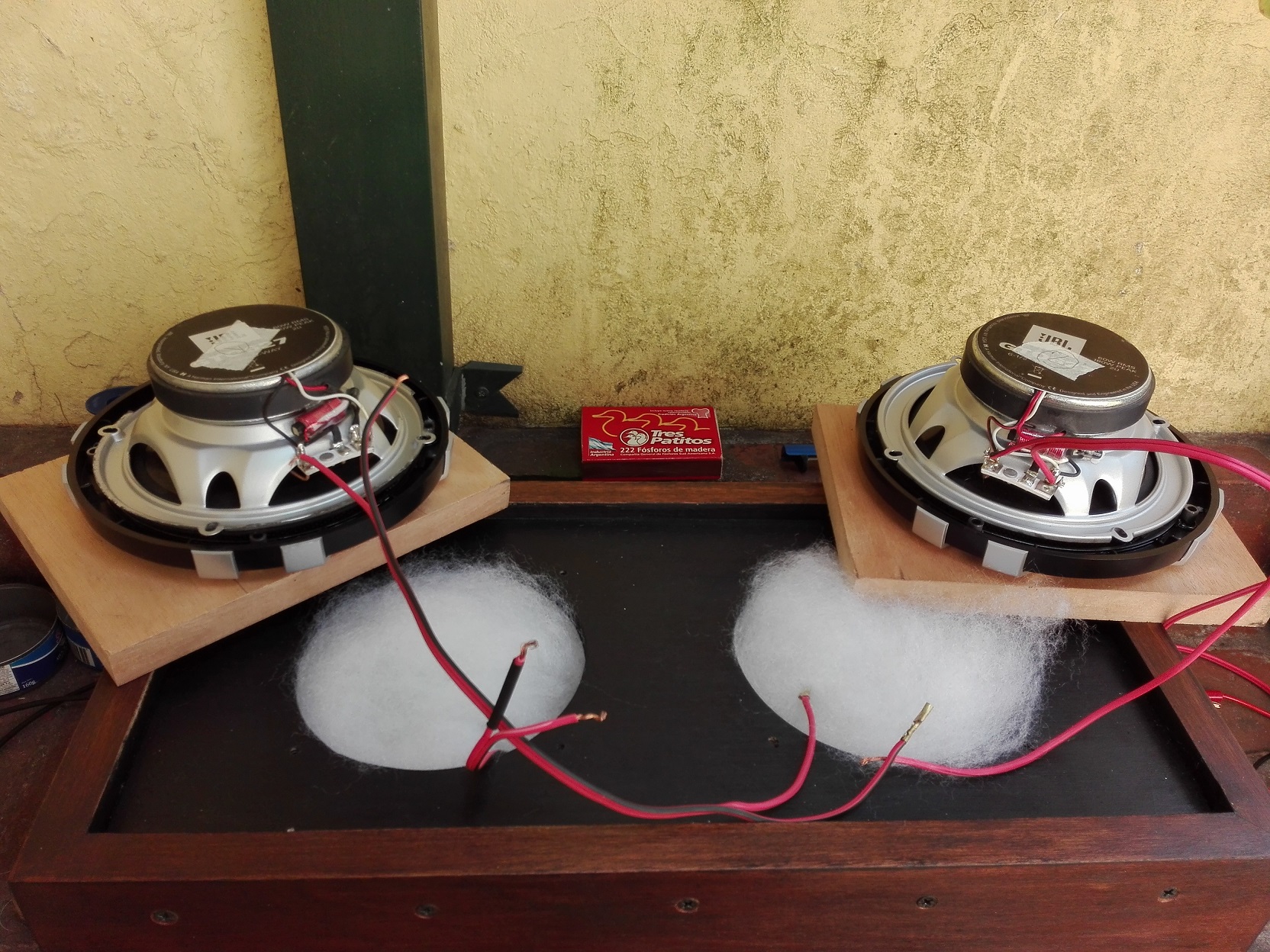

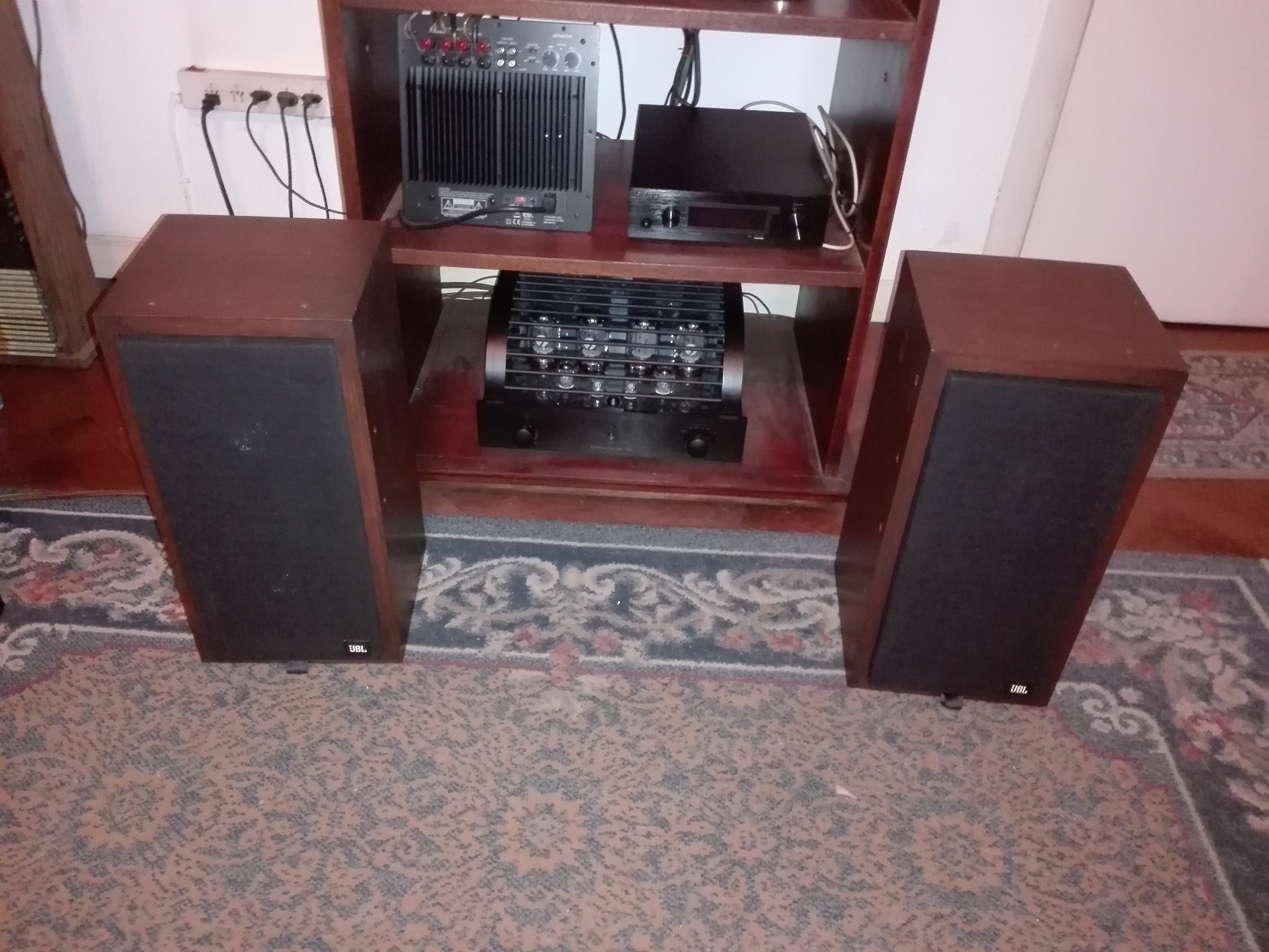

I'm not a speaker designer/builder, but here's what I know:
- Messing with the cross-over is pointless; as you've pointed out, it deals with the transition between the woofer and the tweeter, therefore at some high frequencies, e.g. 5KHz.
- You need to work on the Qtc, the overall Q factor of the speaker/box combination, ideally 0.5-0.7 for a critically damped system. But since your speakers have a very high Qts and the volume of the box is fixed, the only course of action you have is to add LOTS of damping material inside the box. Expect a few dB's of difference at the most.
- See also this discussion; it's about ported enclosures, but sealed boxes work the same way, with a softer roll-off below the resonance.
- As an example illustrating the other extreme, at home I use a pair of subwoofers with 12" speakers, the Qts is 0.14 and the box is about 100 lt; it's a much over-damped system, I know, but I like it that way.
- That being said, the younger folks often think otherwise: my kids hate my subwoofers, they want lots of bass!🙂

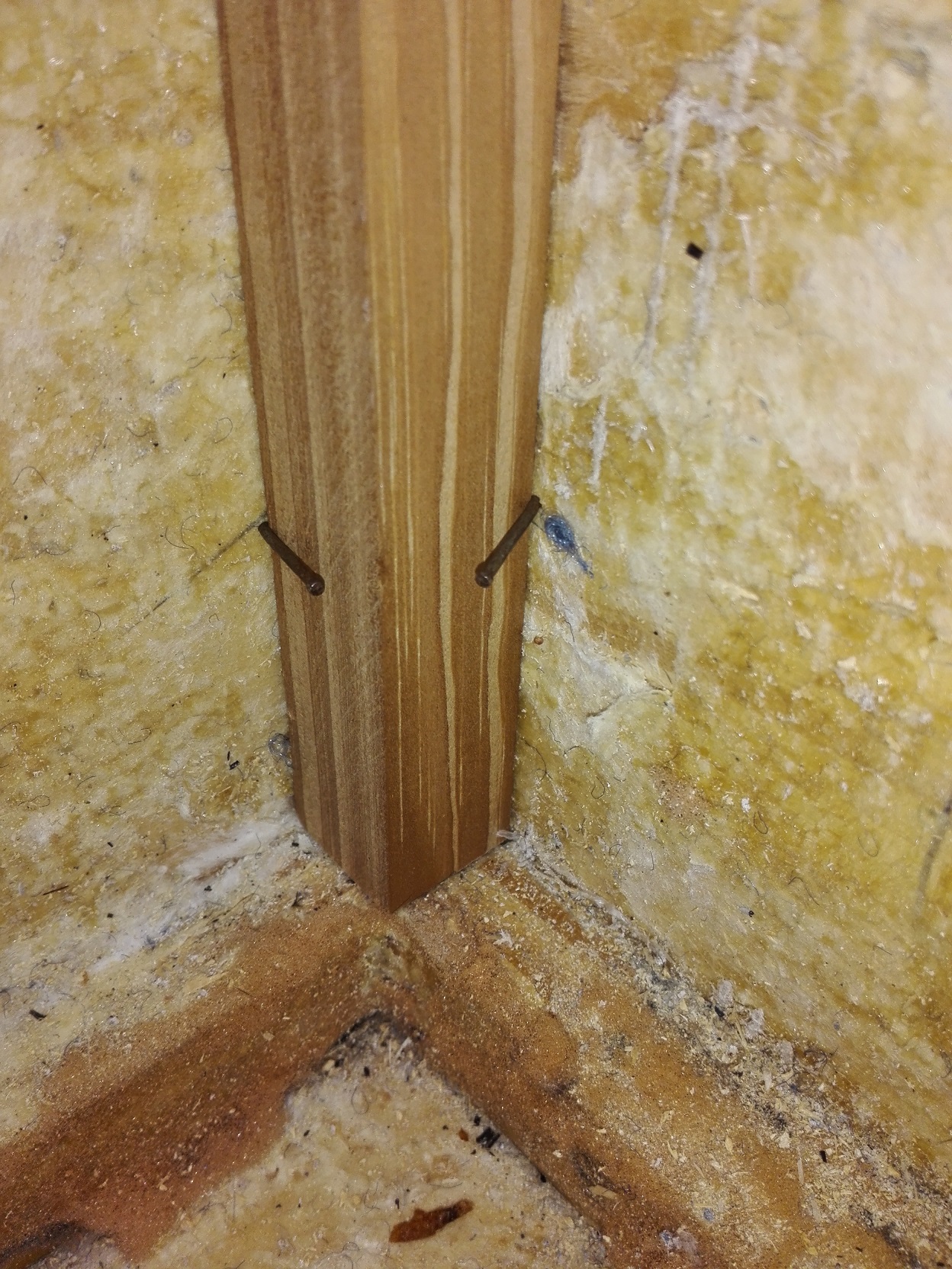

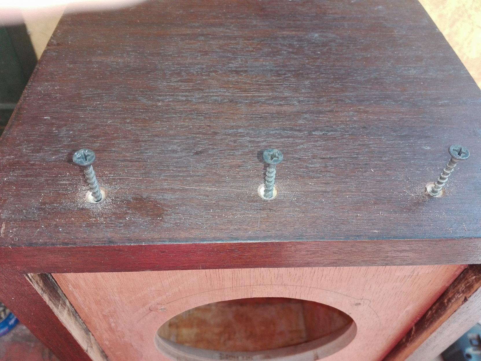

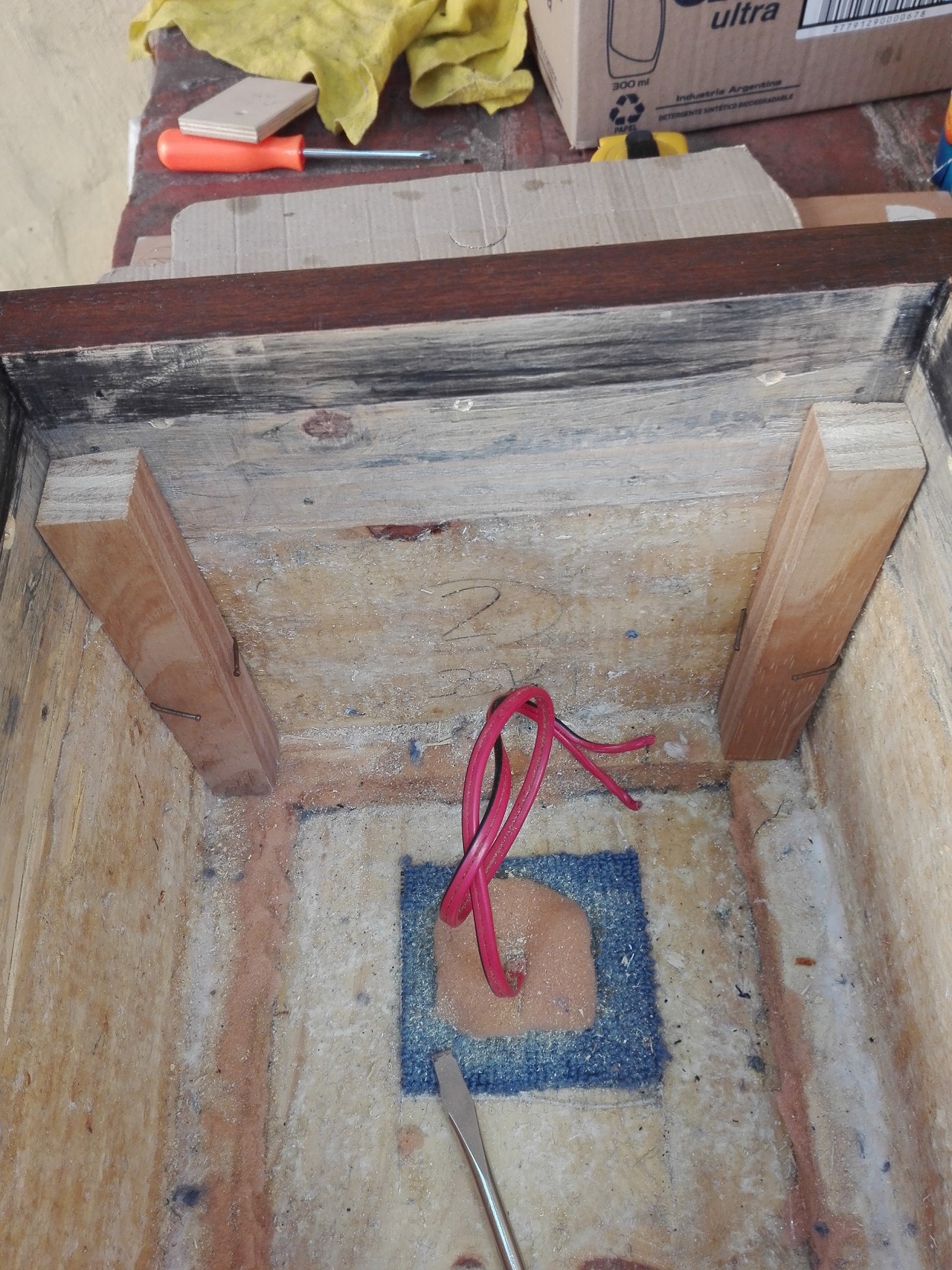

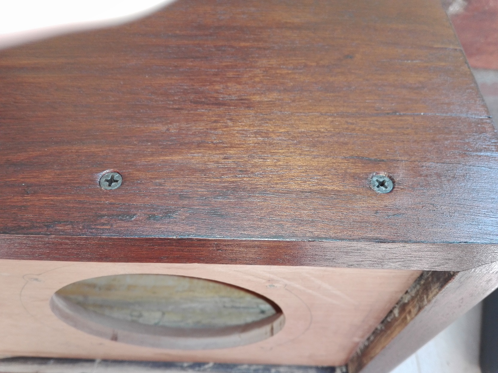

More pics

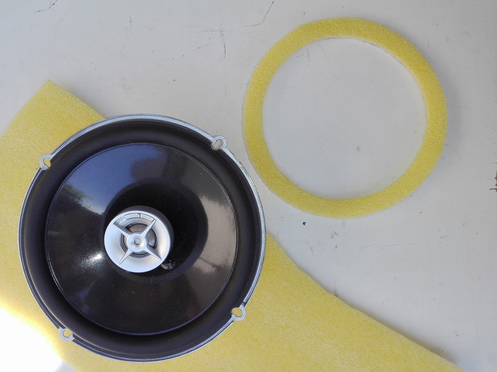

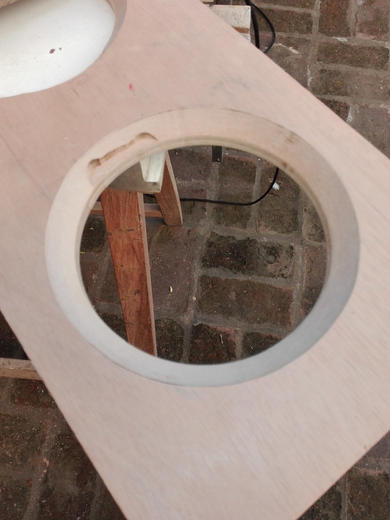

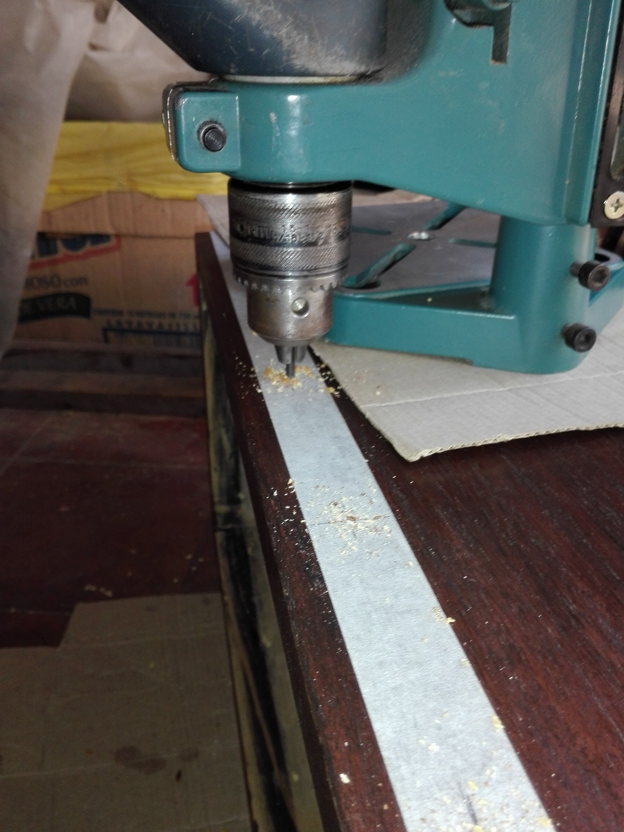

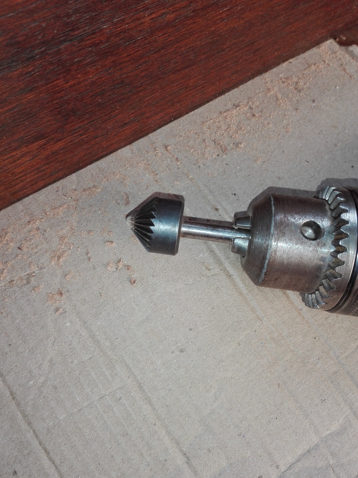

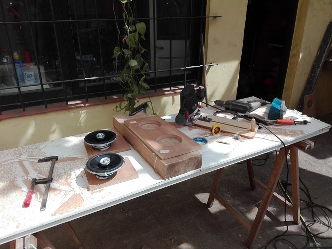

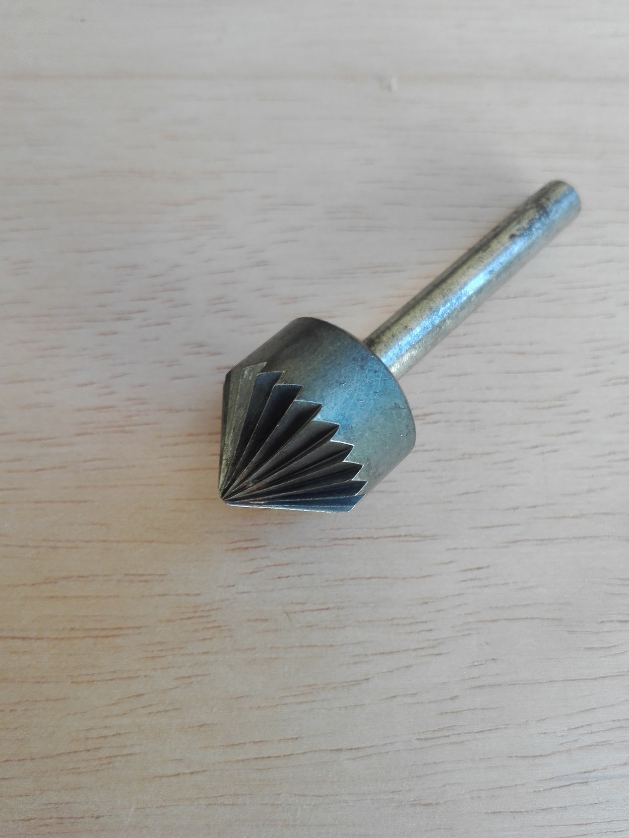

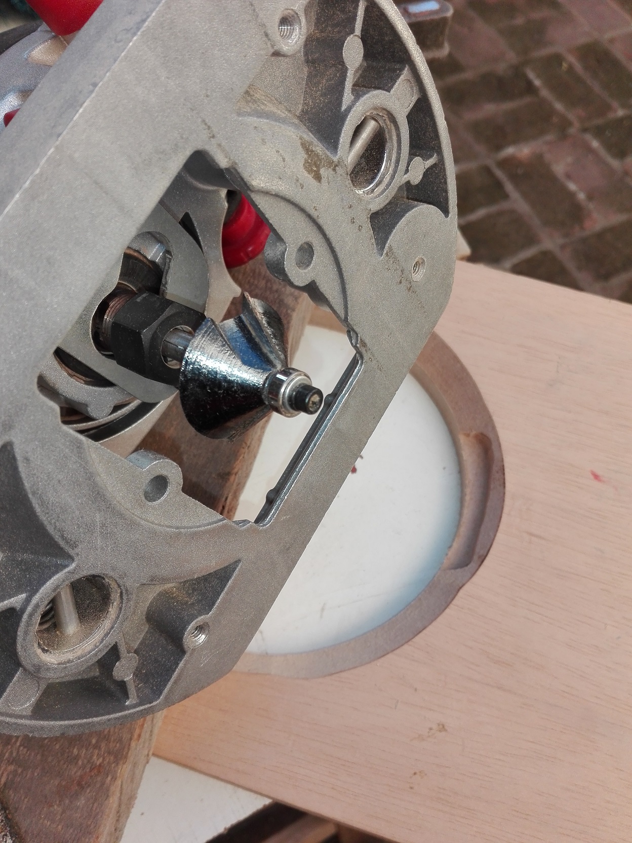

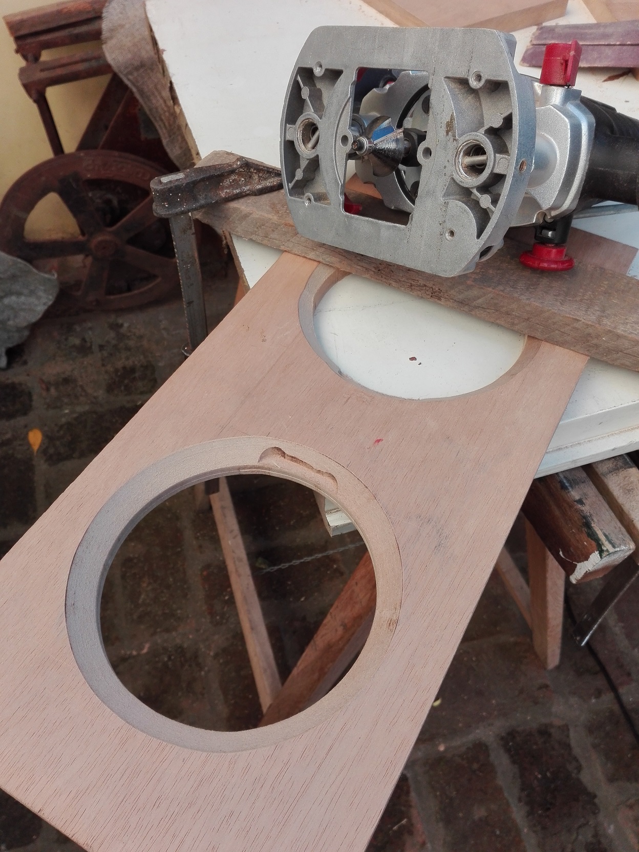

I was reading this article and decided to improve the chamfering.
chamfering driver holes
If we're going to do it, let's do it right, do not you think ? 🙄😀

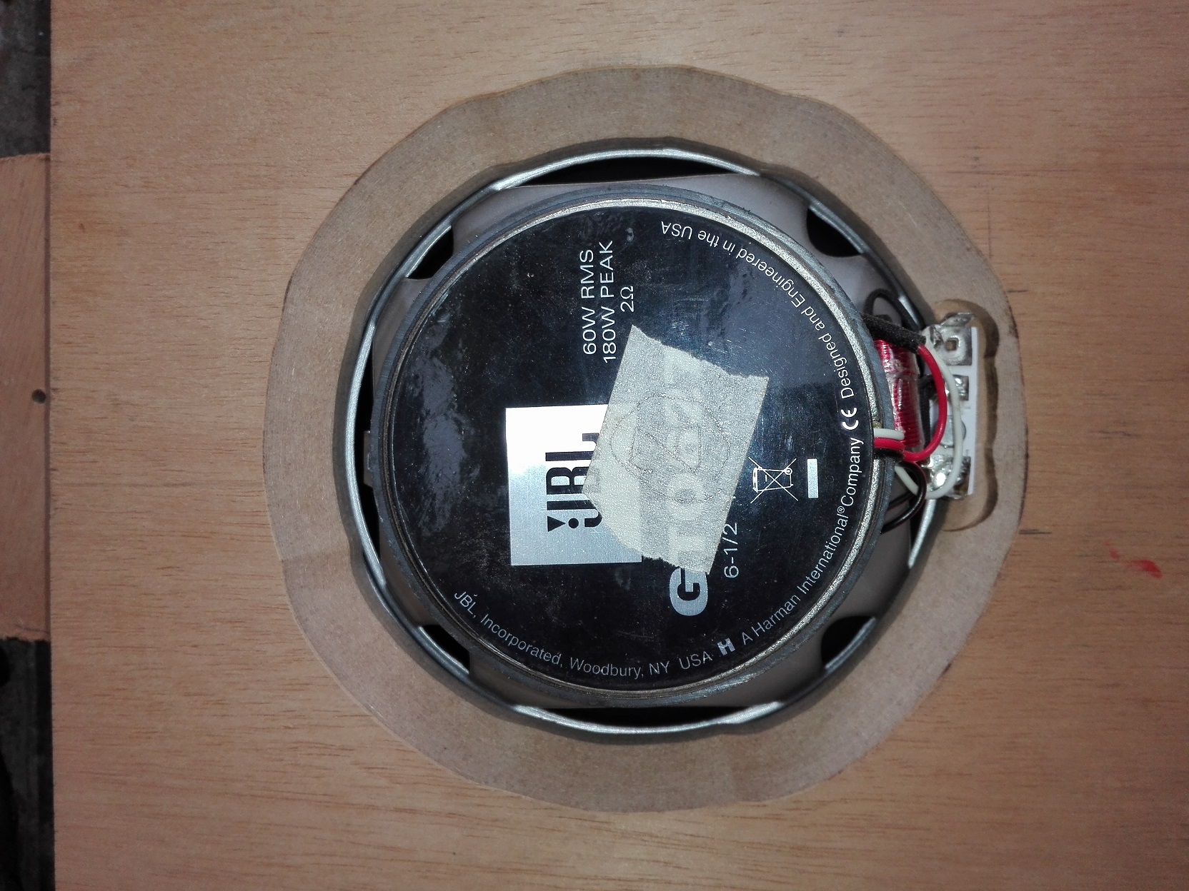

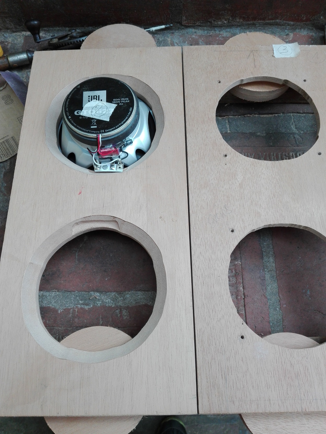

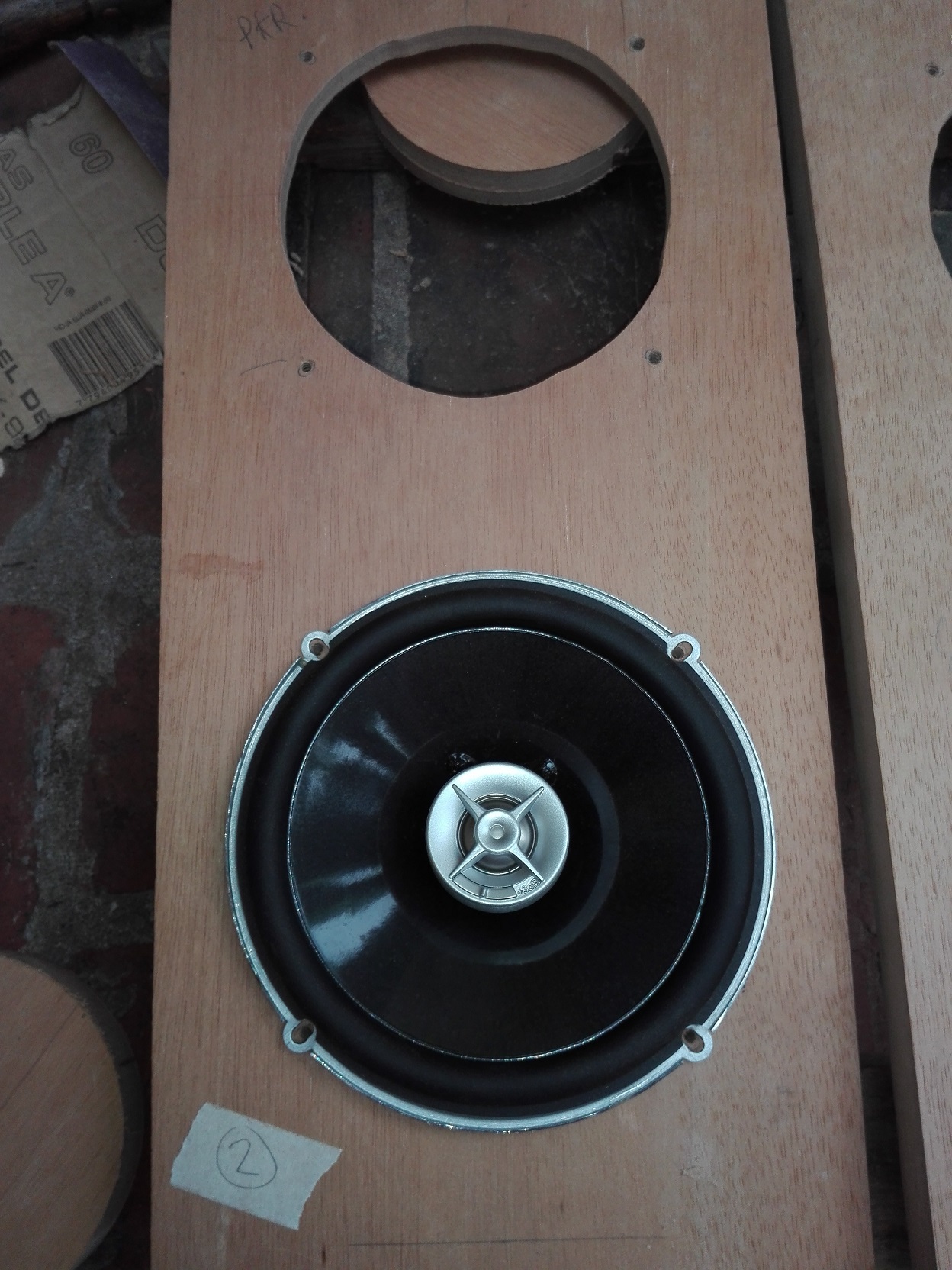

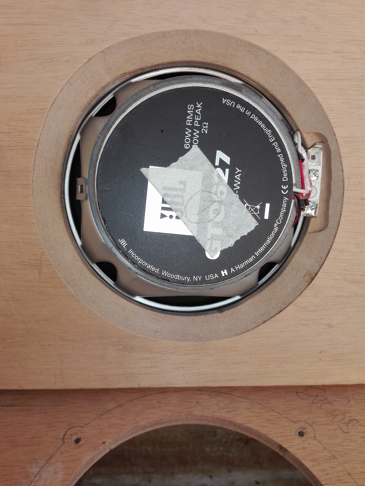

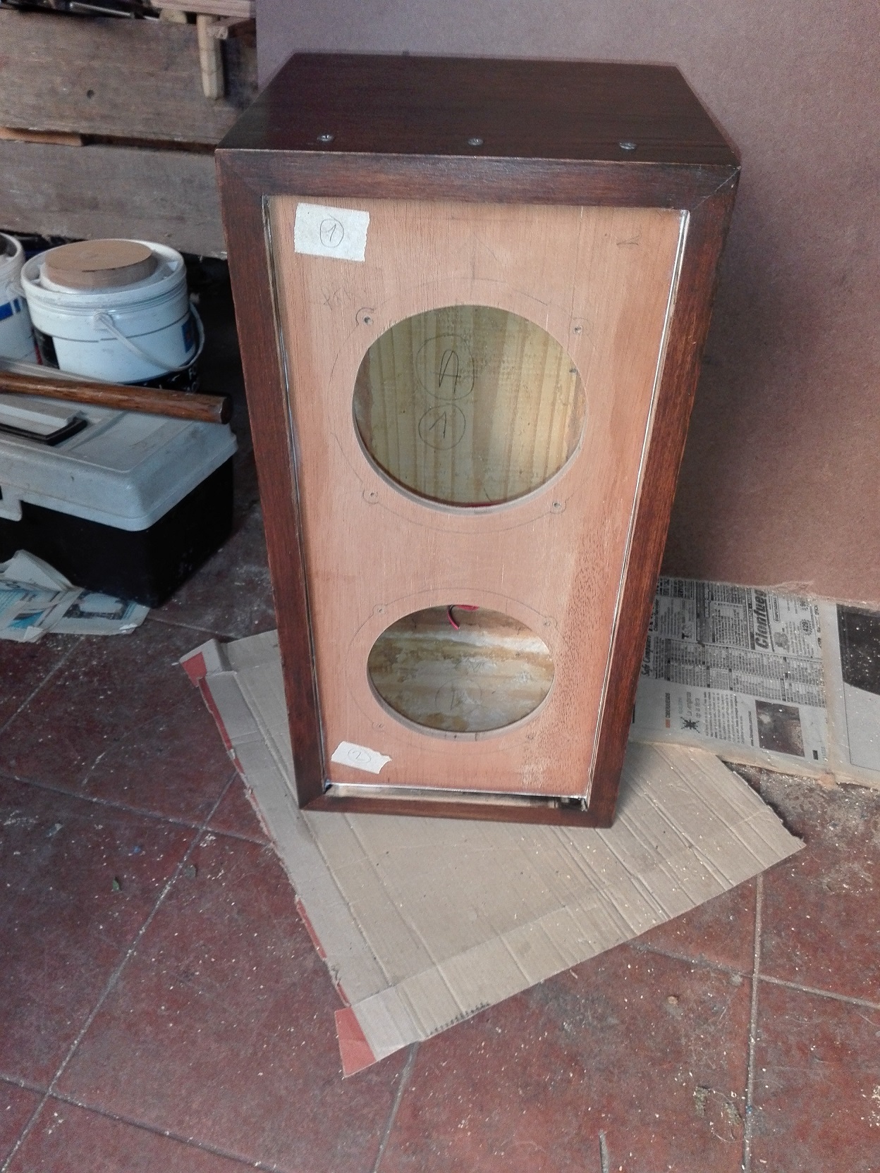

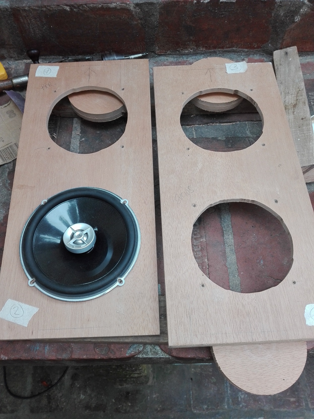

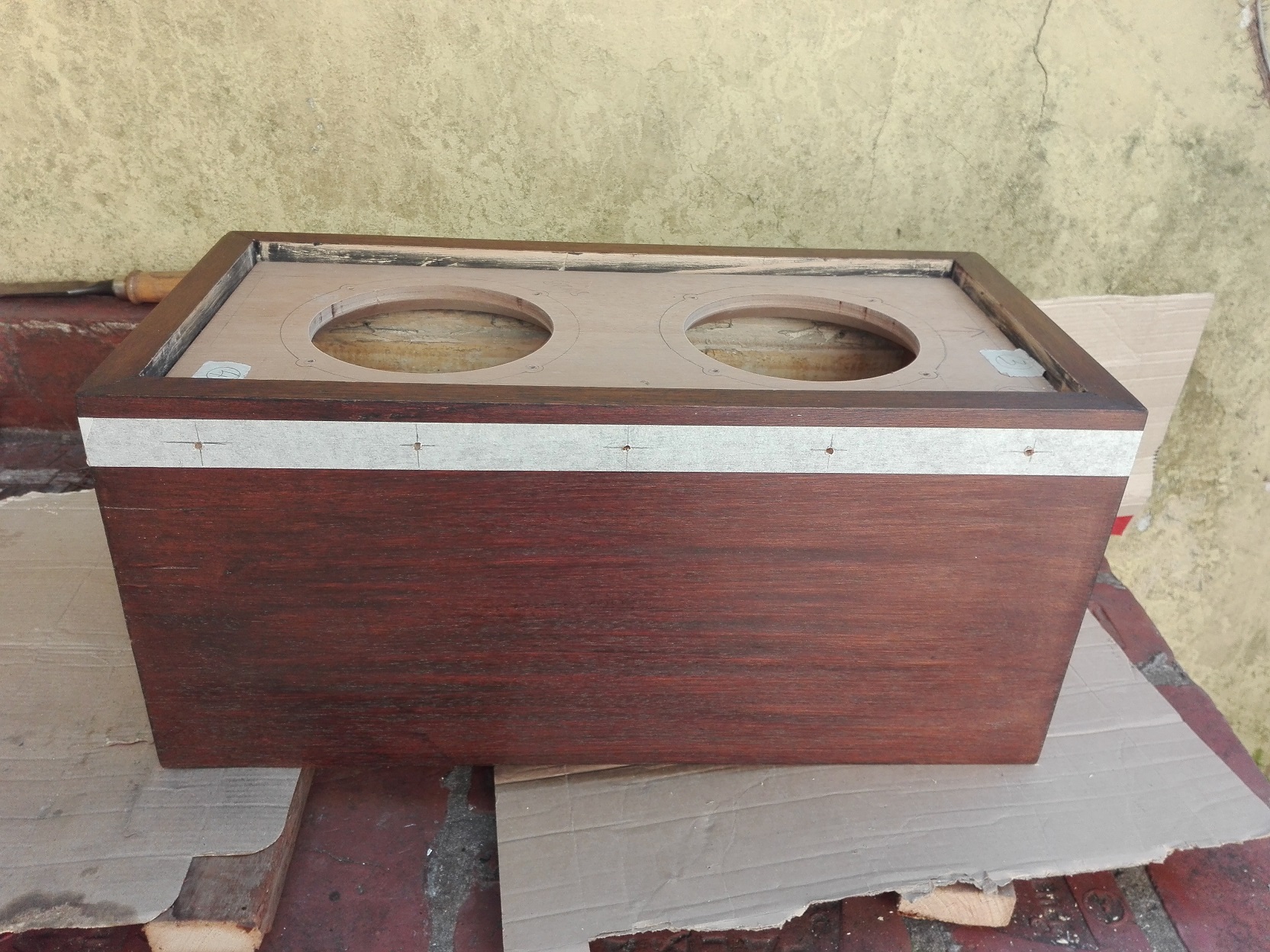

More pics :

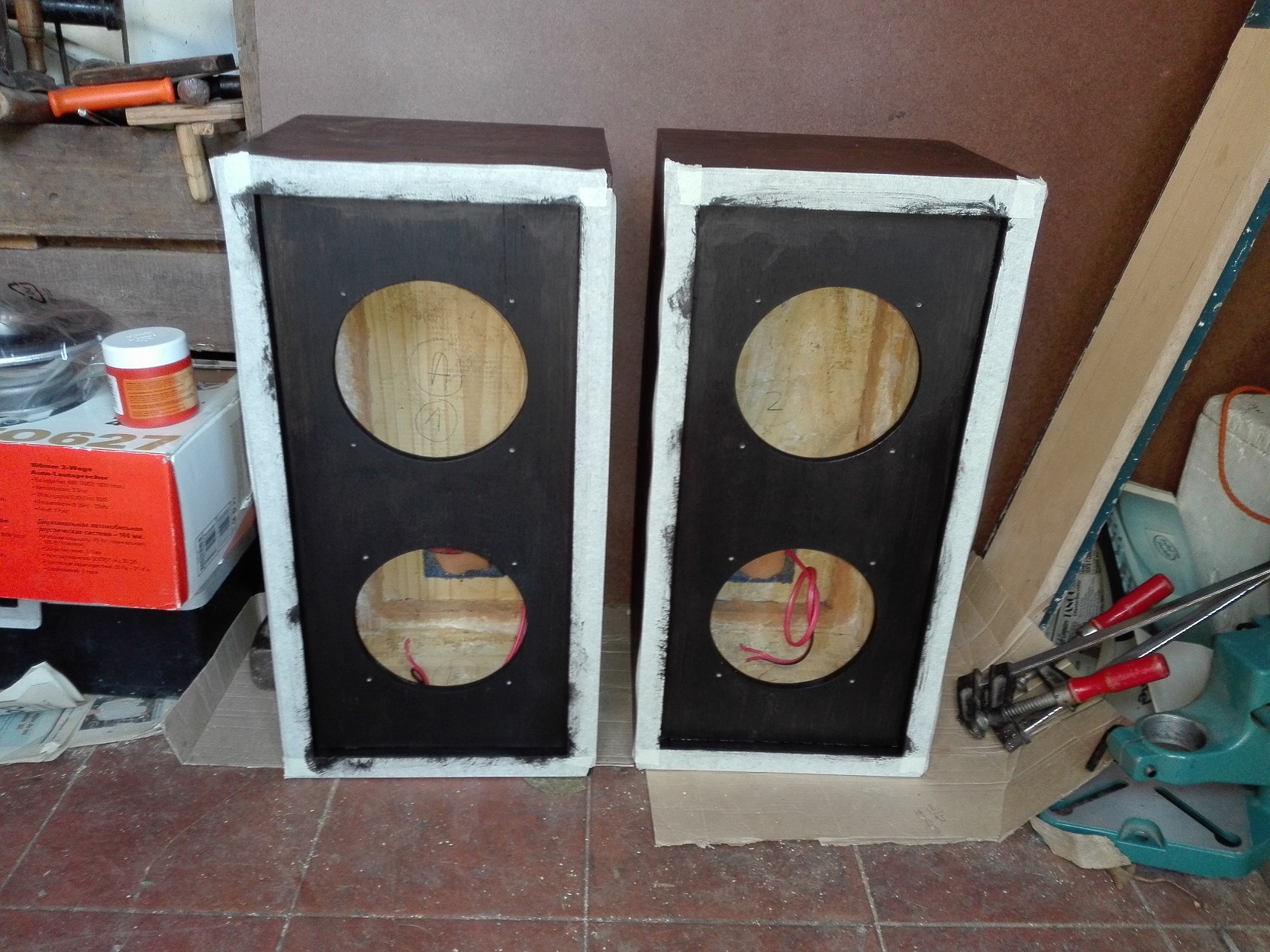

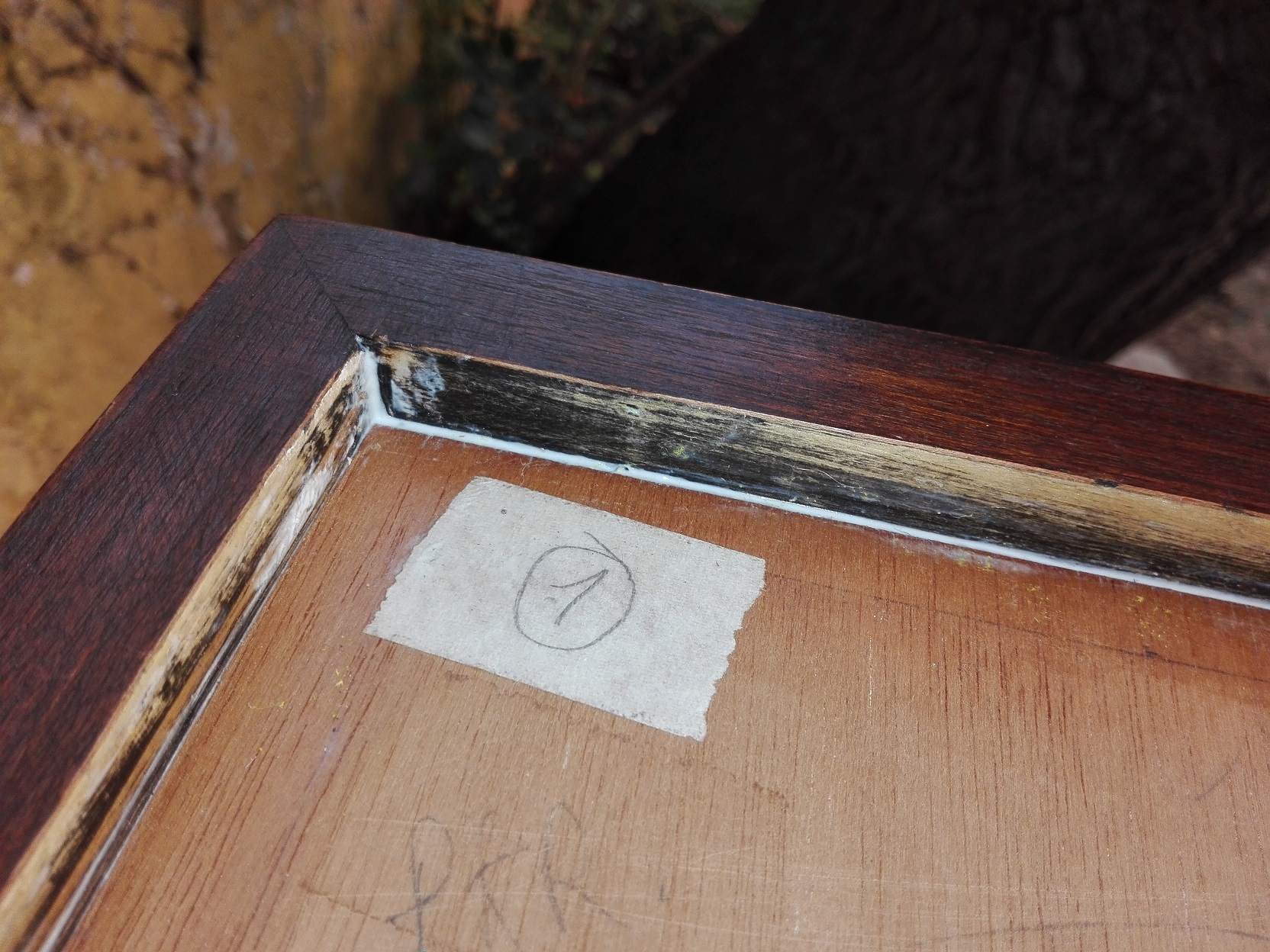

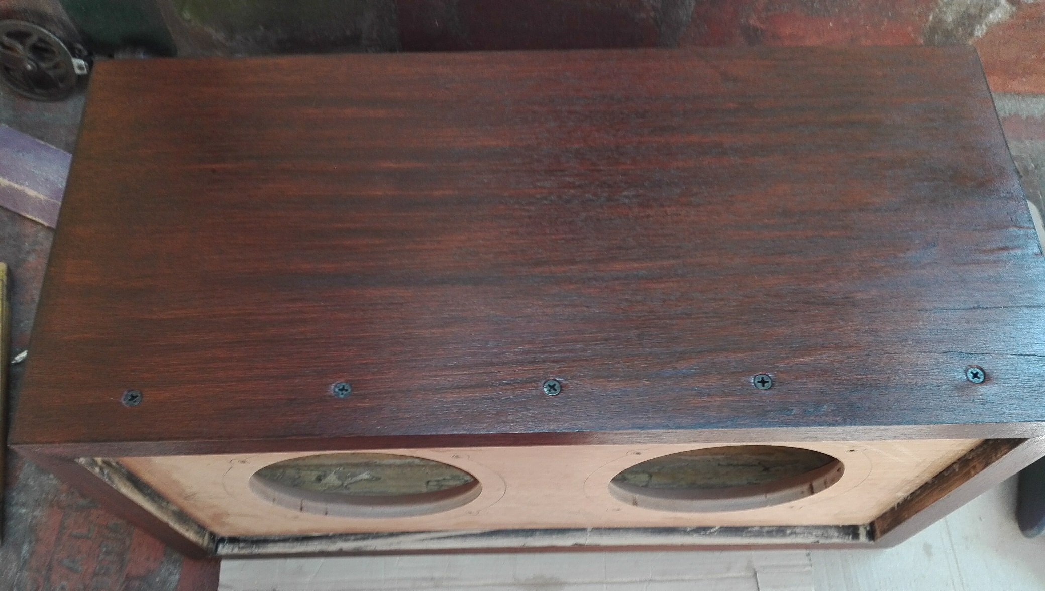

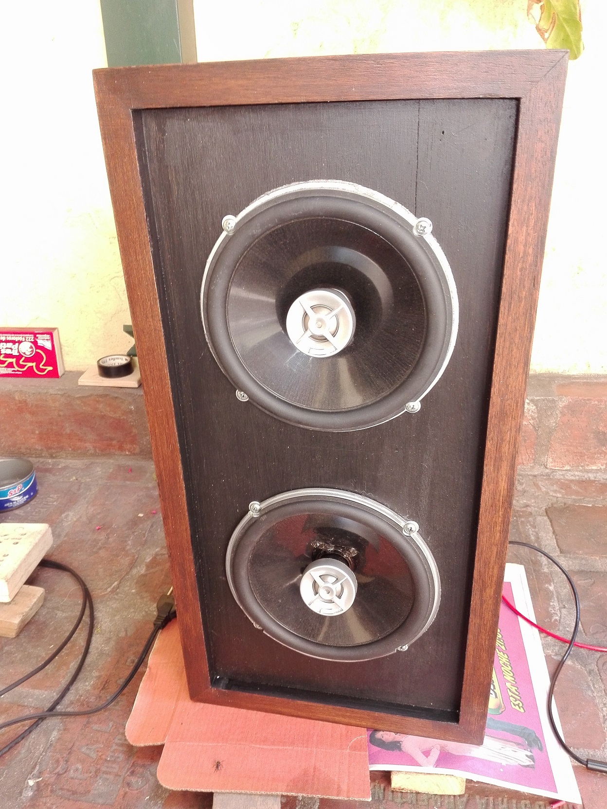

Screwed and glued to the front panel :
It is almost ready, just need to adapt the frame.
The sound: Clear voices, controlled bass, zero boomy.
They deliver their best performance if they are powered with good power, there is no car cabin gain here.
PS: to prevent overheating I used the paint suitable for high temperatures. I believe that 360 degrees Celsius of protection will be enough
