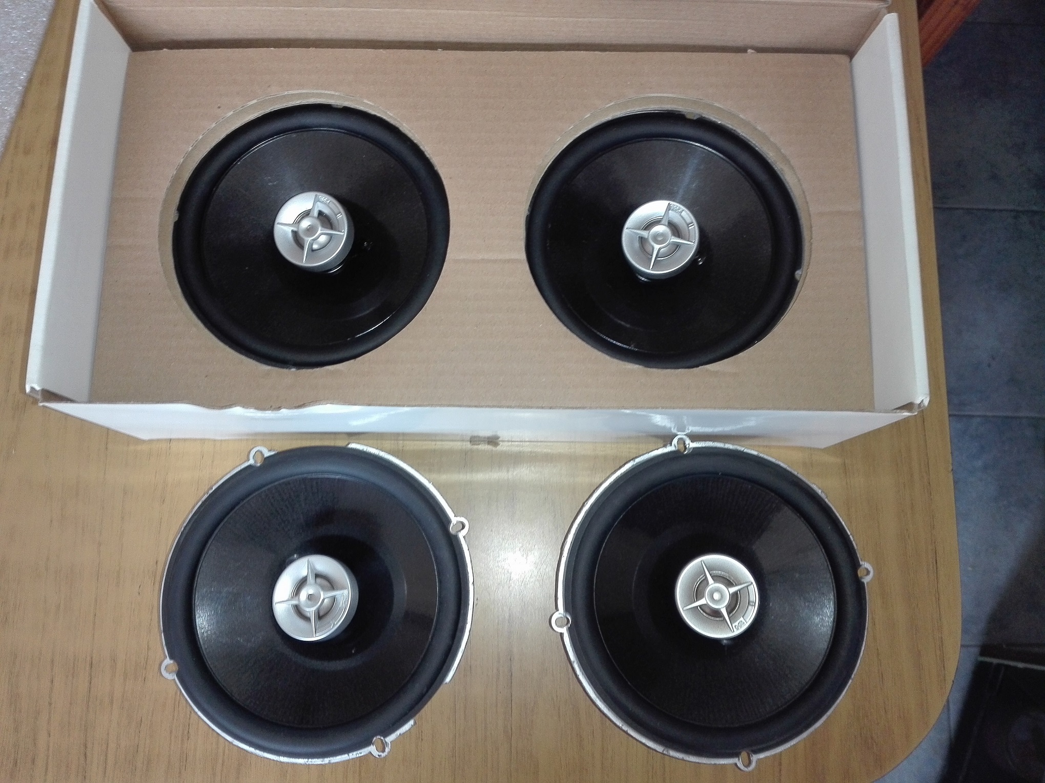

Hello, please, I need to have an idea (even if it is approximate) of the compliancy (Qts) of this speaker.
I've always wondered how a particular speaker can work efficiently in the boot or on the door of the car.
I have never seen published compliancy values (in car speakers of any brand), is it supposed to be low or high?
I have not found information on the web, can anyone here help me ?

I just want to modify a box that I made a few years ago. But, as I now have more knowledge and learned how to use and interpret WinIsd, I want to do something more accurate, although it was calculated at the time with the available formulas, I chose a high Qts value by deduction, just because I noticed that this rubber suspension of the GTO627 is very hard...

With respect to the reason that made me build these cabinets, it was because at the time I decided not to modify (spoil?) my car to improve its sound. I see your avatar and I understand that it is your "strong", then you will understand me. I hurried and bought the speakers first convinced that I would not have problems with the installation in the trunk. It was not like that, unfortunately. They were about a year, on a shelf waiting for their destination.
And I went back again buying two identical extra speakers for the front doors. Until it was time for installation, and the surprise was the speakers in the trunk were too big for accommodation, the original speakers have a much smaller magnet than the GTO627. But all this is past history.
So I decided to give them a different use (and entertain myself a little) by building a box with a speaker for each one.
I'll tell you that I liked the sound obtained with my DIY work better than the sound of an Infinity SM-65, with which it was compared exhaustively) The titanium tweeter of the car speaker JBL definitely left behind the Infinity Polycell .....
And with some basic calculations and a lot of trial (trial and error), I also managed to get the middle / bass sector to have nothing to envy to the Infinity 2 way. I worked on the tuning so that the bass was a bit drier than the Infinity, they were a bit "boomy". A matter of taste, perhaps.
But now I want to make use of the other two remaining speakers ....
I hope you understand, my English is quite primitive, and San Google is my permanent help.

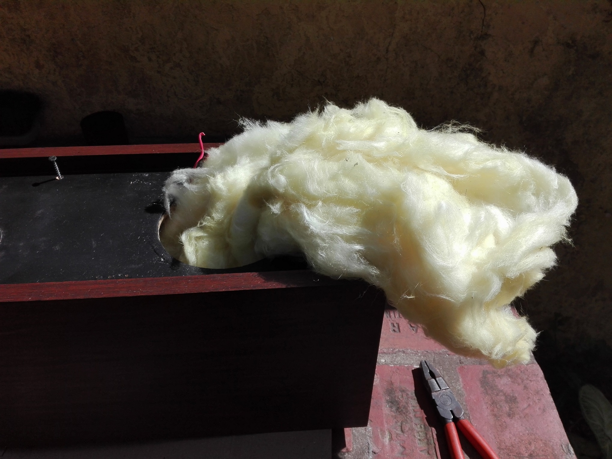

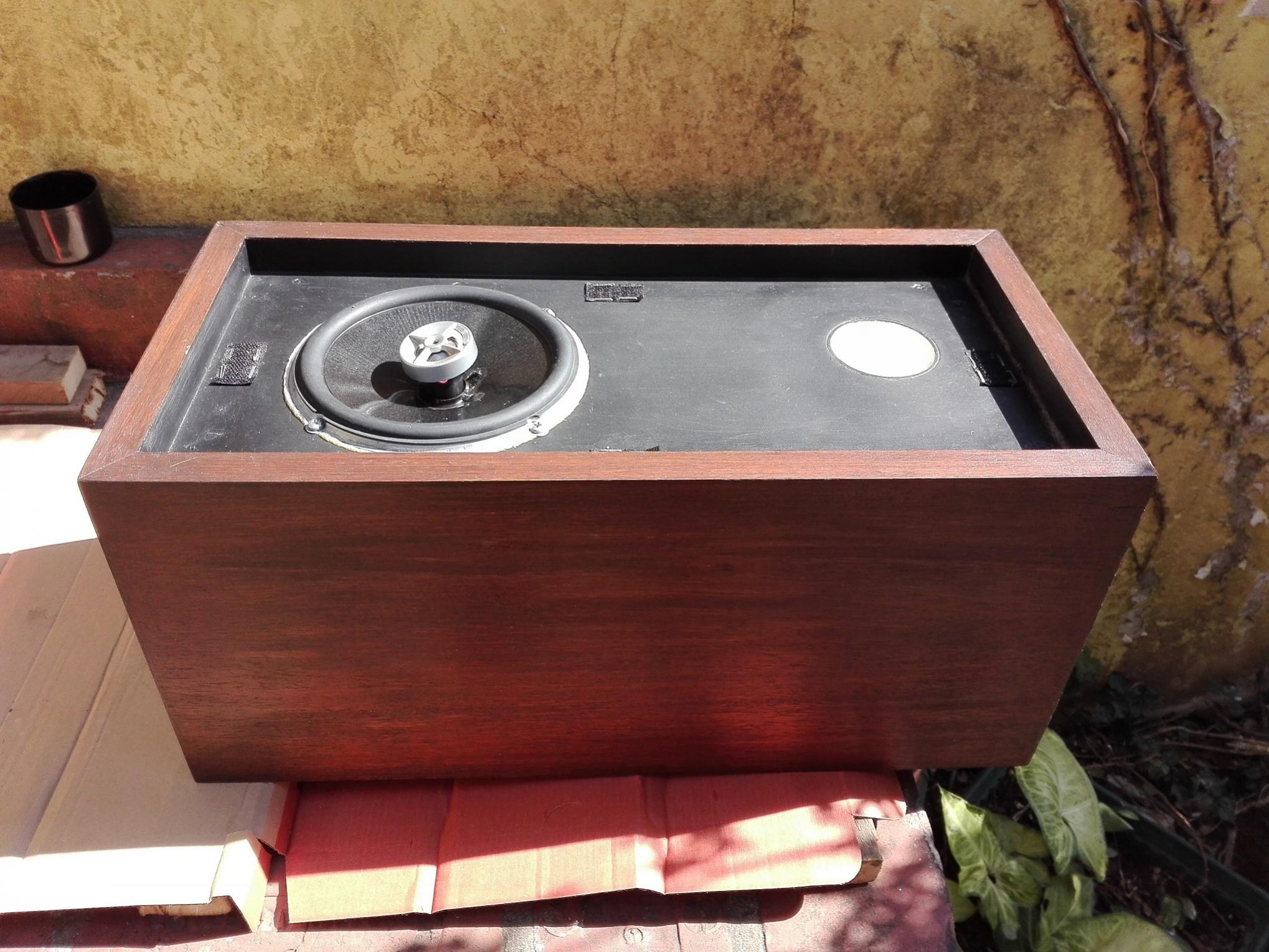

It will be a D'Appolito configuration (pseudo), 2 identical speakers per box, the cabinet is 25 liters, with the virtual increase of about 20% of polyfill will reach 30 liters.Approximate. (I will eliminate fiberglass, it's time to modernize and protect my lungs)

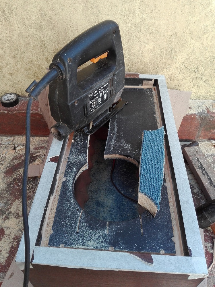

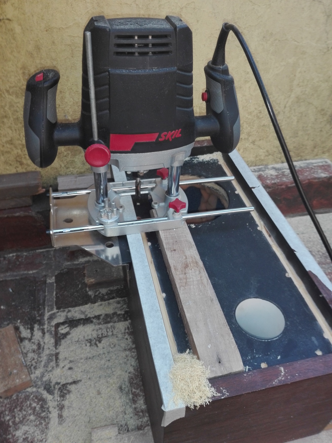

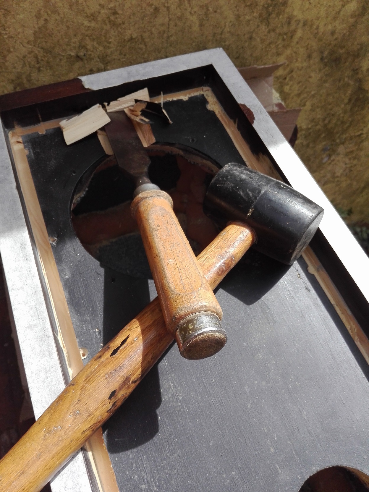

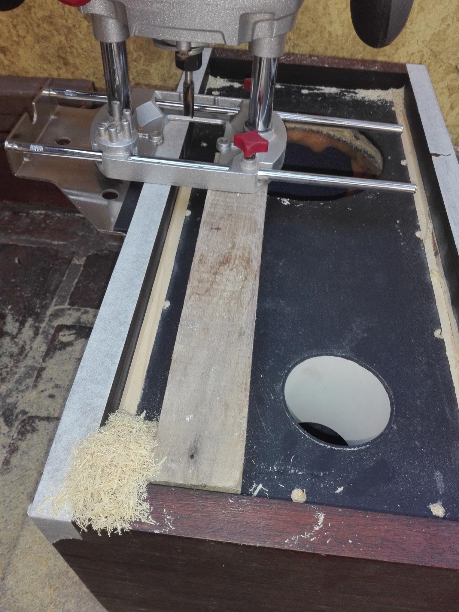

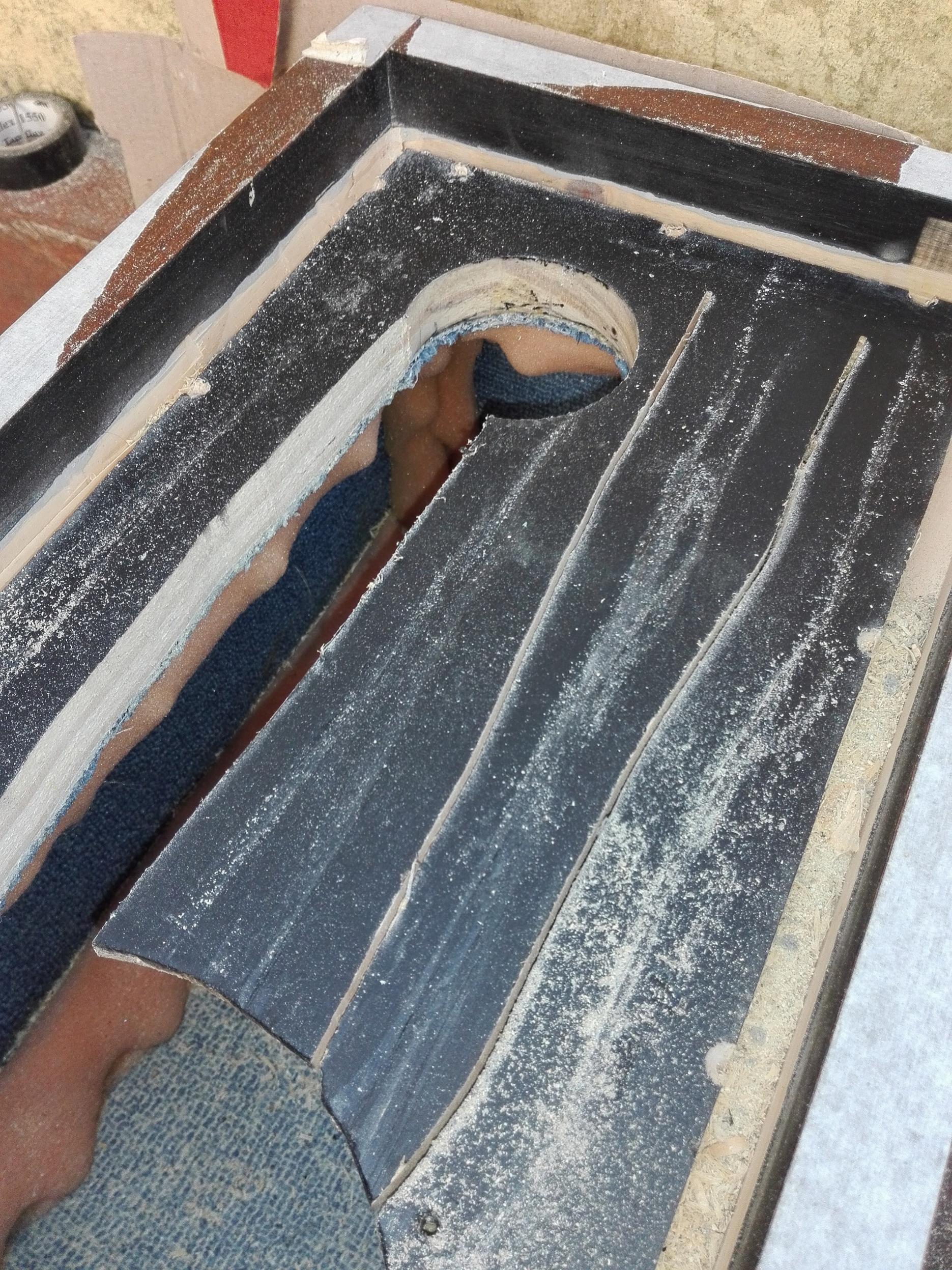

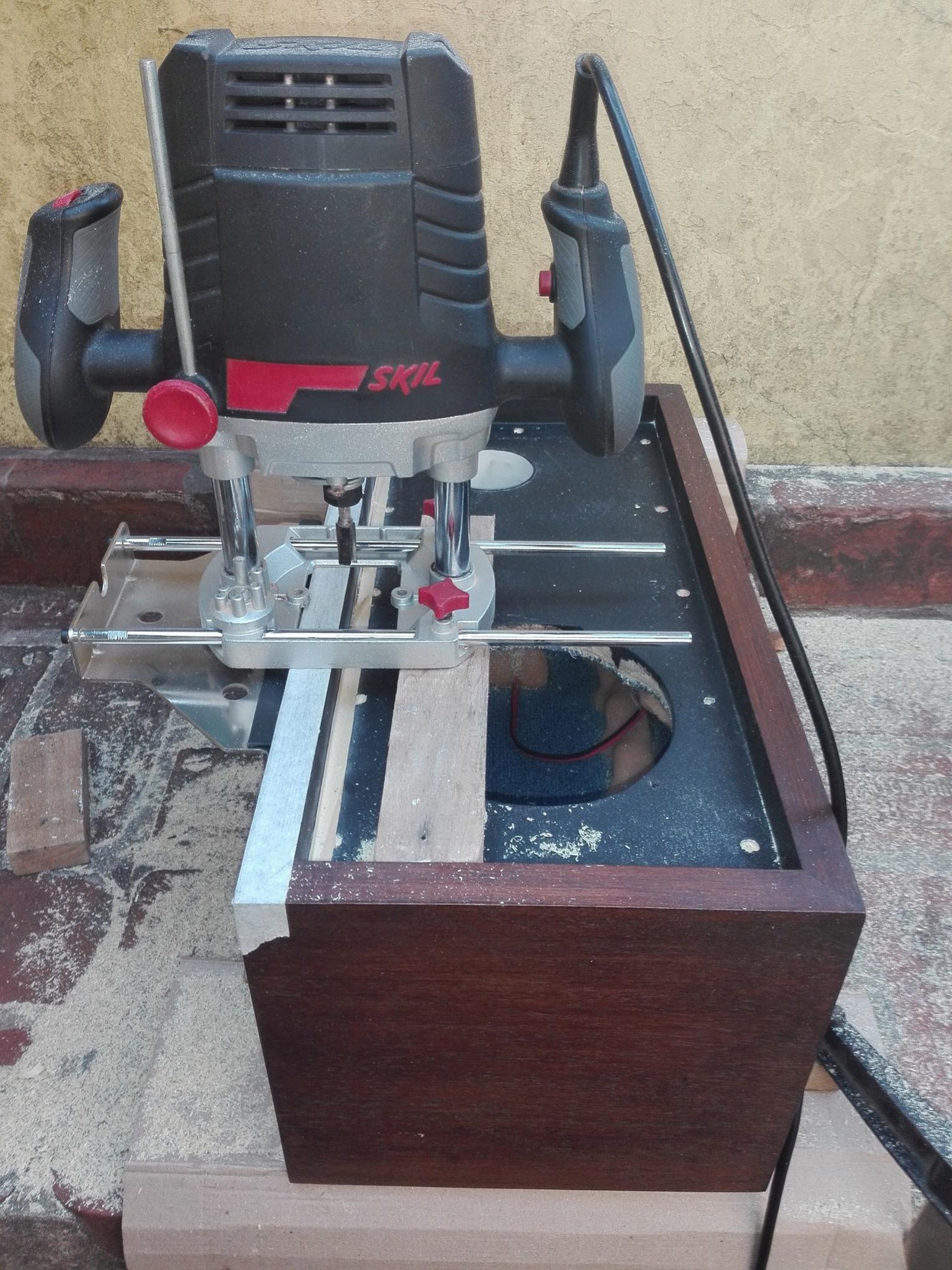

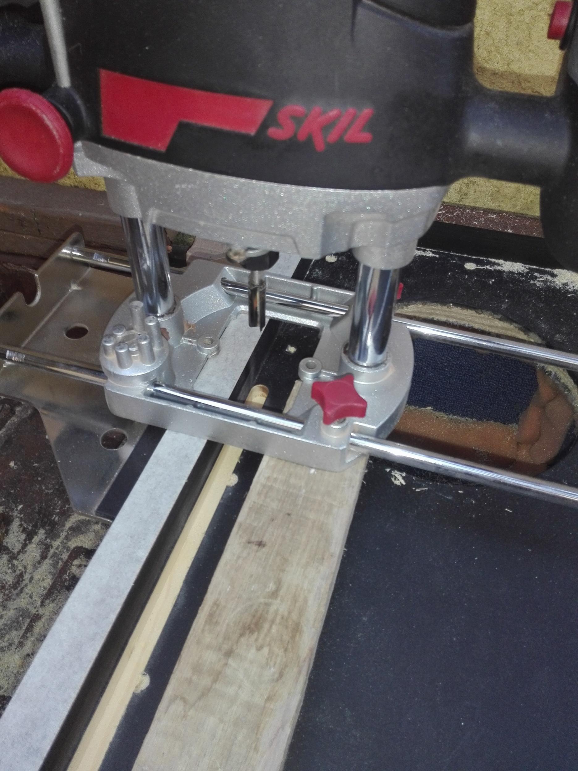

The front panel (baffle) must be replaced to accommodate the 2 speakers there. Win Isd makes a small difference in favor of the sealed cabinet, so there will be no tuning tubes this time.
Neither will it be necessary to design the xover, it will remain the same, it has behaved
well before.
The loss of SPL going from vented to sealed will be compensated by the extra speaker .
Unfortunately this Skill router machine has very little vertical travel, so I must finish the job by hand. But it will be much easier, 3/4 of the thickness of the baffle was devastated

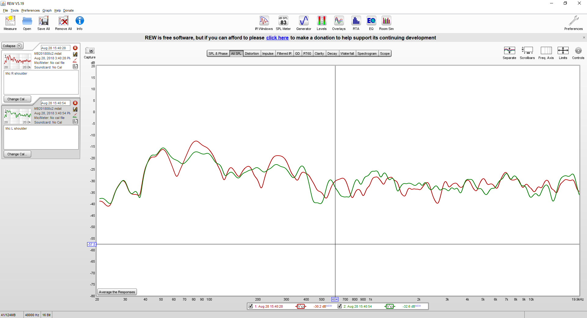

Attached is a REW response of my current mess, with the JBL tweeters from 8KHz and the stock speakers, and the mike on my left & right shoulder. Not too visible but very audible are 2 resonances at 1KHz and 7KHz.

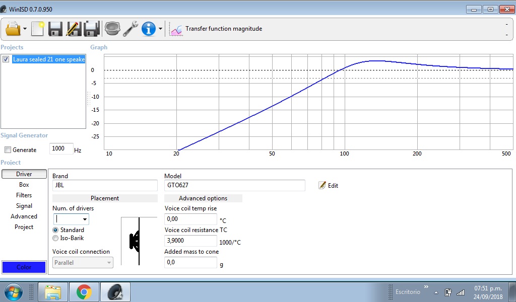

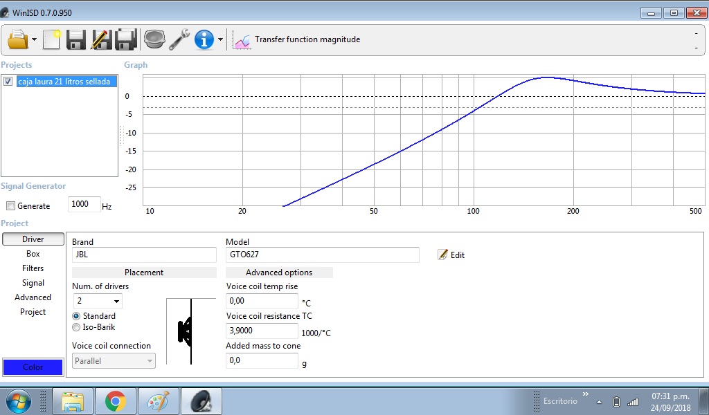

Attached sim Win ISD of the modification
The peak above the line of 0 db is because the box of 21 liters is too small for 2 speakers, as you can see with a single speaker is flatter.
Can be reduced electronically, with a capacitor? Does anyone know how to calculate it ?

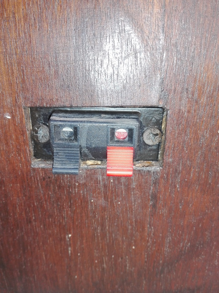

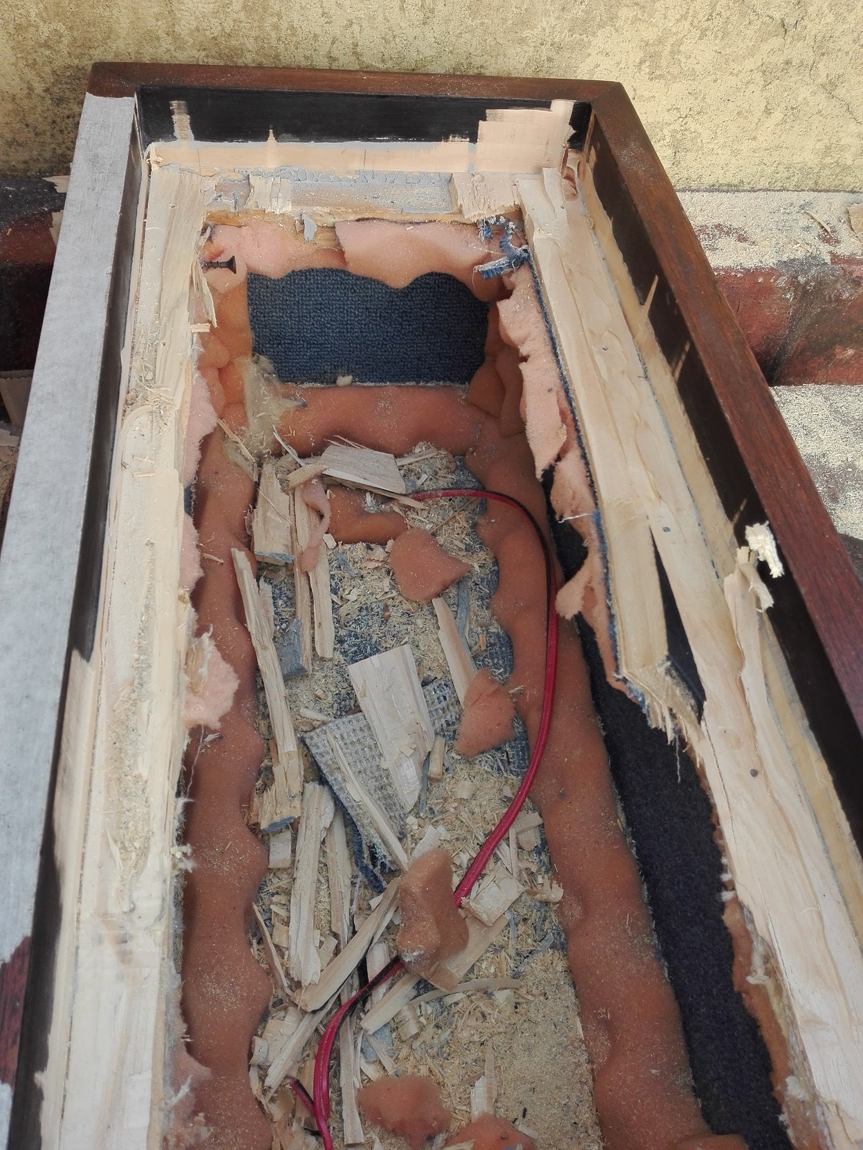

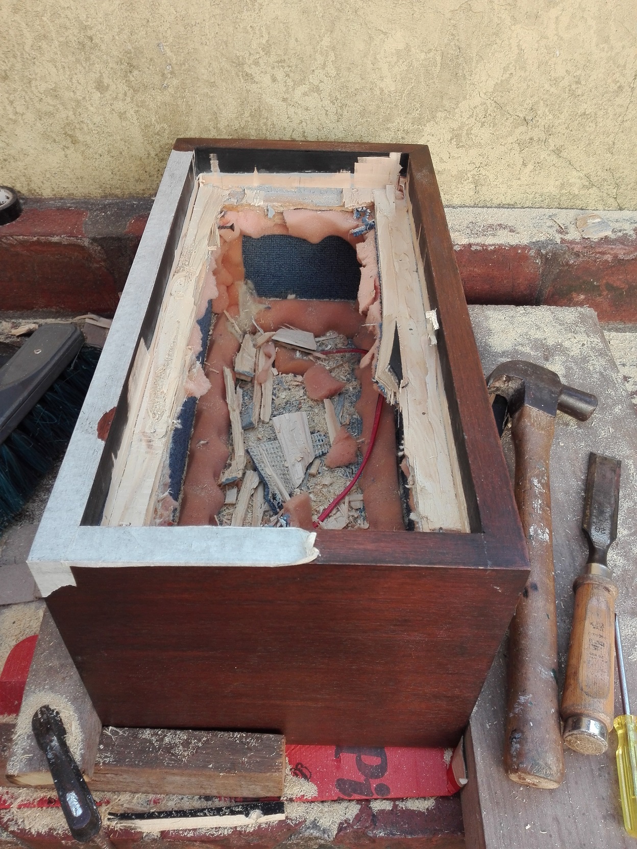

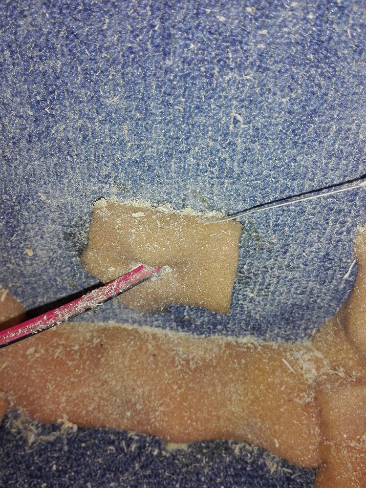

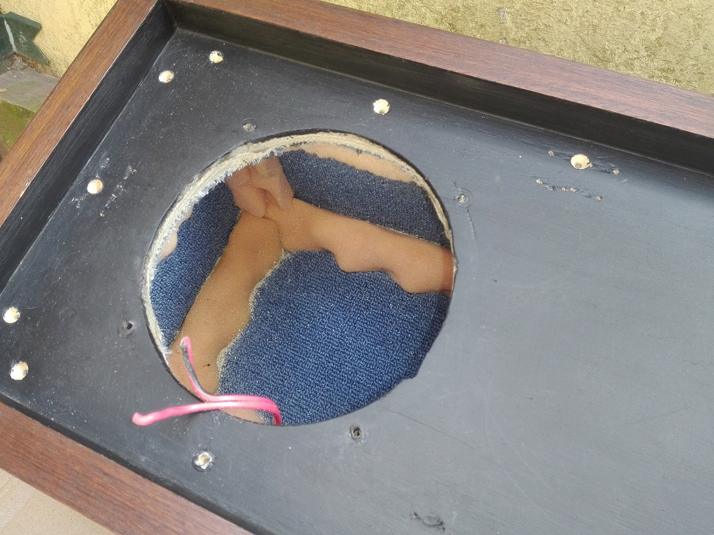

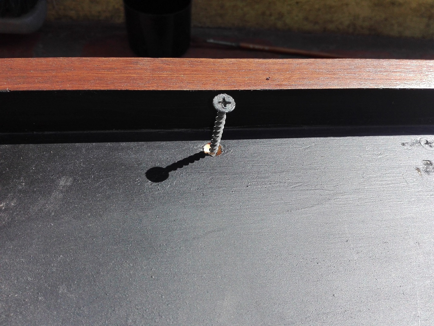

More photos.
I did not remember having built this box so strong ! 🙂

......the rest ...😉
Now I have to build the front panels and make the holes for the speakers ... this will be more scientific, you have to take measurements, breaking is easy !
Any suggestions?
The speaker GTO627 is a 2-way coaxial, has a built-in crossover that is calculated for a crossing much higher than the peak that I would like to attenuate, between 120 and 300 hz
I've been studying this but I can not clarify things ...
