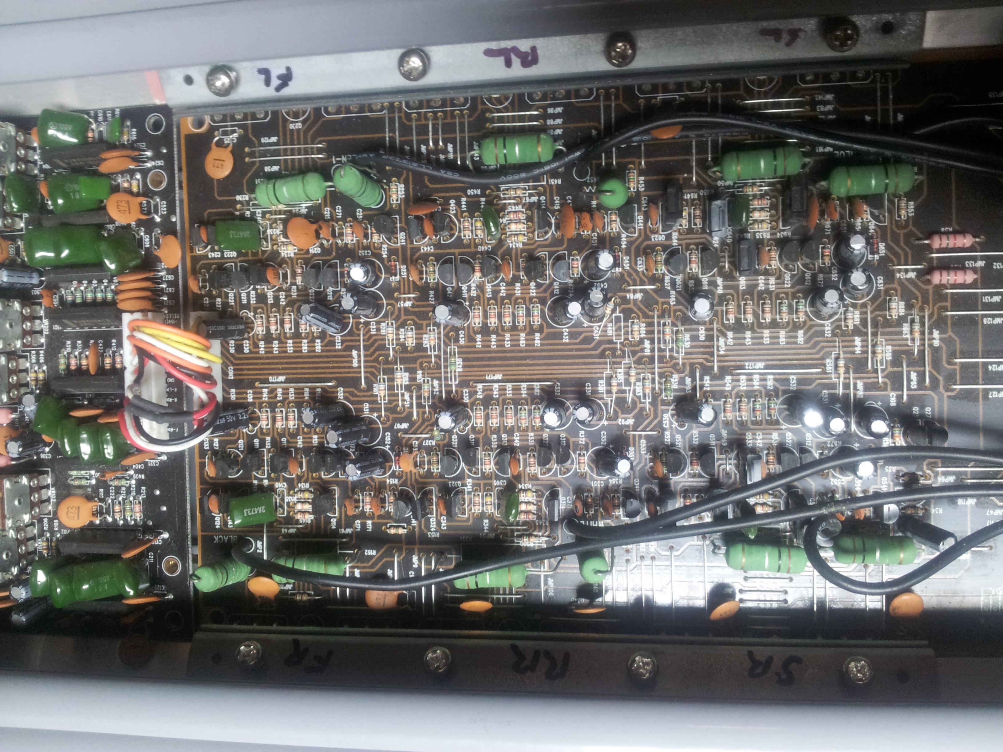

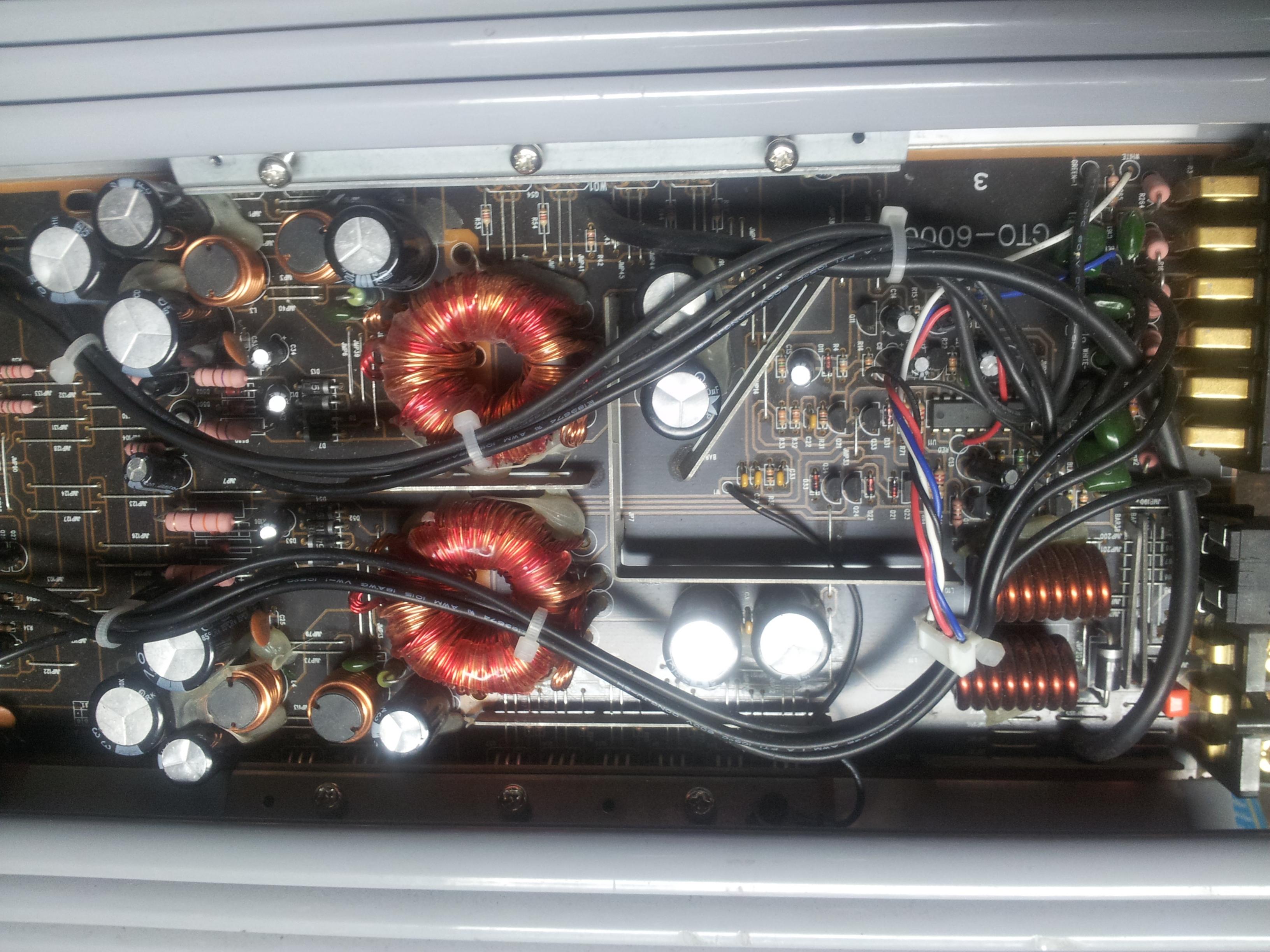

Hi guys.
I have picked up the above amp from a friend with a stereo install shop. Their tech guy has had a look and passed it on.
It already has a pair of outputs removed, but it flashes in and out of protect.
A quick bit of diagnostics shows that another channel is fried as well. I have now removed all 4 outputs on the rear channel and now it is stable on both the front and sub channels.
This amp has different outputs on the sub channel. It has Tip35/36 on the subs and B688/ D718 on the other 3 channels (4th channel is already gone so unsure of outputs there, but i think we can assume it was also B688/ D718).

QUESTION
My question is, I have some Tip35/36. Can i use them in the rear channel?
If I use the Tip35/36 for the sub and the rear channel, should I use them for the front channel as well?
regards Jack.
Just seen a resistor pulled out as well. have to put that back in too.

![20130414_200300[1].jpg 20130414_200300[1].jpg](https://www.diyaudio.com/community/data/attachments/306/306235-ea118d1e9ca255f044d00d9783a36032.jpg)
![20130414_200705[1].jpg 20130414_200705[1].jpg](https://www.diyaudio.com/community/data/attachments/306/306277-ced1f6a1462b2b15bedf57b8c9c2802c.jpg)
![20130414_200644[1].jpg 20130414_200644[1].jpg](https://www.diyaudio.com/community/data/attachments/306/306308-75160b2209059c2a2510dbc0a5815597.jpg)
In some amps, you have to modify the bias circuit when you go from the 2S transistors to the TIP transistors. In this amp, it appears that they use the same circuit (from a quick look at it) so you may be able to use the TIPs in the rear channel.
