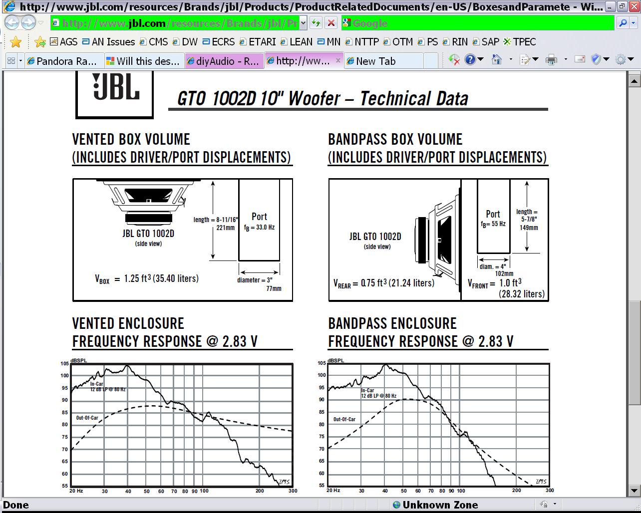

Thank you. I'm holding now a sharp sm7700bk home amplifier with recommended preamplifier. I'm thinking to wire this driver in series for now till I can purchase a new amplifier. It is for home. I can do a bandpass enclosure, it is powerful. I need a low pass frequencies filter, right? Sorry for my English.

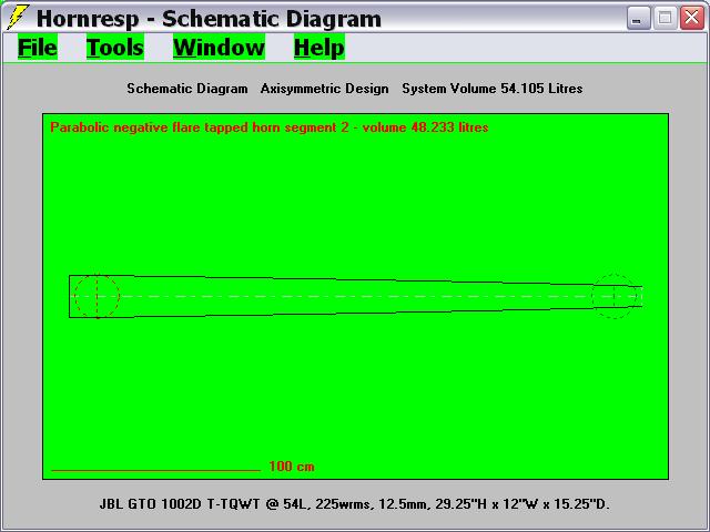

Got it.Yor are saying that this driver is good for a QWTL enclosure,but i can't design it.Can you?If you can,please design it and write all sizes,I would be grateful.If you can't design it,can i make an enclosure with port made by myself?I mean, someting like this (i can't find the right word for it: /http://194.88.148.41/?mmid=07e3a4a64e18f52d0 .
bjorno is very good with those, maybe he can help you. 😀
I can only look at his projects and appreciate (from an aesthetic point of view) or do the simulations with other software (like the one linked on post #7). I know bjorno uses very respectful calculations by Martin J. King. I don't have that much experience as I told you but I will help in what I can. After you get the right kind (right size) of measures (wavelength) for your driver/speaker it does not look very difficult, just go with the flow. 😱
Quarter Wavelength Loudspeaker Design
http://www.quarter-wave.com/TLs/Alignment_Tables.pdf

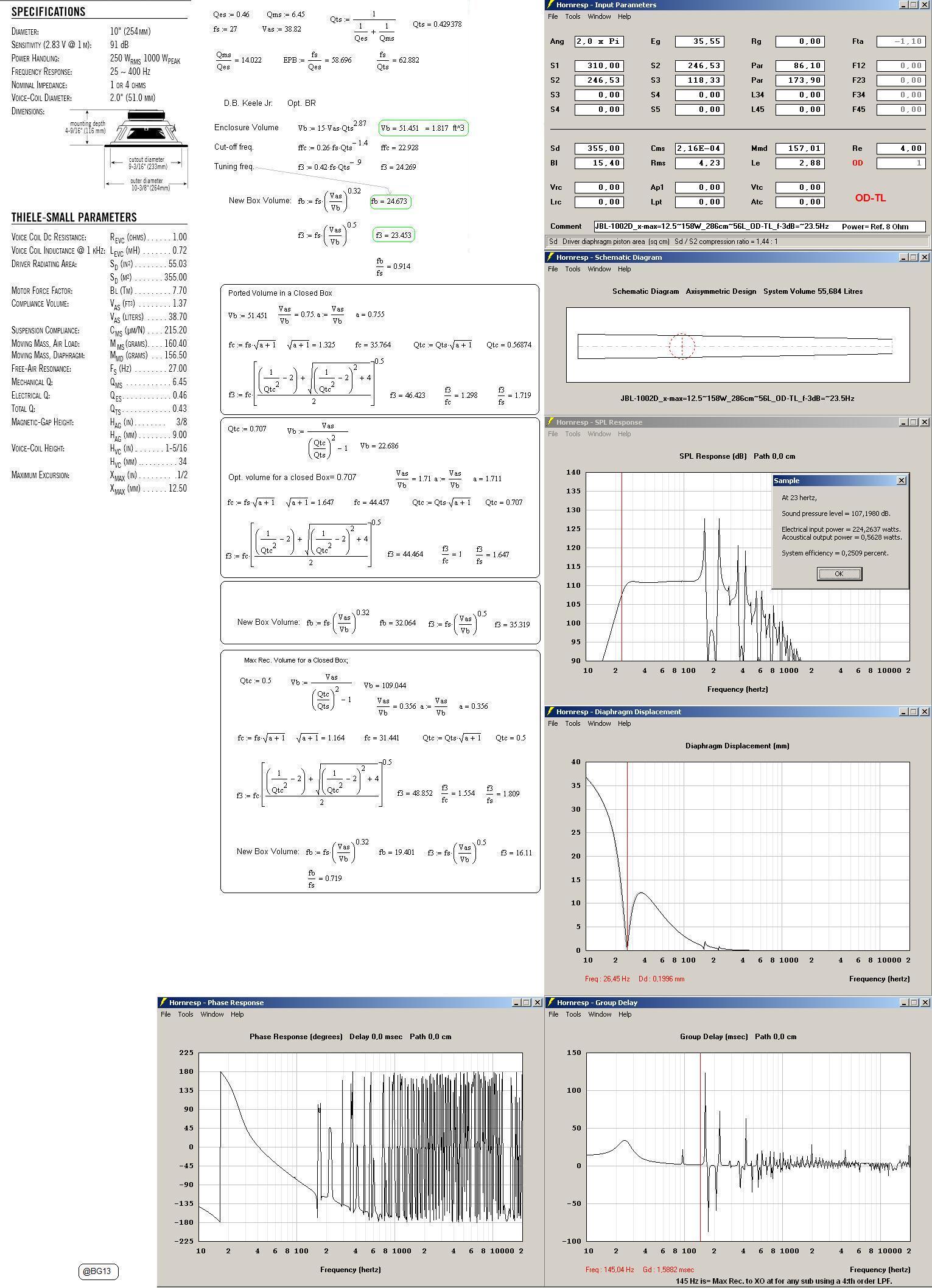

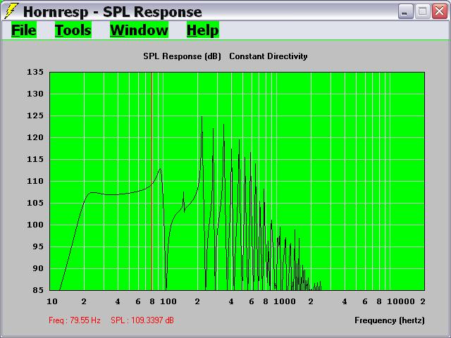

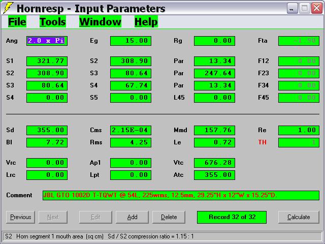

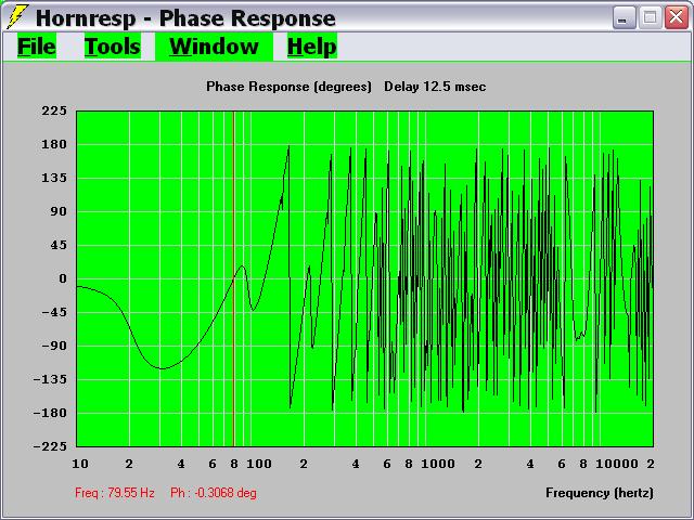

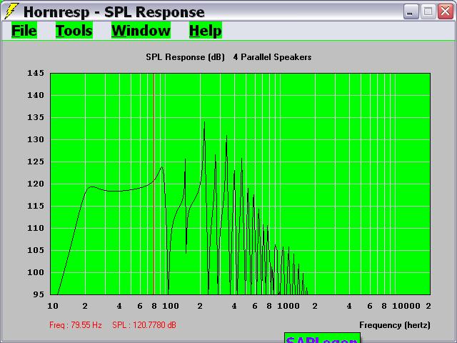

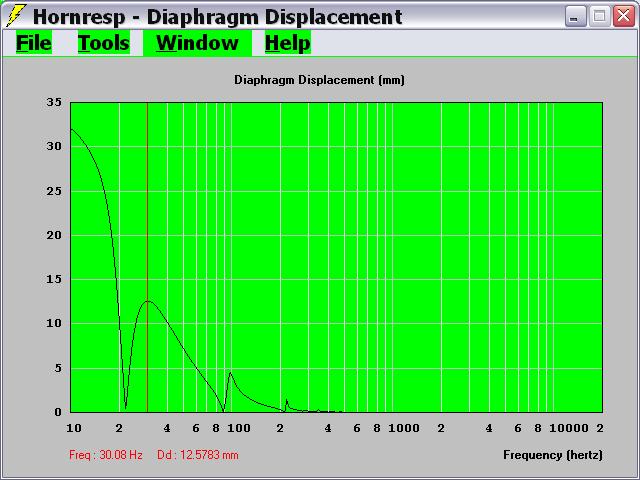

21hz T-TQWT, good for 225 watts @ 1 ohm @ 12.5mm xmax, 29.25" H x 15.25" D x 12" W enclosure.
