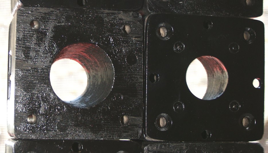

Art, Many thanks for the offer. Unfortunately, although I'm logged in, I don't see any "PM" icon that I can use. Worse than that, I don't have access to a digital camera. All I can say is that the three horns I have all measure 3.5 inches between the centres of the mounting holes, whereas the D2 driver measures 3.5 inches between the far edges of the mounting holes and 3.25 inches/82.5 mm between the centres.
Simply highlight the name of the person you'd like to message, "private message" is the second option on the pull down menu.
For the difference of 3.25" to 3.5" on center, a few minutes of filing with a 1/4" rat tail file would get your horns to fit with the drivers, and eliminate the extra depth of an adapter.
