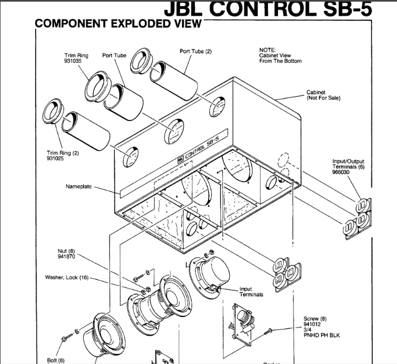

Doesn't the SB-5 use 5" drivers...?
Looks like it uses four of them in a triple chamber isobaric 6th order bandpass. Not sure what was the thinking behind that, because the bandpass should provide decent acoustic filtering anyway.

If your drivers have the same bolt pattern as the JBL C5003 ( 6.625″/168mm diameter) you could "throw them in", wiring the inner pair the opposite polarity as the outer. If the bolt pattern does not match, you will need a right angle drill.Can I throw in any four (matched) drivers and adjust the port tuning accordingly?
As JBL says "The SB-5 has a frequency response hump at 80Hz and falls rapidly below that".
The SB-5 is at least -10dB at 45Hz compared to it's output at 80Hz, and below 45Hz drops like a rock.
Hardly an octave of range, but tuning the outer chambers lower (lengthening the ports) would reduce the low frequency output even more.
