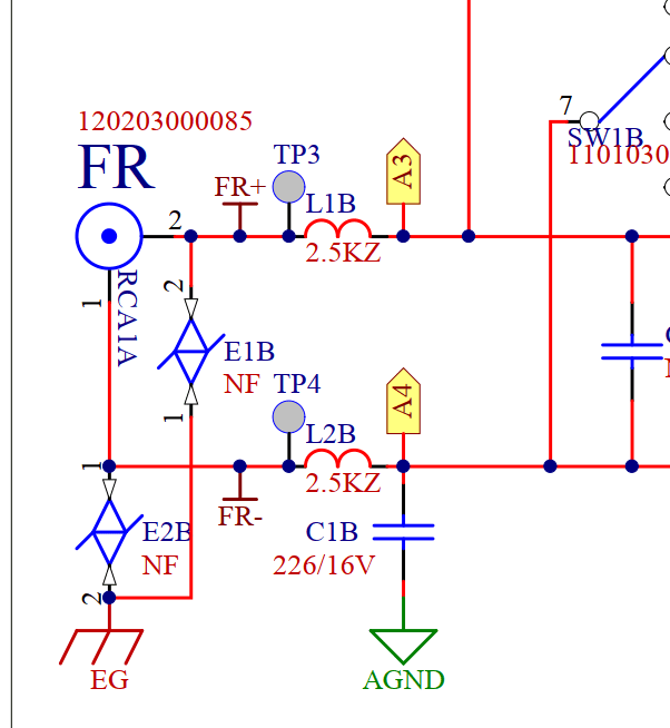

I an looking for the diagram for this amp. Have components burnt and need to know the values Should anyone know the values please could you let know what they are.
thanks
You may have to measure the value of the ones that survived for a definitive answer.
The service manual only gives the following information. They are not listed on the parts list in the manual I found.
They may be something like a 2.5uH, 10% tolerance (Z?).
This damage may have been caused by either a shorted transformer or a bridging speaker wire shorting to ground.

Bridging isn't a problem. I specifically mentioned the bridging terminals because those are the ones with signal on them.
For damage to occur, one of the bridging terminals has to touch to ground. A transformer shorted primary to secondary is another common reason for components like these to burn.
