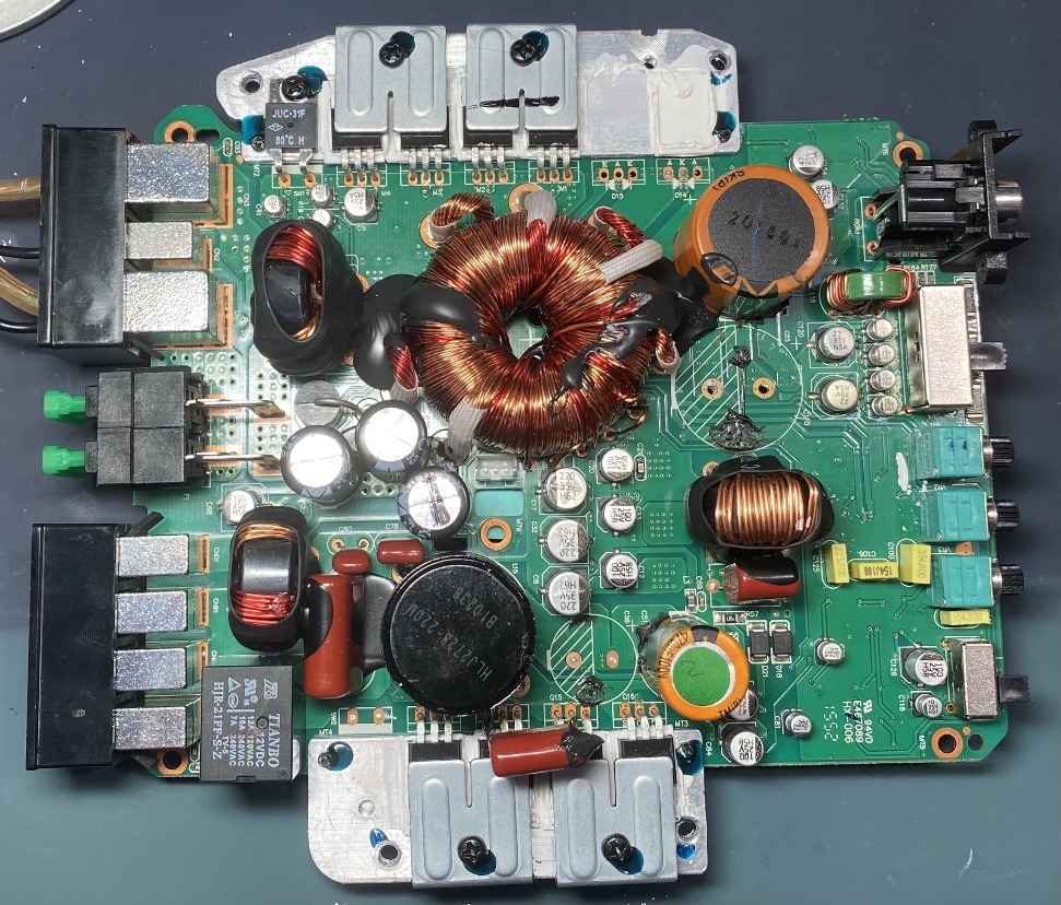

JBL Club 5501 blown negative rail caps
This is a new one for me, the 470uf 100v and 2200uf 80v caps for the negative rail vented.
I've read this can be caused by bad drive but am unsure if that'd be in the PS or output section.
Right now I have the rectifiers and vented caps removed, no other changes. How would you go about fixing this one?

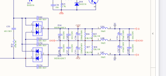

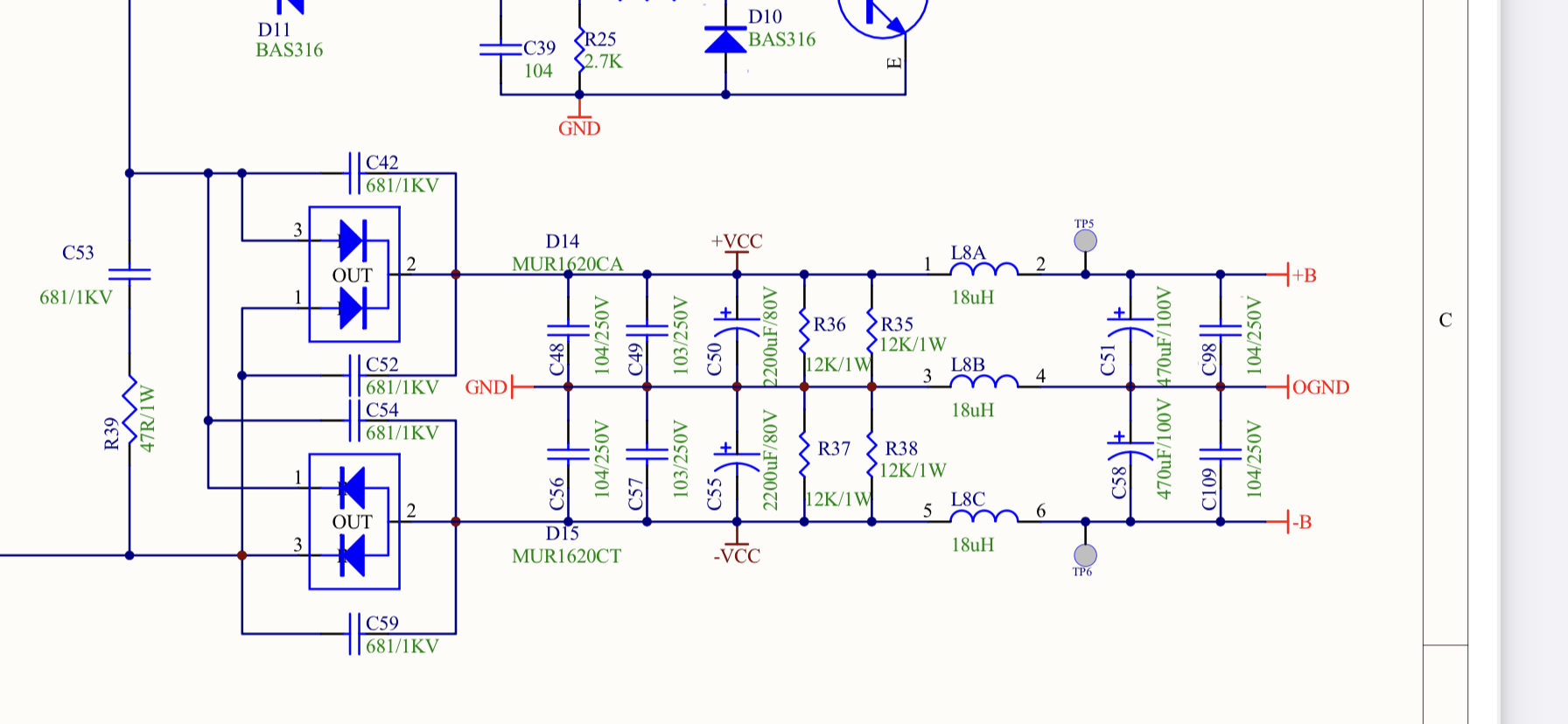

C55 and C58
Edit:
Just saw your edit. I'll see what I have on hand that's close to the original parts.

Decided to just give it a go.
Changes:
2x 1000uf 80v caps installed in place of the vented caps.
Rectifiers reinstalled
The caps don't seem to be getting hot but I didn't run it for very long, just enough to probe the output gates and measure rail voltage.
Both rails are sitting around 50v dc, within a few 1/10s of a volt of each other.
There's an issue with the output section drive I'll need to sort out before continuing. Faint clicking buzz from the board and a dc pulse on the output gates.
I'll report back with my results of your 3rd step after getting the output drive sorted.
