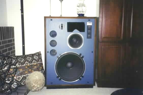

In the course of tuning my vintage JBL 4345 monitor project I got some recent friendly assistance from JBL legend Greg Timbers.
I'm a member of the Lansing heritage Forum and have been slowly piecing together all the original parts for the classic 4345 (4) way monitor.
One of the biggest hurdles was determining the box tuning of the original design. I tried to calculate it based on T/L tables and software simulations but could not get the woofer system to sound right and integrate correctly with the mid and high end.
The catalogued specs refer to a 9 cubic foot box, ported by 3 circular openings with full power to 32hertz. No reference is give to the box tuning and after attempting calculation of the Fb from the T/L tables from the driver QTS it became clear that there were just too many unknowns for me to replicate the response of the original design.
I had the volume right, with 3 4" ports about 8.5 inches long for an educated Fb of 28 hertz, 1 inch of fibre glass on 3 internal surfaces, but it sounded strange, sort of underdamped.
Anyway I quickly emailed JBLPro.com requesting details of the 4345 tuning, choke DCR (this effects the system QTS ), box losses etc so I could hit the target tuning.
Within a day I received a very comprehensive account of the system tuning from Greg Timbers, the original design engineer for all the JBL 43xx series monitors.
I made two incorrect assumptions, firstly I did not account for the virtual volume introduced by the fibreglass damping. The effect of this is the fibre glass lining adds volume equivelant to the bacing and the backside of the woofer, about 1.5 - 2.00 cu ft. This means the woofer is really looking into about 10.5 cu ft, a 15 % increase in the dimensioned box size of 9 cu feet. As a consequence my calculations were out of wack.
Secondly, the dcr of the choke in the original design was 0.5 ohms. My choke was 0.2 ohms. apparently JBL could not afford low dcr in these large chokes (5.4 mh) in production. The effect on the QTS of the driver (0.27) is to raise the total system QTS to near 0.292.
The only alteration I had to make was adding a 0.3 ohm resisters in series with my choke in the woofer low pass network.
The result is magic, the bass is brilliant, accurate , extended and effortless from thr 18" JBL 2245 driver.
Here is a mint example of the design I am aiming for, this particular pair is actually up for sale on the Lansing Heritage classifieds if any one is interested.
