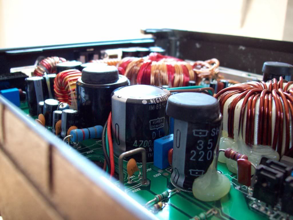

a bit more back ground i just bought this amp and a jbl b80.4 for 130 for both of them locally through craigs list. now i tock the cover off the 600.1 and noticed the clamps to clamp the transistors to the heat sink were lose i tightened all of them and put it back to gether and it worked fine but that one problem i mentioned. Also it was mounted on the enclosure but was only on it for about 45 min. it was on a 1.25CF sealed box powering a audiobahn AW1200Q if that means anything.
No broken transistor legs but i found the top of one capcitor swelled could this be a porblem?
also what does 55MV stand for for the power rating? would a 55V work or no?
Push down on the top. If it goes down and pops back up, the cap is probably OK. If you're still concerned, you can cut the plastic top off to see if the cap has vented.

There is a service bulletin about a similar issue concerning the BP300, 600, and 1200 amplifiers.
And what it says is that the amp is working correctly, and protecting itself. There is a service mod to decrease the safety margin of the amp and therefore relieve the cut out issue somewhat BUT taken with a grain of salt and wisdom you will be pushing the amp closer to self destruction. IMO I would buy a much bigger amp.
JBL says the mod makes the amp accept a higher level of "CLIPPING" so it will not cut off. If this is your issue and it sounds like it, then you are probably unaware of the amp being "Clipped" again I would buy a bigger amp and sell the BP-600 while its still worth something. This mod is described as " for those customers that insist on operating there equipment in the Hazardous Zone ."
