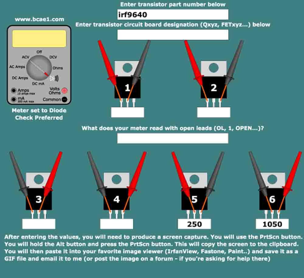

the IRF9640 i have 6 of these in total (on one side) and i replaced all of them with ones from MCM and im getting 1200-1350 on diode check with the leads like #5. i pulled one from the other side and i found the measuring with probes like on image #5 i got 250. but if i put the probes in different configurations then they seem to act like opening doors and closing doors just like the BCAE1 website says. i cant get the other "new" IRF9640s to do replicate this
i put up a picture of the FET that i suspect is good i can get it to read 250 but if i start moving the meter around and open and closing the transistor then the same #5 test jumps from 250 to 865.
from what i have read it should be around .6 im wondering if 250 is .25
im still a little unclear how to test these things. but im reading the BCAE1 website as much as possible

On page 97, read the section labeled Checking Field Effect Transistors.
You have to perform the tests in the proper order. If you go out of order, you must start over. The test shows the procedure for an N-channel FET. Reverse the leads in your meter to test the P-channel IRF9640.
The P-channel may read as high as ~0.800 where the graphic shows a reading of 0.445.
Don't forget to switch your meter leads back when you finish testing.
If the new (unused) FETs don't read something close to what you read on the one you pulled from the good side, they may be defective.
i have tested the pulled 9640s a 9640 from the other side and a brand new 9640 from a local supplier.
i found 3 of 6 from mcm to be NFG. if i follow the test on page 97 with the leads reversed and i get all "open" readings.
the other 3 seem to pass and i get .96 and 2x .98. on the last test with the red on the right and the black in the center.
the one from the other side of the board measured at .755
the completely new unused one from local store measures at .85
i seem to be getting pretty different results from most all of them. is it normal to get defective ones? is it a common practice to test before putting them in? what test should i use to check the IRF640S are these just normal N-channel FETs? or should i keep the leads revesed? and what number should i be looking for when testing them?
0.9+ is high. The ones reading 0.85 and lower are probably OK (especially if they read as open when checking from 1-2 on ohms).
