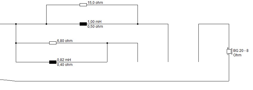

Visaton BG20Isn´t it possible to "silence" the speaker, bring it down a bit? I remember reading it somewhere.

Use the conjugate 2. on the picture (top) with 1mH inductor and 15 Ohms resistor.
You can use intermediaries like circuit 1. in the bottom.
You can read here to understand.
Thanks again.
BG20:s are now in open baffle with alpha15, both without filters. I´ll try your thing, as soon I get the list of all components I need ready and order out.
