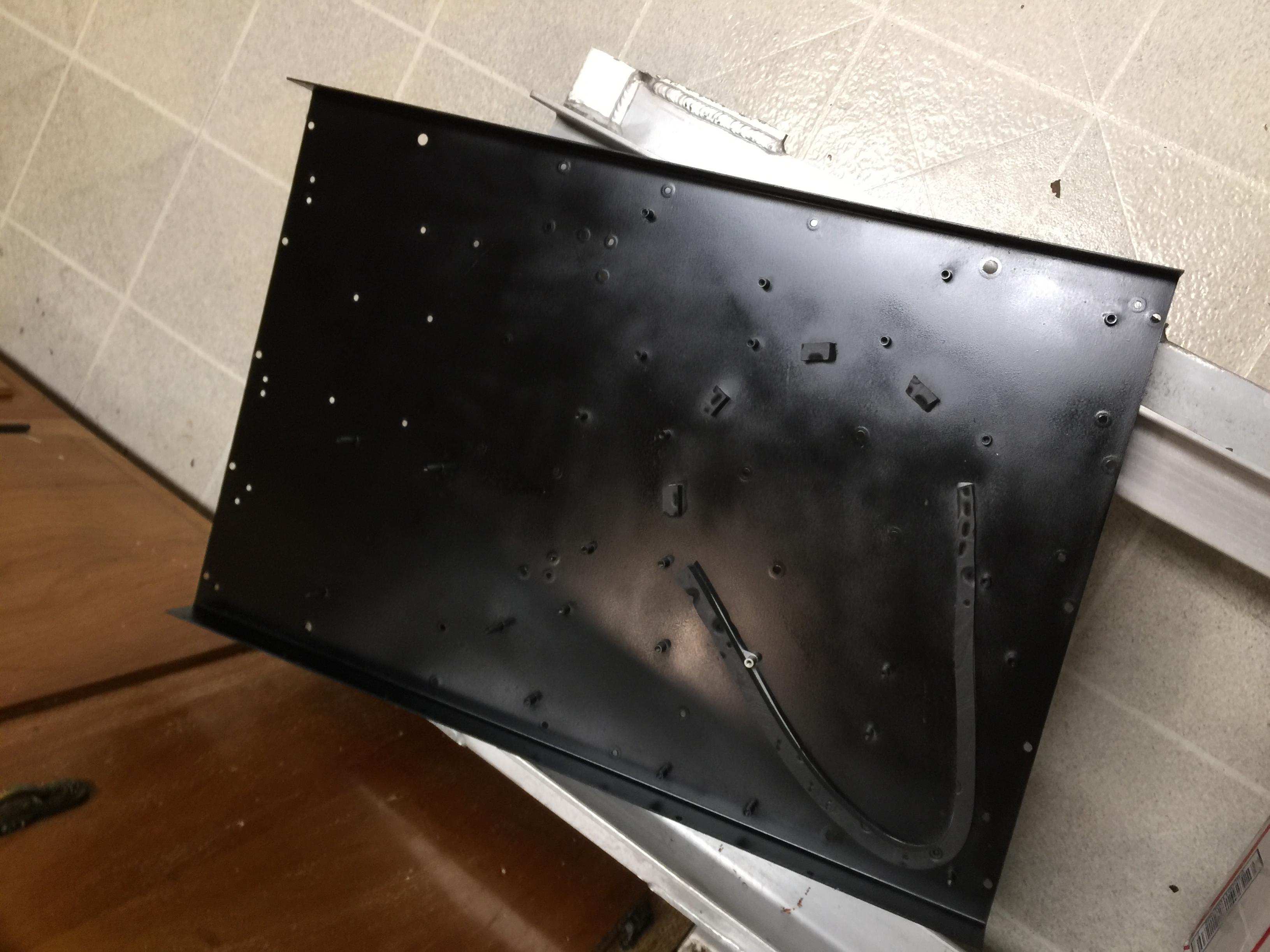

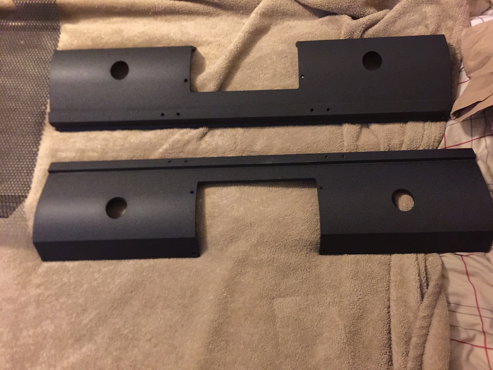

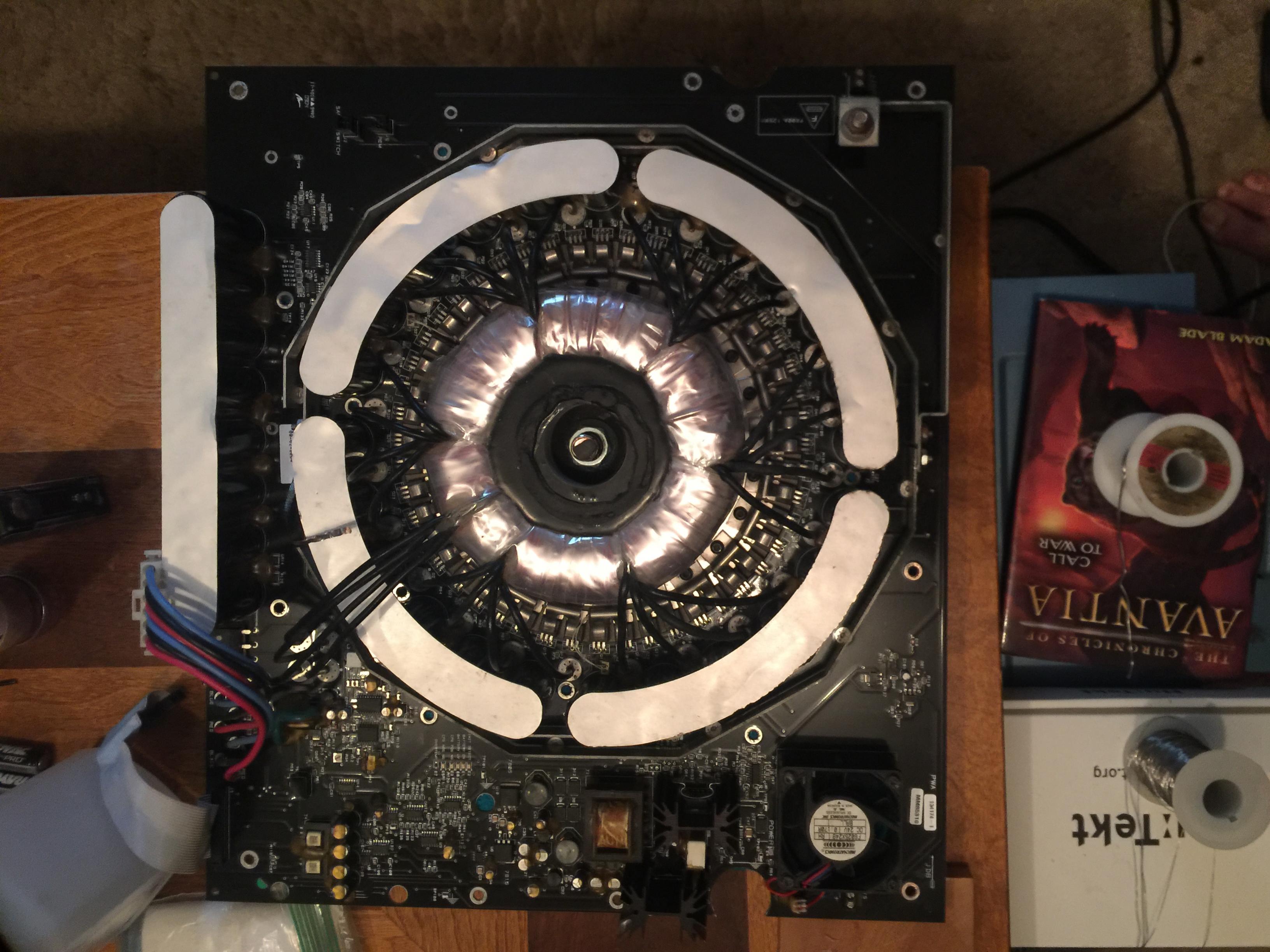

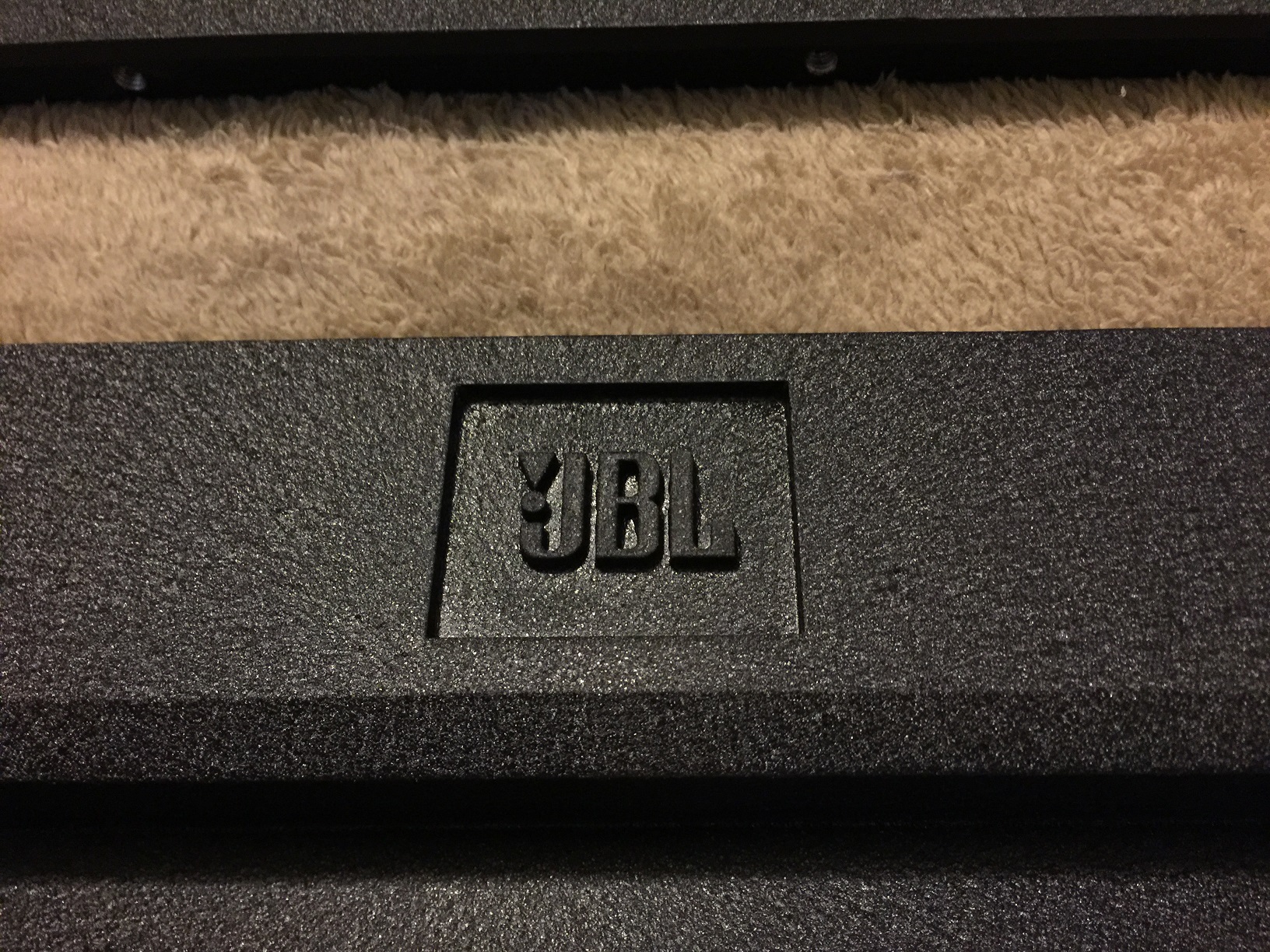

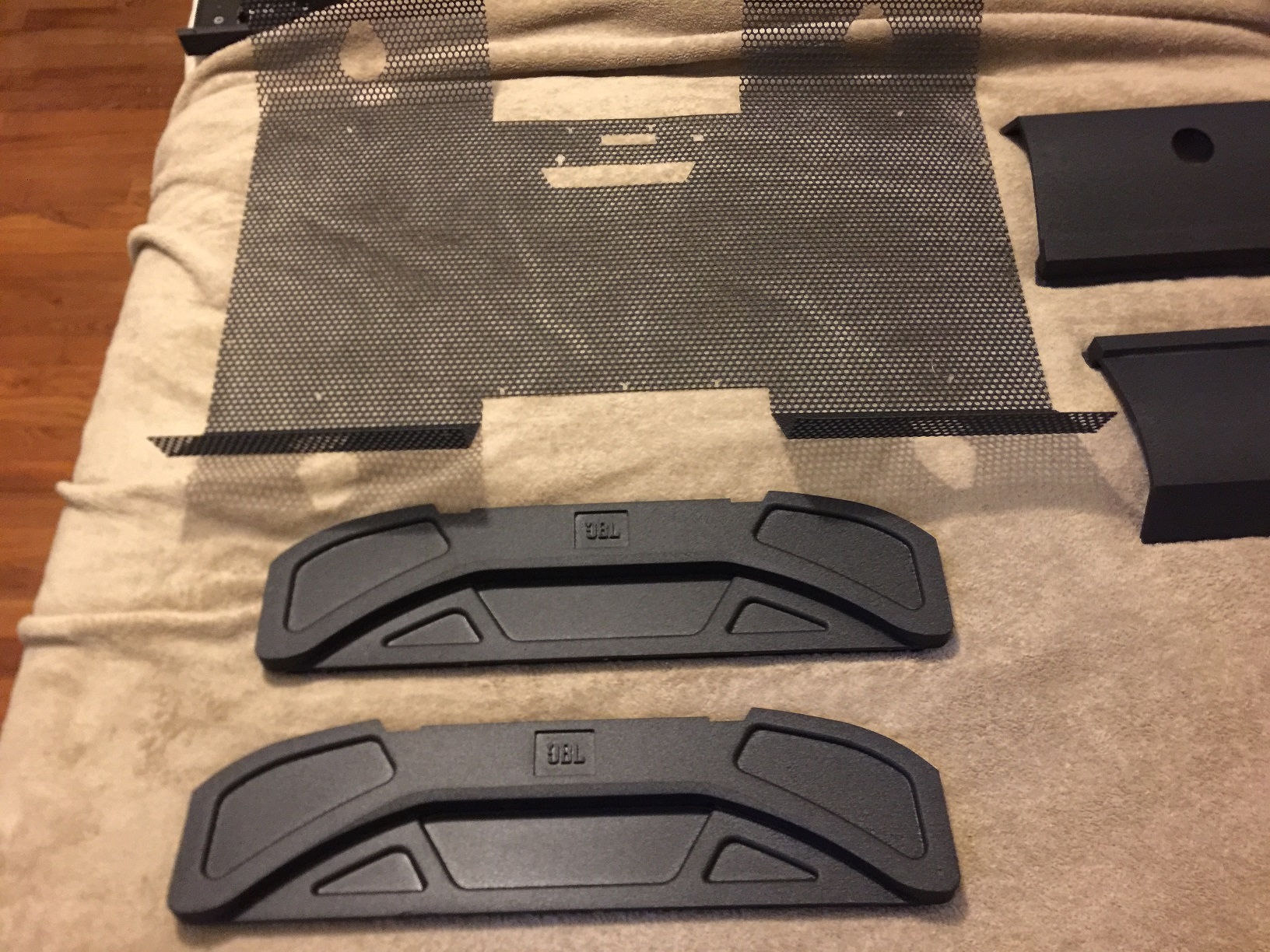

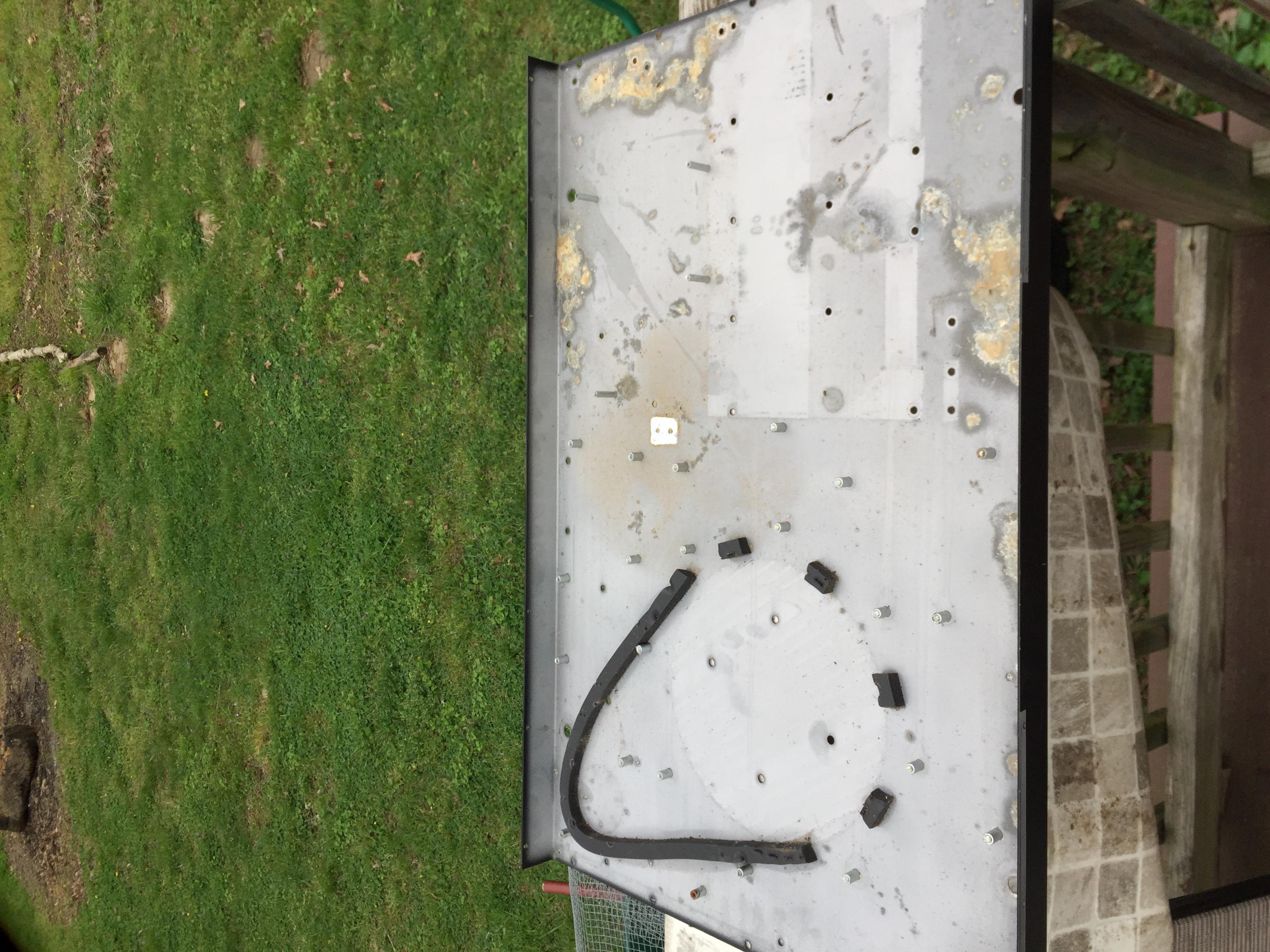

Yummy chassis parts finally came back from the machine shop, shout out to Chip at Ship Point Machine for doing an outstanding job as usual. The original parts were a flat/semi black sorta thing, I think they look pretty sexy powdercoated in wrinkle black.

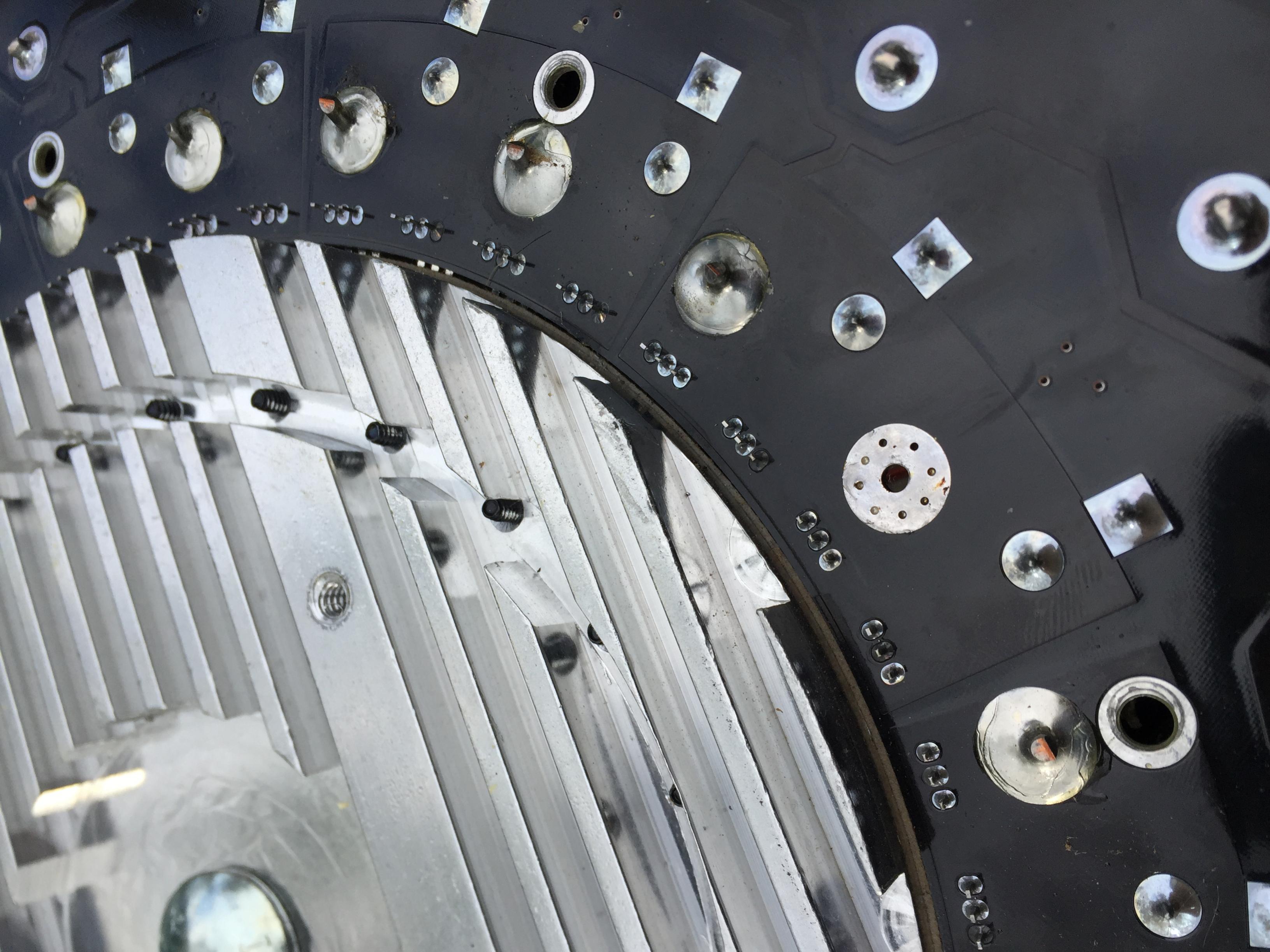

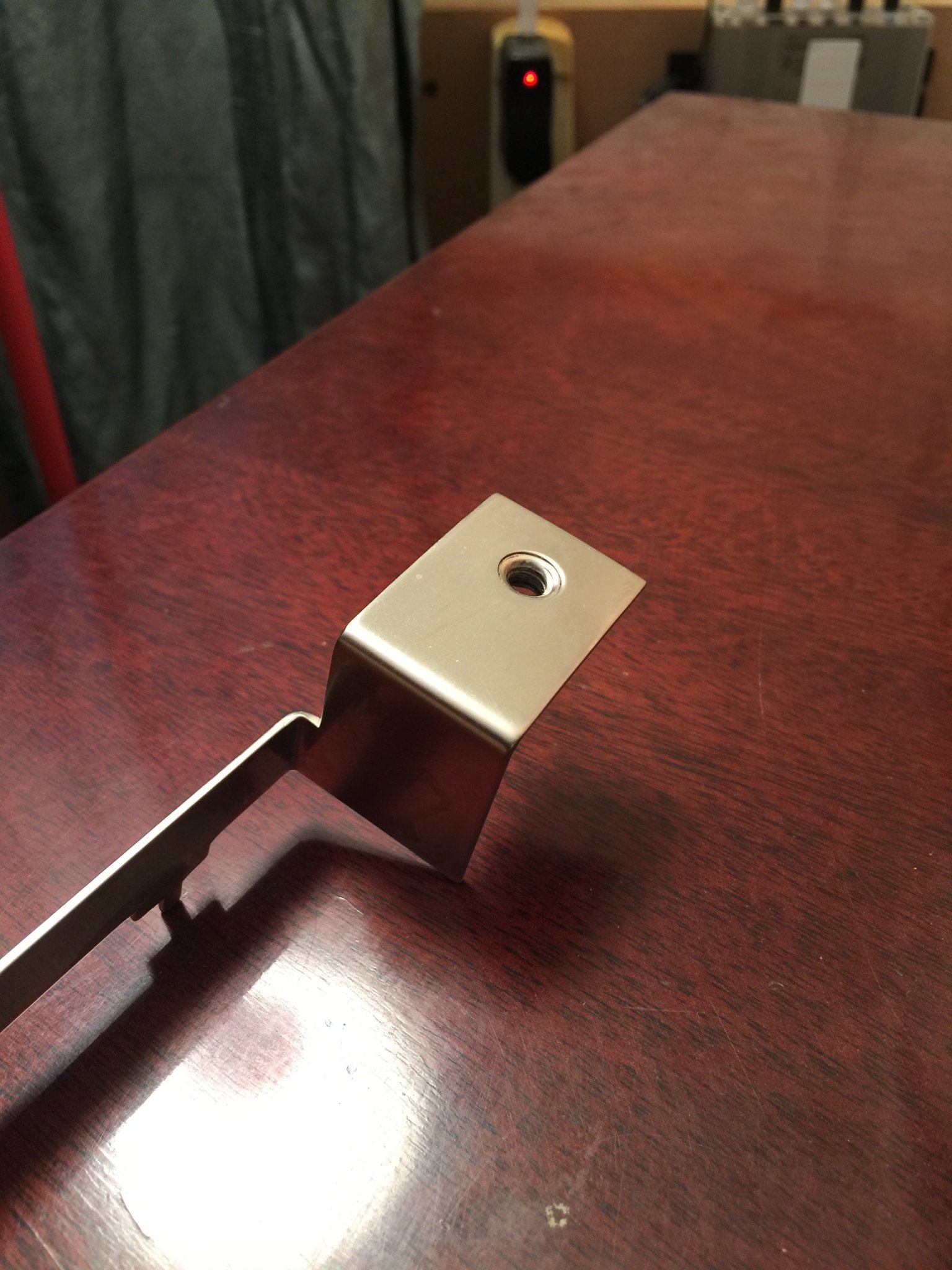

Long overdue update: I was finally able to locate a plating outfit who were willing to take on my dilapidated bussbars, shout out to Metro plating and polishing in Kensington for your invaluable service. They stripped off all the old plating, which was tin, then electroplated fresh nickel in its place which will hopefully stop any potential corrosion in its tracks. I will likely need to sand the bottom tips to expose the copper so I can solder them back into the board, but once that’s done I will touch up any exposed areas with a sealer to prevent any moisture intrusion. I really like how they look now, much brighter than they used to be.
