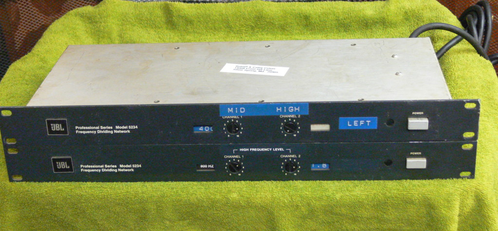

For Sale -- JBL, Model 5234, Professional Series Frequency Dividing Network (two units)
These are two channel crossover networks that are set at 400Hz and 1.6kHz crossover points, 18dB/octave. This creates a pair (left - right) of three way audio channels bass to 400 Hz, Mid 400 to 1600 Hz, and high above 1600 Hz.
Removed from service into storage, excellent condition, NOT TESTED
If you are interested contact - Bobcul@nospam.locul.com to discuss the particulars
