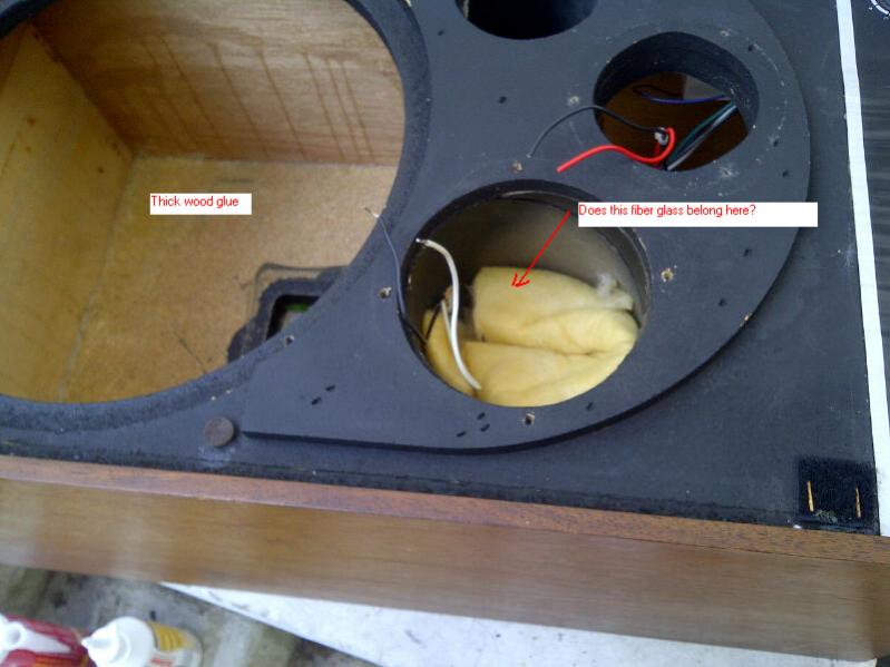

Hello,
I'm installing new X-overs (JBL L100 Century) for the 4310 and will be adding bracing and redoing damping in the process.
Question: After opening the speaker and removing the drivers, I found fiberglass behind the mid-driver. Is this normal, what JBL did? Or did someone add it along the way?
If it's a good thing.. do I just leave it there?
For the damping, I'm planning 2mm bitum + 4cm corregated foam..
I have enough foam to replace the fiberglass behind the mid-driver if that's better.
As you can tell this is my first upgrade to speakers. My experience is building a couple guitar amps, and rebuilding a tube hifi amp.
Thanks for the advice, Paul

The damping is for the midrange driver that's probably open backed. It probably won't hurt anything to experiment with upgrading it if you're upgrading all of it anyway.
Yes leave it. The reflected waves can make the mids sound boxy. The fiberglass helps to reduce that. If you notice anything boxy about the mids you can add some more. Maybe use a polyester fill over top of the fiberglass to prevent the old fiberglass dust from getting near the coil.
fiberglass is pretty good at damping, but it is better for bass. I would leave the fiberglass since there is not a lot of it and fill the cavity with loosely with long hair wool (madisound) which is going to have the greater effect on the upper frequencies ...foam would change the volume of the chamber and has no real sound absorbtion properties except at extreme high frequency.
Corrogated Foam is used more as a diffuser externally (for the most part foam is marketing hype in regards to absorbing sound)- we line our walls with fiberglass in our recording studio, cover by open weave burlap)...it is never used in speakers. . .You want to dampen the chamber so that the soundwaves do not reflect back into the cone . . .If you are happy with the midrange- don't fix what is not broke. JBL are very good designers. A lot of thought went into that speaker system...check out Lansing Heritage.
I am not saying it sounds good ( I never heard one ).
You should not be using a crossover from a different speaker system, and that is what it is a system. The crossover is interacting with the impedance curves and frequency response of the drivers and the effect the cabinet is having on the impedance curves.

you will realize the greatest benefit with good poly caps (not that Bennic and Dayton junk)
If you brace the cabinet you will change the volume and tuning if it is a "bass reflex" and may lose some intended reveberation (boom) . . .

Thanks for the comments. I'll leave the fiberglass as is, and btw, the cylinder enclosure is closed on the bottom.
Erickalan77, The new X-over kit (I got) is specifically designed for the 4310. (It's just on the L100 page.)

Understand the bracing comment, however Troels recommends it - and I would like less boomy bass. That change could be reversible but with considerable more trouble.. Hoping for the best.. as am half way done with it now..

Hello...Fiberglass is very dense and uniform. It can be used in sheet form. I have been using 1 1/2 myself this week the first few 6 inches from the baffle along the perpendicular walls to reduce reflections back into the cone. but for fill I use wool as I cannot get the density and uniformity of glass. It would not be practical to line a wall with wool as you can not get it in that fashion. Wool is ultimately better than glass in a stuffing scenario. Wool is better for some reasons pertaining to transfering the "soundwaves to heat"....The sound waves lose their energy exciting the wool and glass... Wool has more mass than glass and is softer so it is better...I have raw wool (unprocessed except that it was washed) pretty dense in that form.

Ok.. now I'm getting worried..
I spent my Sunday adding braces to one speaker. (In Paris, there is a time difference.)
Here's in my own words, what Troels kit states - adding bracing to rear panel and sides could help sound.. (that's an approximation).
So I did not add braces to what one calls in a guitar amp, the baffle.
The back has ~1"x1" glued and screwed into the corners.
Same was done for the sides, coming towards the baffle but stop about 1/2" before the baffle. Just a few screws were used since access is difficult.. Quite a job!
Am I correct in figuring that foam will increase volume, therefore equalizing the space taken with the braces, or even leaving more volume?
In any case the braces along with caulking are complete for one speaker.
Next will add 2mm bitum (adhesive), and 4cm foam.
I have wool but not a lot. Will cover the new X-over panel with wool, which lies directly behind the bass driver.
Could probably put a little wool in the midrange driver enclosure.
For sure I will test this before proceeding with the 2nd speaker.
Please reassure me that I didn't ruin the thing by not bracing the baffle.
If I did wrong I will correct but recognize will be a big job..

More clarification - apparently what I did is called "edge bracing" and I did not brace the baffle.
