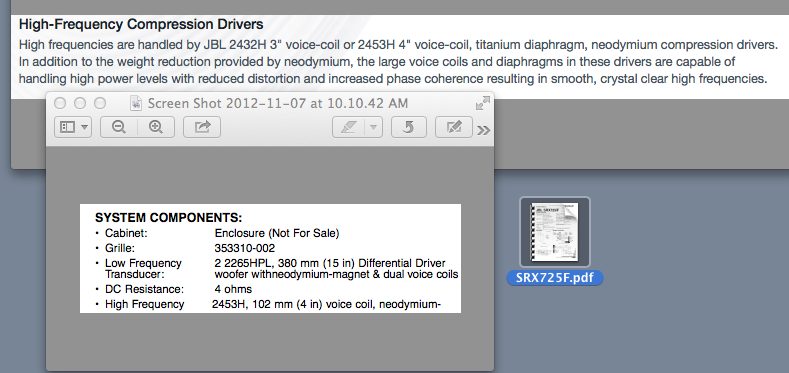

All the info I see on line says the 2453 is a 4" diaphragm, perhaps you are thinking of the 2432. Hard to keep all the JBL#s straight anymore...2447 & the 2453 compression drivers do not "match".

Absolutely correct, as implied in the first post.All the info I see on line says the 2453 is a 4" diaphragm
The 243* are 3"
The 244* are 4"
The 245* are 4" but newer.

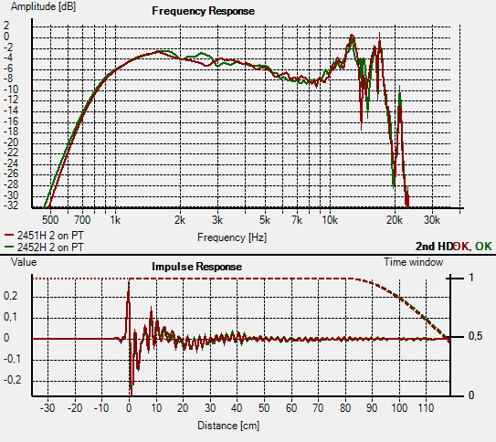

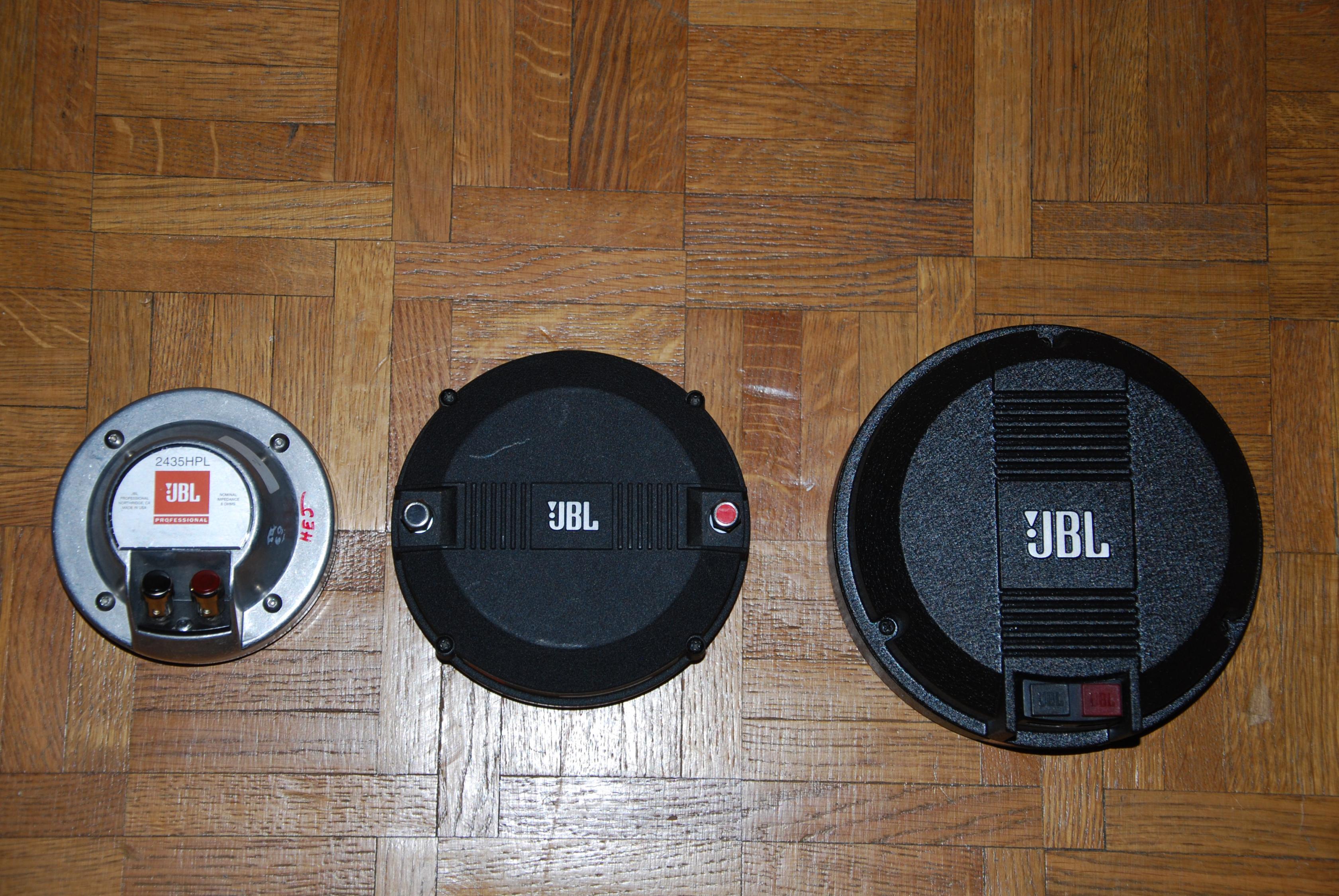

Here are some illustrations:
2435/2452/2450SL
The 2453 should be very similar to the 2452 (same size at least)
Then two 2452/2450SL cores measurements with the same diaphragms installed: Ti ribbed (equivalent to 2452H and 2451H drivers) and Ti SL (equivalent to 2452H-SL and 2450SL drivers).
As you can see the response are very similar across those cores, as long as you use the same diaphragm.
The 2452 core seems to have a little "boost" in the lower part of its range though, maybe due to its smaller backcap.
2435/2452/2450SL

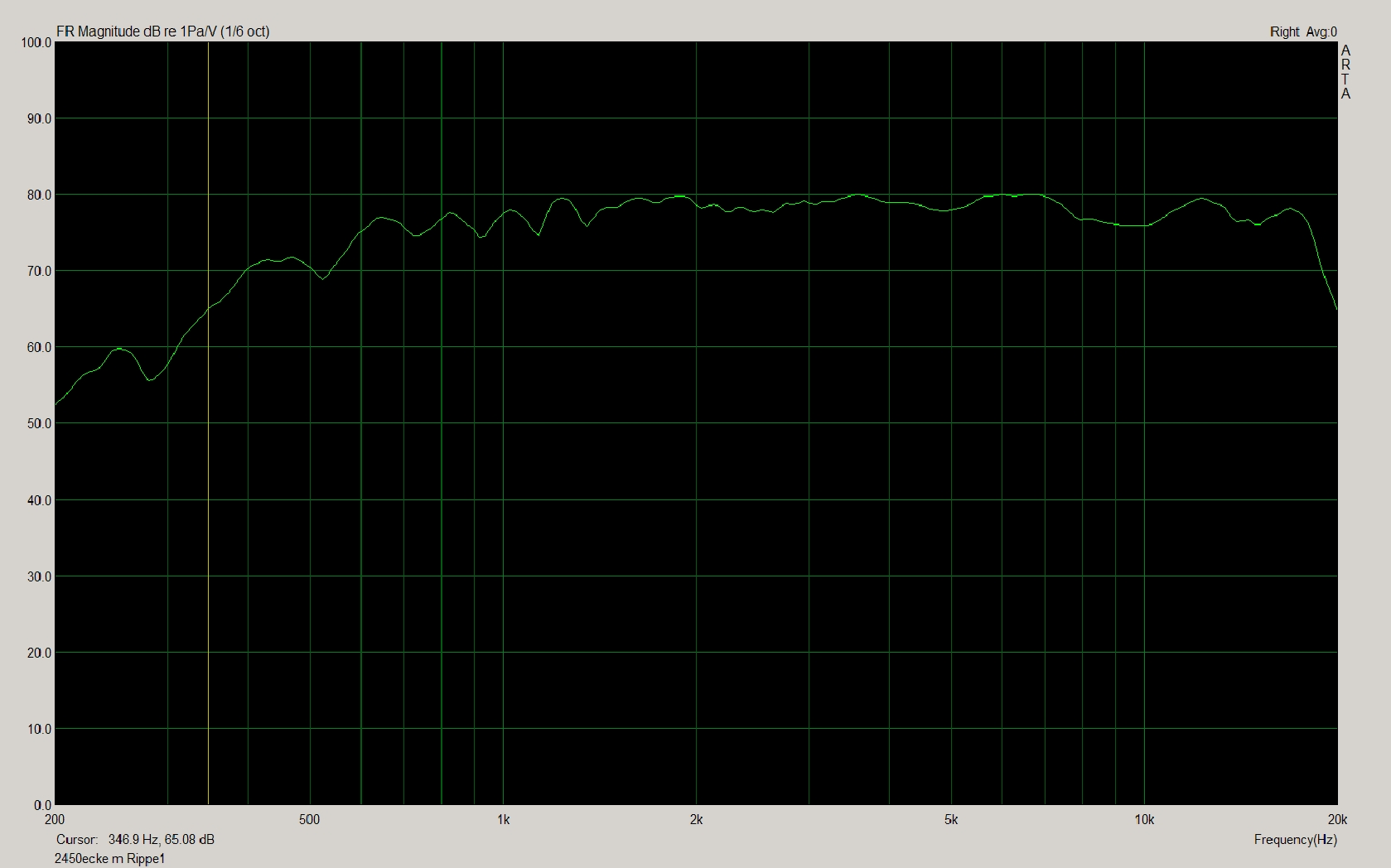

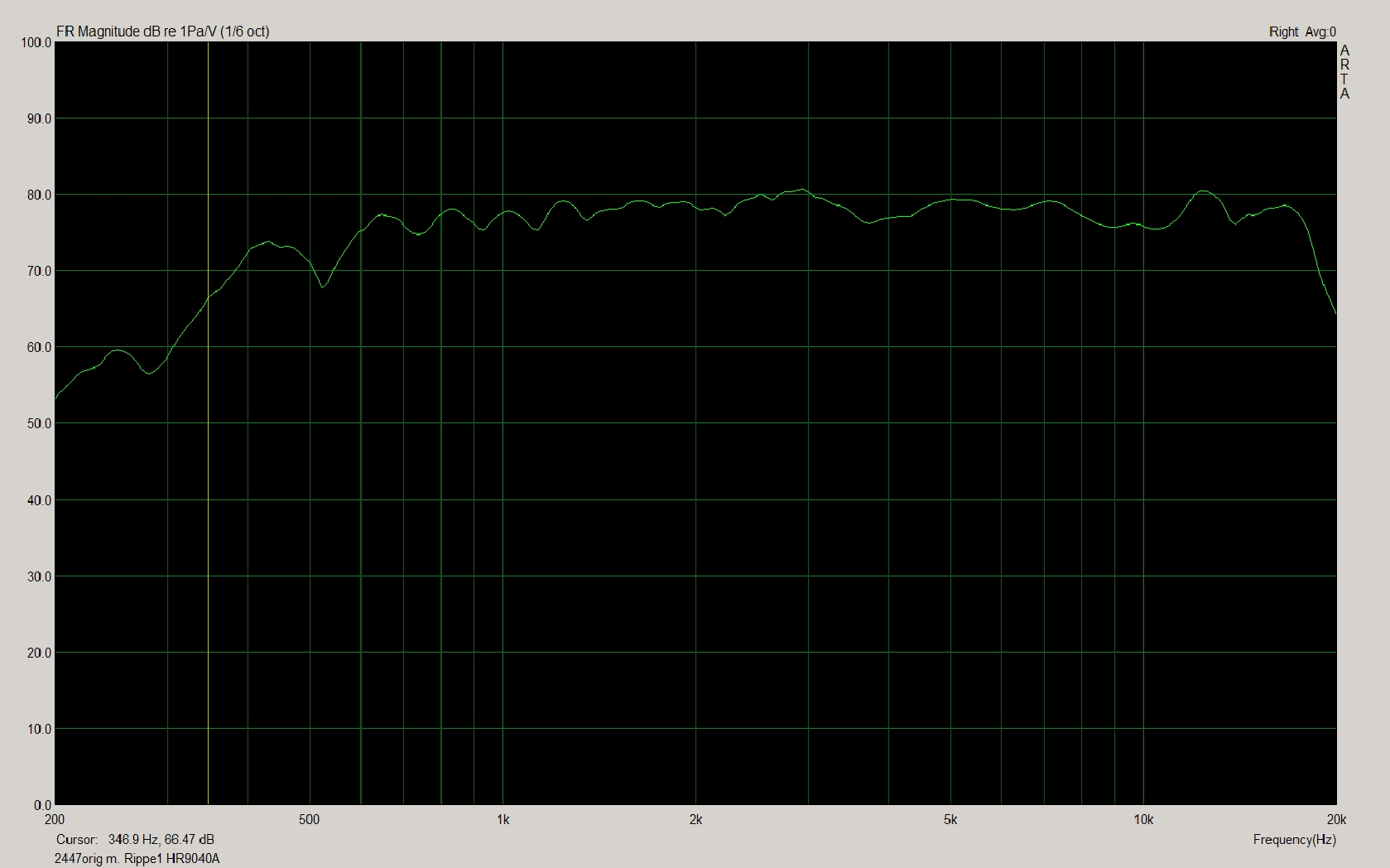

Here are some additional data provided by member gibber from the audioheritage.org forum:
Upgrade: SAM1HF or 2452H-SL in ScreenArray horn? - Page 2
And measurements he send me my email comparing 2447 and 2450 with same diaphragms.
