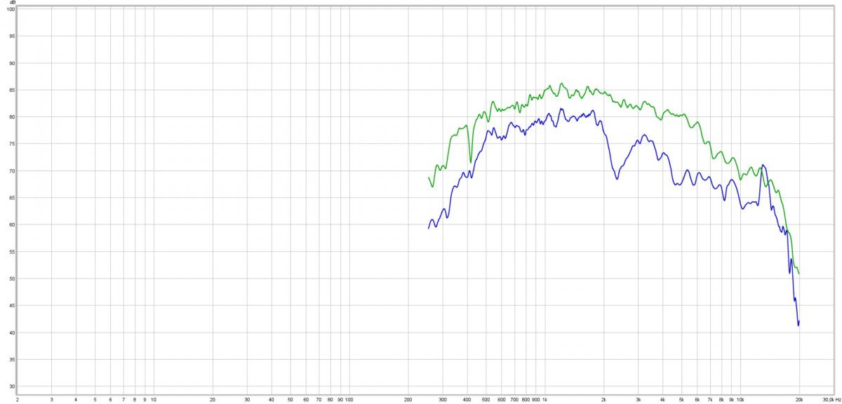

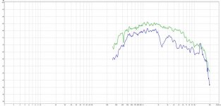

A have a pair after buying the K-402 horn and want to sell them after changing to JBL 2446 with Truextent Be. Would be nice to know what kind it is.
Here are measurements (no EQ) of the K-402 horn with K-69 (blue graph) and 2446 Be. The room contribute some.
