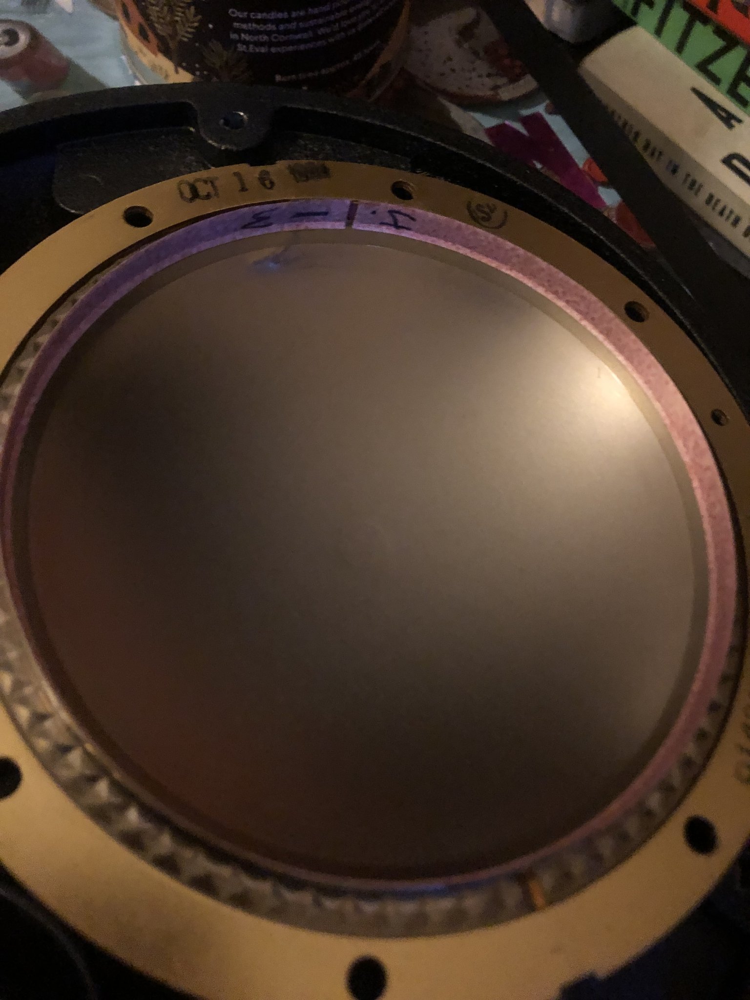

Also noticed some slight damage to the diaphragm (pictured -mark at top of image) could that be a cause of crackle?

Thanks for all the suggestions here. I only have one so far (still trying to source a second driver) but resistance across it is 4.5 ohms so think that's about normal? Don't think there's any stuff lodged in the gap, just reassembled and double checked.
DC resistance should be 4.3 ohms, which would be less if coils shorted together, 4.5 ohms sounds ballpark normal.
The diaphragm looks clean, doesn't show signs of hammering the phase plug, or the former separating.
The "slight damage to the diaphragm" may have been from a loose bit of junk (bit of phase plug, adhesive, etc.) can't really tell from the photo angle.
"Quite severe crackling" might be a sign of misalignment.
Alignment pins or rings on the JBL diaphragms generally will center the diaphragm adequately to prevent rubbing and buzzing, but they do not guarantee it.
A narrow frequency band, sometimes only a few Hz wide, may trigger a “buzz” distortion. For that reason, misalignment distortion may not be at all evident except with certain musical passages, making music, pink noise, or even specifically spaced sine wave tones near useless for alignment.
In most cases, low frequencies of several octaves below the usual pass band will make the harmonic distortion most audible. After determining a reasonable mid pass band output level, slowly sweep from 200 Hz up, listening for "buzz". Most times the range between 200 Hz to 800 Hz will reveal the "buzzing", but I have found a few diaphragms that only buzzed when driven at anywhere from 800 Hz to 5kHz or so.
The horn, or even the long throats of "old school" drivers like your 2446 makes the diaphragm output much louder, which will mask a dragging voice coil distortion component. Removing the driver from the horn, or stuffing the horn with rags, or laying it mouth down on a rug or carpet makes the buzz easier to hear.
Next, remove the diaphragm, fully clean the magnetic gap with masking tape, (it can take many runs around both directions before the tape comes out clean) check that the gap is symmetrical with a depth gauge which can be made from paper card stock, if not symmetrical it must be made so. You can't fix that problem without demagnatizing and remagnatizing..
To align the diaphragm, re-install the diaphragm with it's screws just loose enough to not rattle, but tight enough to allow one to tap a portion of the screw ring in the direction that eliminates the buzz, then re-sweep to determine this did not cause a buzz at a different frequency, then tighten the screws fully, and test again. Lather, rinse, repeat ;^).

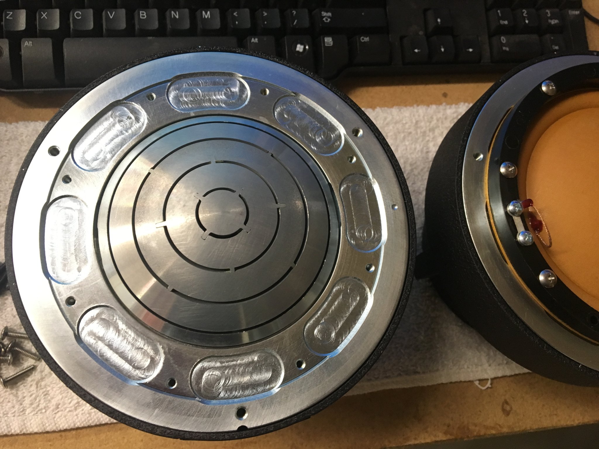

In that video the 2450SL is incorrectly assembled and while the person showed some pretty amazing repair skills, that driver was reassembled incorrectly.
Looking through my pics this is the only one I can find that clearly shows one of two coil lead reliefs machined in the magnetic gap.
With the JBL label at 6 o’clock, the reliefs will be at 3 and 9. They are not quite symmetrical. The colored lead, red or green will be on he left, at 9 o'clock.
The eight diaphragm mounting bolts are symmetrical so you can miss and then it is difficult to impossible to get the coil not to rub.
Hopefully this helps.
Barry.
Reactions: Arez and EarlK

Isn't the dot at 3 o'clock, the outer ring, the positive terminal alignment mark??
Rob 🙂
Hello Rob;
It sure is. These are odd ball drivers. 2450CM is the model. They were made for the Compact Monitor Systems and are 2482Nd’s.
In this pic they are “upside down” compared to the others where the label is at the 12 O’clock position.
I am just going through my old pics so these aren’t the best for illustration but here is a regular old 2451 with the label at 6 O’clock and the dimple is also on the right at 3 O’clock.
