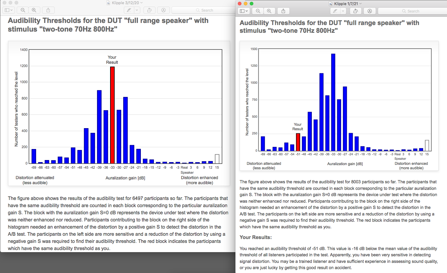

This site has tests available to determine what level of distortion you can detect:
Listening Test
Using Sony 7506 headphones I was surprised to find today that my distortion detection level was a lot lower than it was last year (-51dB compared to -33dB), though my hearing is slightly worse (less sensitive) now.
That said, using music as a source, I find it much harder to detect distortion than with the mixed pure tones.

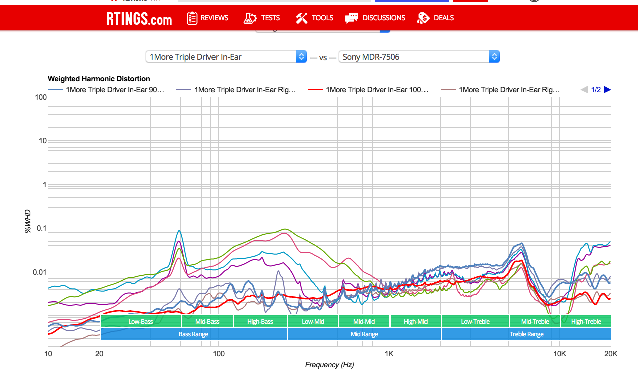

I use the 1more triple driver in ear, with memory foam inserts added. They are dirt cheap on eBay at the moment, so I bought 5 pairs for work.
1More Triple Driver Review - RTINGS.com
Great without, but With EQ, added the distortion figures are very hard to beat.

In-ear headphones have an inverse distance advantage over an over the ear phone as can be seen in the low frequency distortion comparison between the 1More vs the 7506, though above 1kHz, that disadvantage pretty much is gone, and I certainly could not detect the differences of under .1% distortion anyway.

I still could not perceive under -51 dB with the two-tone test, and from experience know that my threshold moves up considerably when listening to music, rather than pure tones. Pure tones are virtually non-existent in acoustic music, and seldom used in synthesized music.
Anyway, you have low distortion phones, give the Klipple tests a go, learn what you can and cannot detect.

I have been listening to sine wave tones to detect speaker problems since around 1977, so have a lot of experience, but was surprised to get down to -51dB yesterday.
That said, after reaching -30dB (around 3% HD) , it started to take me more than one A/B to tell the difference, and was definitely fatigued by the end of the test.
