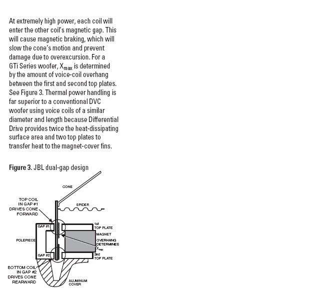

JBL claims 23mm x-max on the 2268H in their line listing of T/S parameters. If you look closely the other two drivers with the same basic motor are only 8mm and 11mm respectivly. The 8mm driver is the same efficiency as the 2268, the other is lower efficiency, hence the longer x-max (it also has higher Le than the 2268 indicating a longer coil,m and az higher Bl, indicating a longe coil too). On a line right above that is a driver with the efficiency listed as 700%, I suppose he believes that too.
JBL has not published a full data sheet on these drivers, so we don't really know. But the Le and Bl tell the story in their own way, as does comparing it with its siblings.
The completely different W15GTi has two 0.5" gaps, and two 1.3" coils. The x-max claim of 0.8" is proven by these measurements. The W15GTi needs over 3KW to make it hit its x-max. Its only 92dB/2.83V, and its 3 ohms, so it is 87.74dB/W/1M
The 2268 is 2.8% efficient, that's 96.5dB/W/1M
Do you suppose it's almost 9dB more efficient because it has a much shorter coil?

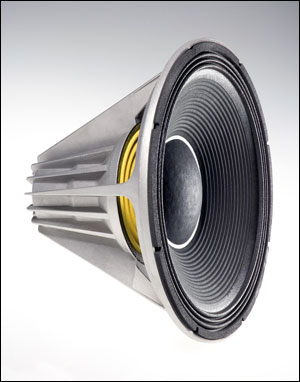

FRANKFURT, GERMANY, 29 March 2006 — In an engineering breakthrough that adds to the power and versatility of JBL Professional’s VERTEC® line array series, the company has developed an innovative Ultra Long Excursion 460mm (18”) transducer with 2000 watts continuous (AES), 8000 watts peak power handling capacity. The model 2269 is the latest example of JBL’s patented Differential Drive® dual voice-coil loudspeaker technology, and is fitted with dual voice coils and magnetic gaps, and an ultra-robust composite cone. It provides high output capabilities with an extremely advantageous power-to-weight ratio and is available only in JBL’s two newest VERTEC subwoofers, the VT4881ADP compact powered subwoofer and VT4880A full-size passive subwoofer system products.
“The VERTEC series has established itself as the leading line array option through its power, fidelity and versatility,” said David Scheirman, Vice President of Tour Sound, JBL Professional. “By incorporating the new 2269 transducers, the VT4881ADP and VT4880A provide audio professionals with enhanced subwoofer capabilities in areas such as concert audio and multimedia presentations where extended low-frequency performance is desired.”
The new Ultra Long Excursion 18” transducer features dual neodymium magnets, JBL’s exclusive Vented Gap Cooling™, and robust suspension elements for high excursion and extra long life. The new woofer is capable of a peak-to-peak maximum excursion of 89 mm (3.5”).
Seems like it's built for long excursion.

The differental drive system that JBL developed is a bit different from the conventional.
