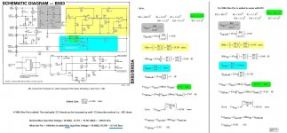

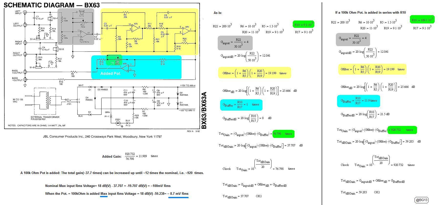

i need to make an preamp for it in this cause? can i modified the bx63a to have some voltage?
Hi rosario,
Here is an idea:
b🙂

thx bjorno for this schematic , i tested in open baffle but it will have a enclosure. another thing about bx63a can i make the output balanced even the input to have some decibels more, it worth?

Of course you can design a balanced output low Ohm buffer as you gain the double Voltage swing to feed the F4 but there would be an insertion loss at the F4 Receiver end if not made 'higher Ohmic' balanced to single end.
This is not a problem if you design a balanced input circuit using an Op-Amp like the already used TL07X amps in differential mode.
