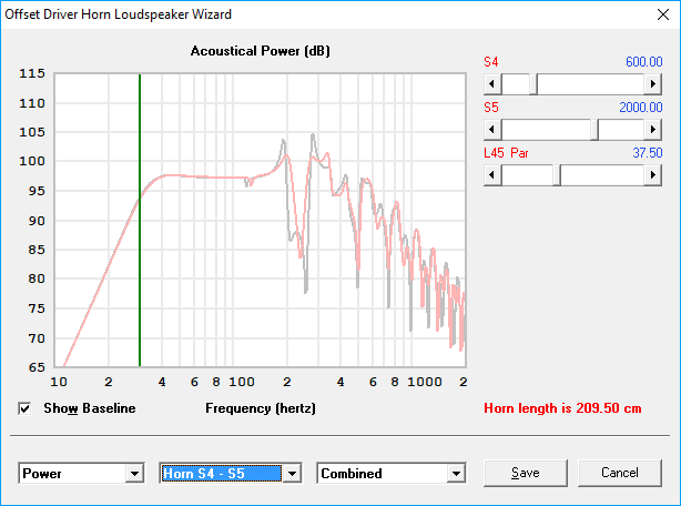

That would depend on how it's implemented :).
For this particular example of a 1000 cm^2 vent that's 75 cm long, I replaced it with a "venturi" vent that starts at 1000 cm^2, decreases to 600 cm^2 and expands back to 2000 cm^2 over the same length.
From the sim, Fb remains the same as the straight vent, and there are some minor changes in the FR above 200 Hz.

OK, but it hasn't worked out that way for me, though in retrospect mine had much more taper with 10:1 being the 'sweet spot'.
That said, if it remains the same, how much lower is the vent mach?

For that particular sim, estimated particle velocity at the vent opening at 50V drops from 6.822 m/s to 3.348 m/s, i.e. by just over 50%.
Putting the driver at the end of this 30 Hz QWR introduces a rather deep "discontinuity" at just over 120 Hz.
Hmm, my TQWT is 100% loosely stuffed and still peaks at 10+ m/s, but just noticed yours is tuned much higher, so never mind. Still a bit surprised it would be cut in half with such a modest flare though. I don't recall having any luck reducing WFO carb intake 'honk' until the scoop flare got pretty extreme with simple parabolic horns, so wound up with wide/flat hypex scoops.
