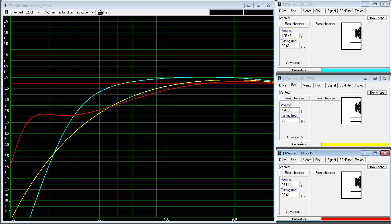

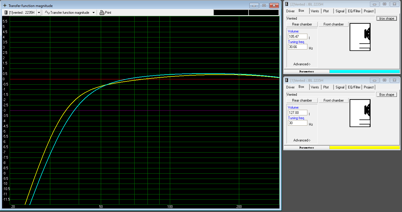

Looking at Straight forward common Alignments
QB3 105.5 liters 30.6 Hz Fb
BB4 127.5 liters 20 Hz Fb
EBS -3db 294 liters 22.6 Hz Fb
I Would use the standard QB3
And yes if you look at what JBL did it is basically very close
to the good old standard QB3 or Quasi Butterworth.
Using 127 liters instead of 105 liters
Fb 30 Hz

This case a EBS for the JBL is ironically around 300 liters.

This case would just use 100 to 130 liters
and tune to 27 to 30 Hz.
With real world error factors about as close as you'll get.
to a normal QB3

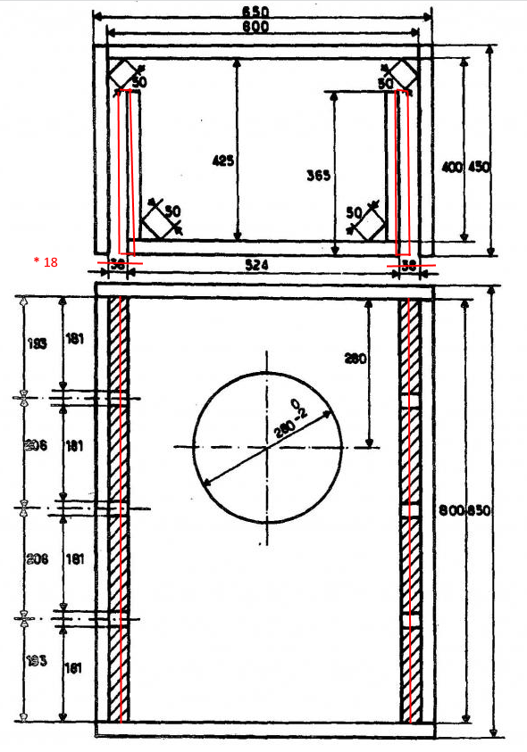

From Koizumi in 1976
is 150 liters.
Which works out fine for a 2235H
tuning needs to be slightly higher to get the
same basic transfer function. around 31 to 33 Hz
The petite ports are 38mm x 181mm
8 of them. 365mm length
Its tuned to 43 Hz
So to get it down to 31 Hz
Just make the ports 18mm x181mm
and same length 365mm
Easy as that.
Your basically changing total port area from
550 cm2 to 260 cm2
to get 31 Hz tuning
you can fine tune it to get 33 to 35 Hz
or use the same 43 Hz tuning
which gives a 3 dB bump.
Which somewhat makes up for full space losses.

Thank you for all of the help in opening my eyes to a new (to me) type od speaker design. This is what I have come up with after taking a break and allowing what information provided, sink in!
Using 2235H spec. : Rg. = .254, port width = 3cm, port height =11.5cm, 6 count/ports, n = 6.34, Vb = 142 liters, f3 = 30.4Hz, SPL =91.2
I feel better about these numbers. Any questions remarks advise before I cut my wood?
