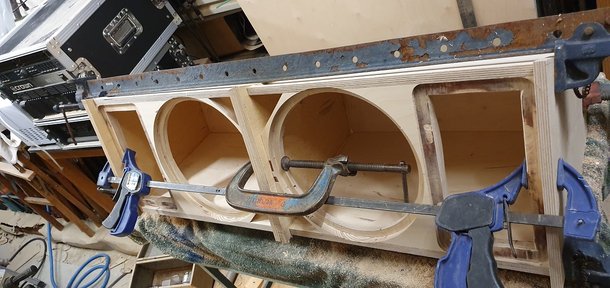

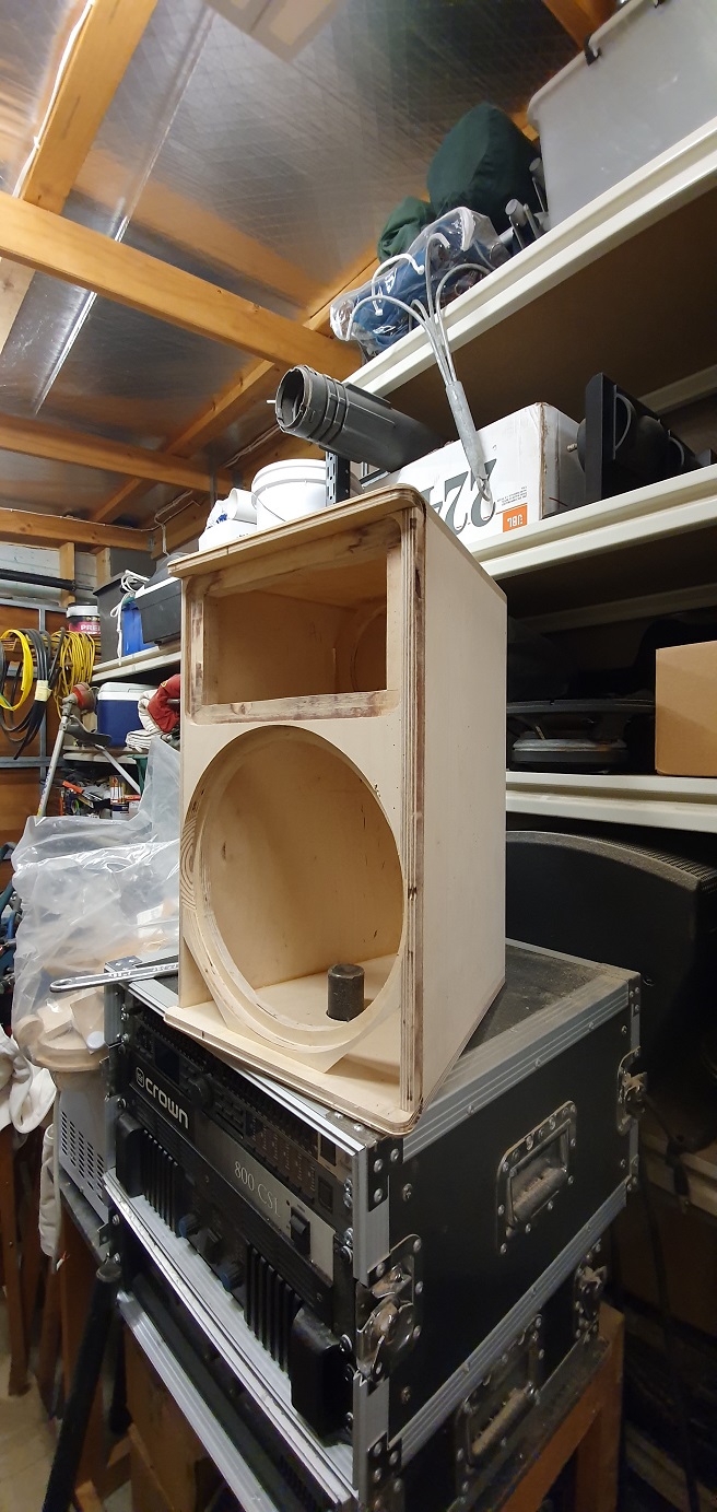

Thanks , yes heat/ power compression was my first thought also, I can go reflex and tune to 65/70hz this gives a slightly better output at 100hz. It just gets tricky fitting a port in such a small box. I'm building this weekend.

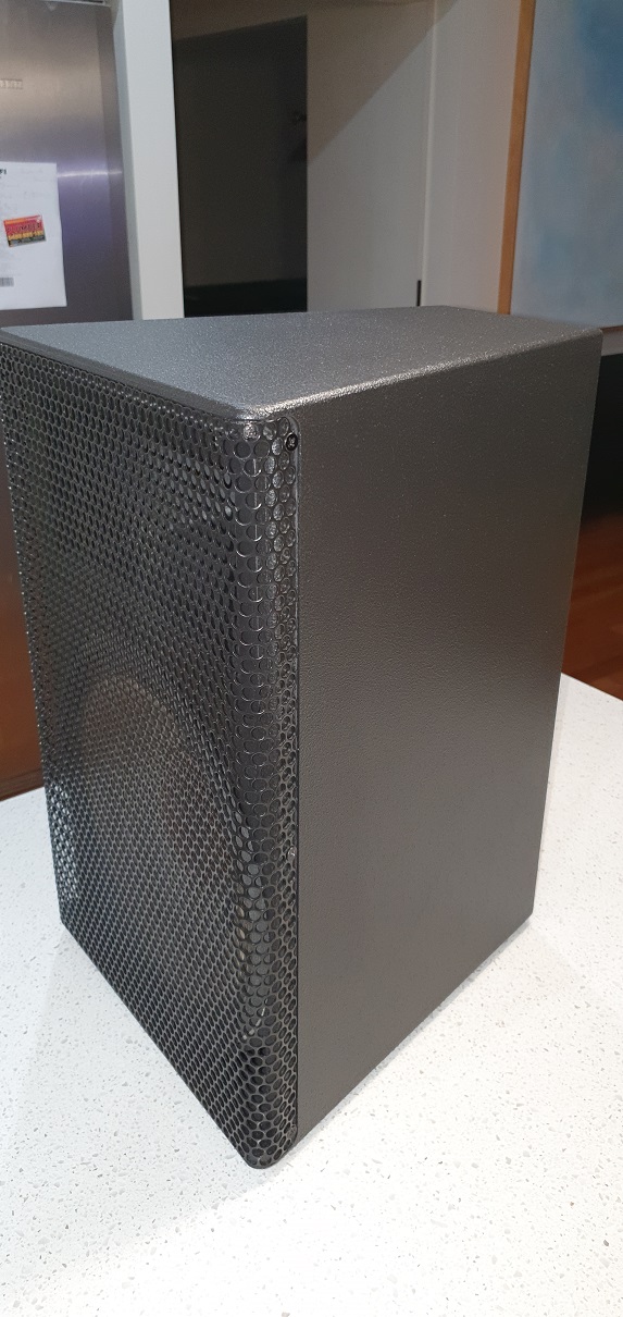

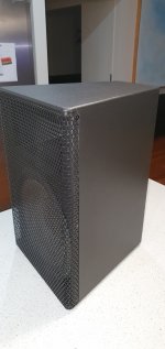

I have finished my new cabinets, I went with 30lt total volume tuned to 75hz, this gives me a measured flat response down to 100hz, they are very compact now and I'm super happy with how they turned out.
Nice! How did you do the routing for the grille? I'd ruin the box trying that 🙂
Edit: with trimmer guide?
Thanks for the kind words, the grill I rolled with a piece 25mm metal pipe that was screwed lengthwise with about 10 screws, a bit like rolling dough/pastry but the dough is attached to the rolling pin. Hope that makes sense. Greg
