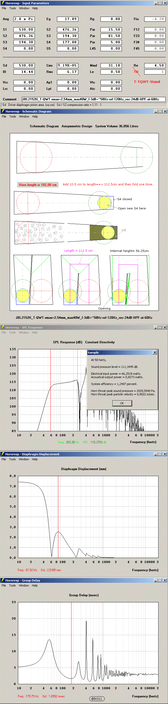

JBL 2152H T-TQWT Stand
Hi Kungfiskaren(SWE), 😀
Here is another idea: Use your JBL 2152H as (T-TQWT:s) Stands(~60 cm or 23.6” total height if using 18mm Ply) for a couple of good FR drivers on top.
XO the T-TQWT-Stand max. at ~250 Hz if the terminus/opening is placed as close as possible to the top FR driver.

Hello bjorno, I like the idea of a T-Line. Can you give more details? I am not familiar with what this means (T-TQWT:s) and (FR driver)?
FR = Full-Range (driver), Then do a search for T-TQWT pictures at Google or search my contributions here at DIYaudio..
