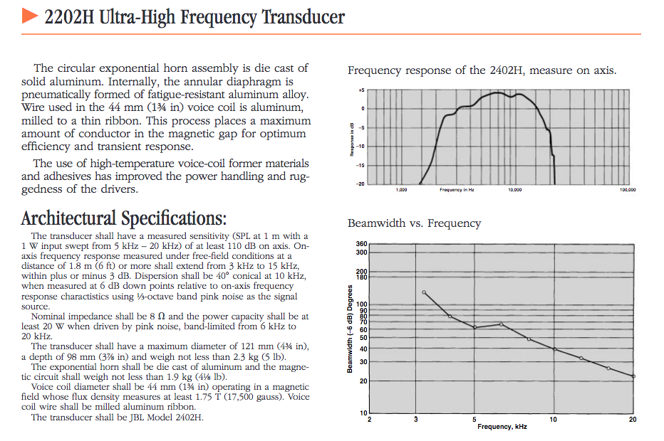

So I have these two JBL 075 Ring Radiator bullet tweeters. At around 106dB/W/m It would take a lot of padding down to mate with normal speakers. So what to do. one could
1. By some really expensive compression driver based mid horns
2. Get a pair of 8 or 10 inch PA midranges per side (or a big line array of 4")
3. Some sort of front loaded horn based on full ranges I have laying around
4. Dive into unity horns using 4" or 6x9" drivers I have on hand.
So 3 and 4 are the most appealing. Can the 075s work firing into the end of a unity horn instead of a compression driver? Anyone ever use 6x9 in either front loaded MR horn or unity horn?
I would be expecting the midranges to cover about 500-5k.

1)Can the 075s work firing into the end of a unity horn instead of a compression driver?
2)Anyone ever use 6x9 in either front loaded MR horn or unity horn?
1) An 075 or 2402 could work firing into the end of a unity horn, but it's own small exponential horn will determine it's directional pattern, which drops from 60 degrees at 4-5kHz to 40 degrees at 10kHz.
A "Unity" type horn uses a conical expansion, the initial side wall angles determine the nominal dispersion pattern.
2) Multiple entry horns (MEH) like the Unity style use small ports in front of the mid/bass drivers to enter the horn. The enclosed volume between the cone and port creates an acoustic bandpass low pass filter, which (after an upper peak) steeply cuts the upper response of the driver.
To increase the upper bandwidth requires minimizing the enclosed volume, more difficult to achieve with a 6"x 9" than a standard cone driver.
Using a 4" with a cone filler plug with minimal volume left, the filler within a few mm of the cone, I doubt usable response would extend past 2.5kHz, while the 075 response drops steeply below about 3.15kHz, leaving a dip and ragged response in the critical 2.5kHz range.
Using your present drivers in a vertical array with the 075 centered or MTM would probably give you better results with far less effort, and if you plan to use passive crossover components, far fewer parts.
