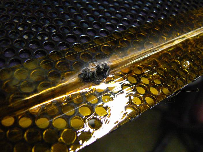

Hello CharlieM,
Wrapping the edges with kapton tape for insulating the stators from each other is a good idea.
But, your technique of sanding down all the sharp edges on the stators is an even better idea.
Attached is a pic from an early Sander's Eros panel showing what happens when sharp edges aren't properly removed. Two layers of 5mil kapton tape didn't help.
Glad you posted that, what voltage level was this you think?
That's a good question.
I'm not sure what step-up ratio the Eros had, but we could guess it was in the 60:1 to 75:1 range.
Based on the owner using 250W amp, I would estimate the peak voltage between stators to have been somewhere in the 3kVrms - 4kVrms range.
