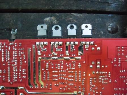

You must replace all 4 of the output transistors if you want the amp to be reliable.
These transistors are BJTs, not FETs. BJTs have a base, not a gate so the resistor connected to the base would be a base resistor.
#19:
The TO-220 case is the smaller case, like that used by the poser supply FETs. Are they fully encapsulated or do they have the metal tab exposed on the rear of the transistor?
Thank you
The backs are exposed metal.
I will get 2 more to replace the outer ones.

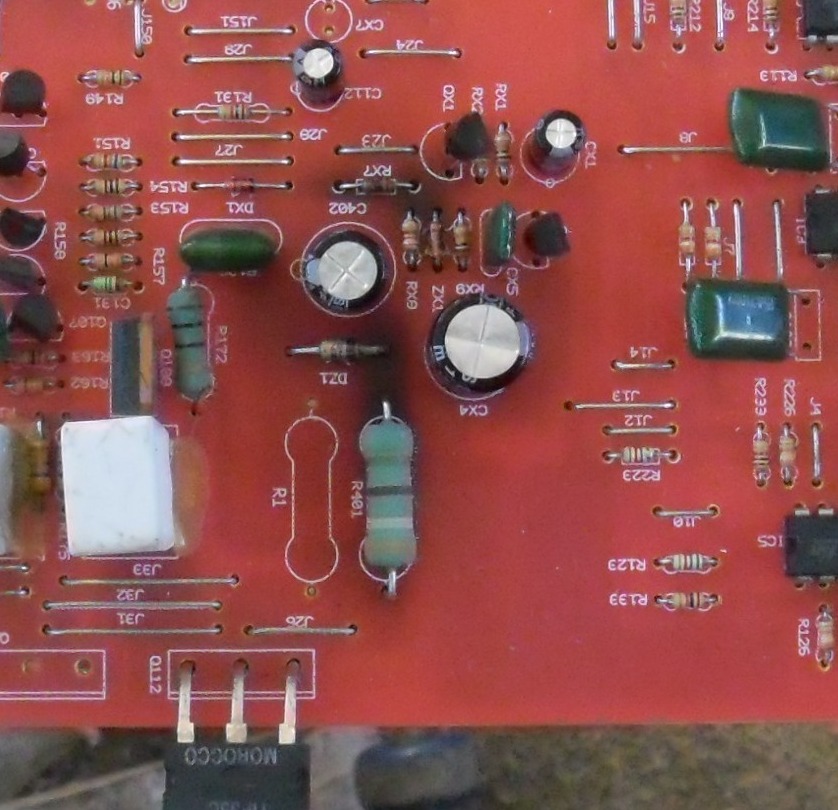

Thanks, I removed both drivers and confirmed they conduct in 1 leg and out the other 2 legs with no reverse current leakage. My multimeter read .695 on the diode-check setting. I also checked the diode that is across the drivers, it read .550 in only 1 direction, when removed from the circuit.
I removed (zener?) diode at ZX1 (pic at post 19). It read .550 in 1 direction only, and actually looks ok. That was my biggest concern it that area, and as Perry stated before, it just looks like that area got hot.

What needs to be checked here as it looks a little burnt. Hard to see but ZX1 may be cooked, what is it and how do i check it

R401 and the same on the opposite channel get quite hot to touch. (attached in the quoted post above or at post #19) Any comments on this? or are these the 'large resistors for the regulators'?

The large resistors are often for the ±v regulators. They get hot but they the regulator resistors should be approximately the same temperature. Check the Zener diodes that they're connected to to see if they both have the same voltage.

The regulator-resistors aren't associated with either channel. They produce voltage used by both channels.
Hi all, i have replaced the output transistors with a matching sets of TIP35 and TIP36.
Now this amp was testing ok before with the odd outputs, so i plugged it in and it fired up for around 30 secs with only a 10amp fuse for testing. It then blew the fuse, i replaced it and it blew even without the volume up at all.
I unplugged it and 2 of the new outputs were blown, i replaced them with 2 I removed earlier, reconnected and it blew the fuse again.
The amp will accept the power leads fine, and it blows the fuse about 3 secs after the amp turns on. The power transisters are ok, and the output transisters are fine as well,

Were the original transistors TIP35s/36s?
Yes, the difference is that the new ones have a 220 insulated case, still with the exposed rear. i have maintained the insulation behind the TIP35/36 and only test clamped.
I will try replacing the TIP35/36 back to the mismatched set and test, as these tested ok before.
I replaced the TIPs and its going ok. The amp has promptly blown my sub once i got the fuses in and wound it up. Now the sub rattles. I will replace it and try again.
