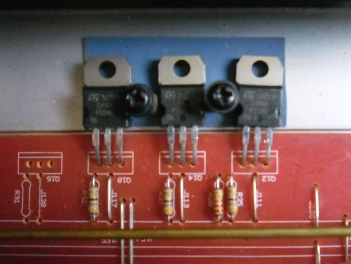

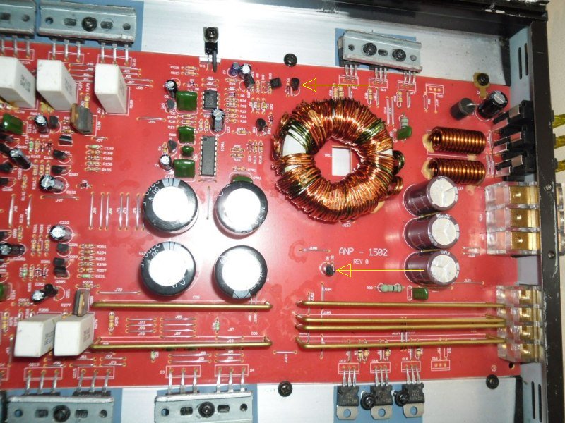

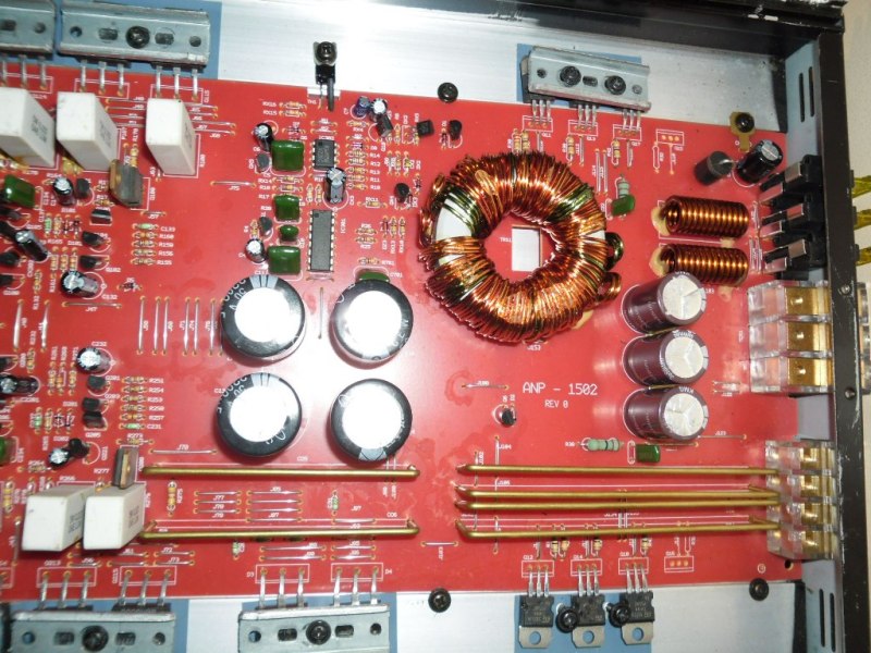

Hi all, attached are the board pics.
If we look at the unclamped P55NE at Q14, we can see that it is cooked, also Q12 looks only slightly better.

From reading other topics it seems i should be replacing all 6 of P55NE. They seem a little hard to find although STP55NF06 are plentiful.
Are the STP55NF06 suitable replacement for the STP55NE06, or are there better choice (maybe STP80NE06)?

Should I install extra transisters and gate resistors and links at the blank places near Q15 and Q16?

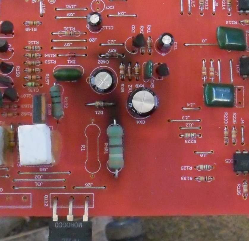

If we look at the second attached picture, we can see some board discolouration near R401, it easier to see on the photo than real life. It seems to be from ZX1 which is right next to RX8, I think this might be a Zener Diode.
Do I simply replace ZX1 or does something else cause this to blow?

The board is discolored due to heat stress. This is common on amps that use such simple voltage regulators but the Zener diode (at the end of the resistor) should be checked. Sometimes a defective zener can cause greater heating than there should be.
What is the value of the gate resistors for the power supply FETs?

They are 47 ohm resistors. You can use a wide range of FETs in the amp. I suggest using the originals but if they're not available, you can use IRFZ44s, IRFZ46s, IRFZ48s IRF3205s would probably also work.

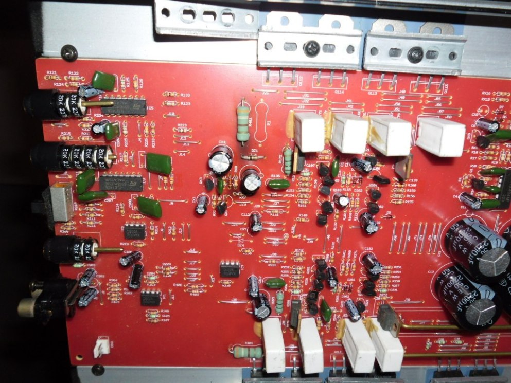

The emitter of the driver transistors connects directly to the gate resistors. One driver goes to 3 of the FETs. The other driver goes to the other 3 FETs. I would suspect that it's the two indicated by the arrows in the attached photo.

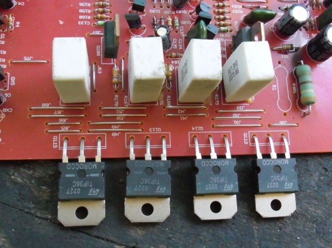

I have removed the board, turned it over, traced the tracks and, as you suspect these are the driver transistors. Using the multimeter in the 200 ohm scale, there are no shorts in these 2 transistors.
Output Transistors
I presume these are the output transistors, the transistors on the opposite side of the board test fine, however these transistors are not so good.
I removed there 4 transistors and checked them individually. Q112 and Q115 were fine, and i have replaced them. Q113 and Q114 have shorts. I will get a TIP36C and TIP35C to replace them.
I detect a pattern, so i have compared the gate resistors at R100, R167, R168 and R175 with the resistors on the other side of the board and they are comparable.

These are not gate resistors at R100, R167, R168 and R175.
Gate resistors are at at R178 and 7 other places. They all have 4.9 on 200 ohm scale.
Driver transistors for the outputs are at Q109 and 3 other places. They have no internal shorts

Check also drivers for defective output transistors, Q100 is one of them.

Yes, thanks Mote. I think its Q109 not Q100 (bit hard to pick it in the photo). But I checked them. There is 4 of them and they each drive into 2 gate resistors and in turn into a TIP35C and TIP36C.
I think they are the ones you are talking about.
If so, they checked ok
I went down the local shop and got a TIP35C and a TIP36C and some 47ohm resistors.
The TIPs are enclosed (T-220?). I think its OK to just replace the 2 of these as required at Q113 and Q114, or should all of them be replaced?

What needs to be checked here as it looks a little burnt. Hard to see but ZX1 may be cooked, what is it and how do i check it
I have looked at QX1 and it has no shorts.

The 47 ohm resistors are the gate resistors for the FETs, they only had them in 47ohm 1%, so i have replaced all 6 of the gate resistors at R35, R36, R37, R38, R41 and R42.
#14:
The resistors are OK. They are 5% tolerance components so they are within tolerance.
#15:
You have to confirm that both drivers have no leakage and that each one has two good junctions. If you don't understand what this means, read the 'checking bipolar transistors' on the basic repair page and follow the link to the 'checking semiconductors' page.
#16:
You must replace all 4 of the output transistors if you want the amp to be reliable.
These transistors are BJTs, not FETs. BJTs have a base, not a gate so the resistor connected to the base would be a base resistor.
#19:
The TO-220 case is the smaller case, like that used by the poser supply FETs. Are they fully encapsulated or do they have the metal tab exposed on the rear of the transistor?
When checking the diodes out of the circuit with the meter set to diode-check, you should read approximately 0.7v one way and OL with the probes reversed.
#15:
#16:
#19:
