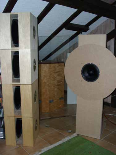

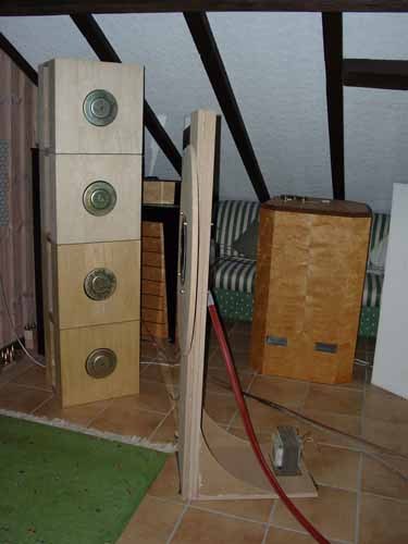

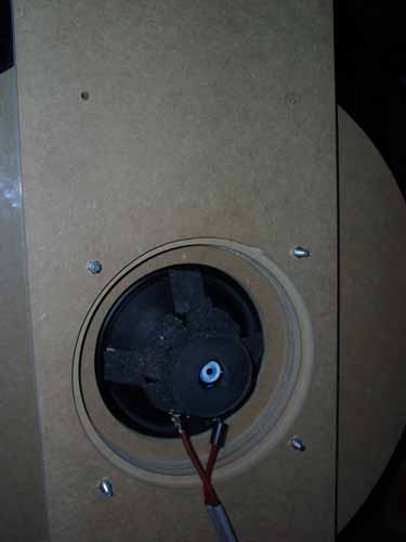

Hi Fedde,
i can help you out.....
since the wooden baffles 170x140cm are very big and ugly and not usable in a normal livingroom, i decided to make something with glass and wood.
My new ones are a mix of glass and wood and look smaller because of the glass. the size is anyway 150x130 now.
least month i tried to bend the baffle, but the sound descents. it is best, when the baffle ist plan and not bend.
yes i still have one aditional magnet, but since i have two additional pairs of Ciares i will test with two magnets sometimes.
The comparisons i have are the AER (Lowthers), Fostex Fe103S,
then professinal speakers: Avantgarde Acousic UNO, AirMotion Transformer Projects, B&W 802, legendary smooth "Mini Monitor " of german Hobby-Hifi Magazin.
See also: www.high-end-manufaktur.de
I had (and heared) many speakers and amplifiers last twenty ears. I went from fullrange horn speakers (lowther) to 2-way systems and then back to fullrange open baffle (Ciare)
I made my baffles, that i can remove teh driver easily and replace it with drivers up to 30cm. Supravox 2000exc, manger are planed..
It will be very intersting to hear somthing about your experiences with Supravox in comparison to Ciare...
The comercial version of Attac 400 was tested in german magazis like "Stereo" and "Stereoplay" and got reference standard awards. The comercial version is about 4000.- Euro one piece.
Since i knowhow to make them i made the myself. But the way of making them is secret and it`s copyrighted (patented)

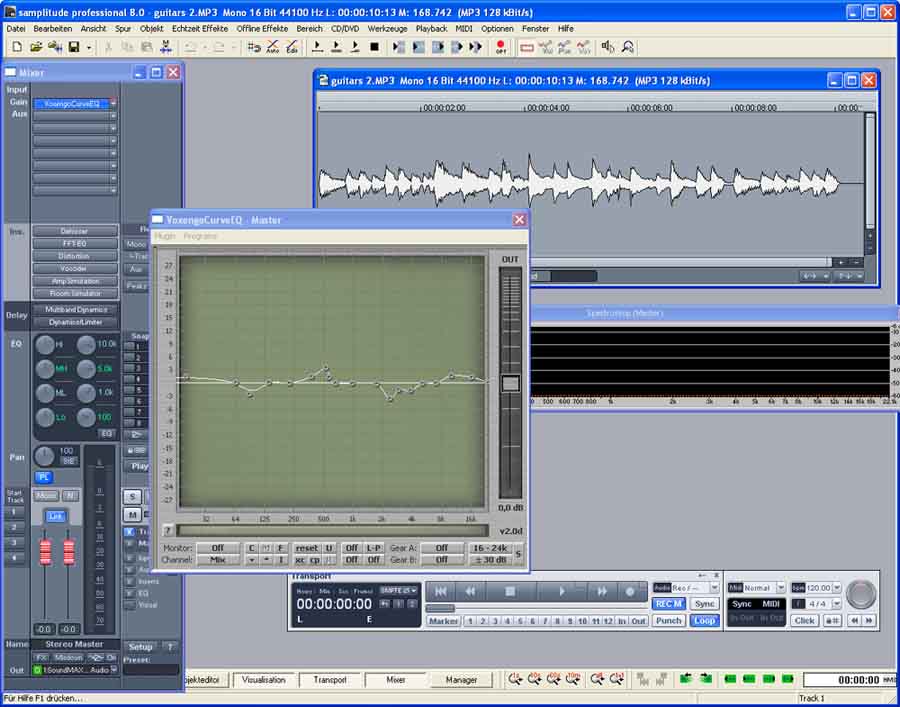

i use a special qiet computer fpr playing my CD`s of harddisc, wit software like Samplitude 8 or Wavelab 5 and professional Audio-card like M-Audio, ESI-Juli and so on.
The EQ-Plugin is called "Voxengo EQ" and its a VST Plugin.
When Music is plyed by Harddisk of PC the sound quality can not be topped even by CDP`s for 10.000,- and out of the Audio card i go directly digitaly to digital amplifier. No D/A Converters at all
I tested many Tube amloifiers and Class A Amlifiers last years and
none of them beats the fully digital solution i use in the moment.
i know of what i speak!
With the equalizer i smooth the frequency response at the hearing place. All what you need is a "AudioController" or good software-meassuring tool. It depends on the hearing room charkteristics. I did not enhance high frequency of Ciare, i only smmothed it at the points wher it does too much or too less.
The equalizing of the room acoustics brings mor natural sound than changing drivers.

Thanks for all your information and photos Ralf! 😀
I agree that PC's can be a good source for digital music. But it is not so easy to get realy good quality audio out of a PC. Multimedia players like windows mediaplayer completely change the sound. I use Foobar2000. The audiopipeline can be totally configured to your own wishes. I am busy writing some DSP plugins for EQ as I am not happy with the internal EQ. The Foobar EQ does work to improve the balance. But at the same time it also removes quite some dynamics, soundstaging and life. I even made a better plugin in for volume control, as the foobar volume made the sound more unclear. Are you complety happy with your EQ?
I use an external 19" WAMI-rack24 soundcard for S/P-DIF coax out. It also has some neat clocking (word clock) options that I still have to try...
Your baffles are still very large (150x130)! Mine are 122x66. I would not really like to make them much bigger, as my room is not that big (24 m2). I hope it will be possible to get good integration with a sub at this baffle size. BTW: the glass works quite well in your baffles!
Those subs really look nice! I would like to make something like that too, my Ciares really can use some extra sub bass! That tower would have cost a lot of money if they were real Attacs...
BTW: why don't you use them in stereo? And do you really need four of them? 😉

Fedde,fedde said:Those subs really look nice! ... And do you really need four of them?
we had the honour to look at the first subwoofer line array in history 😀
If Ralf puts another two on top he might even get into the Guiness Book of Records
Rudolf
Rudolf said:
If Ralf puts another two on top he might even get into the Guiness Book of Records![]()
Yeah, go for it Ralf! 😀
Fedde
@ Fedde,
yes, there is nothing perfect in the audio-wold.
So with the EQ Plugins:
But i have tested the most of the EQ -plugins, and Voxengo was the best (at least for me) of them.
Sometimes, when playing very loud recorded CD`s you can hear kind of very quite digital clipping, but thats perhaps for less than 5 % of my CD`s.
Voxengo EQ ist the Eq which affects the sound quality less than the others. Even it has no hearable affect (for me)to the dynamics and colors of Instruments and Voices.
For Paying music i tried -out Foobar2000. When i use no EQ i cannot hear differences between Foobar2000 and Samplitude or Wavelab. Unfortunately Foobar has no proper EQ.
I would like to use Foobar or Samplitude with an EQ, with which you can adjust every channel , seperately (Voxengo does not!)
there is one EQ with which you can adjust stereo, but there are too less bands, Voxengo has 60.

I think one of my dipole-Woofers would be enough, but i once planed an other Speaker project and i had 4 of them left...
Sometimes i will devide the woofers and try-out 2 of the left and two of the right side - perhaps, but in moment i see no need of it, because i am pleased with the result as ist is...
I have the same thing. It's my Behringer EQ in that case that's clipping. It's quite easily fixed: either lowering it's input (output of pc) or lowering it's master gain so that it's ouput-signals don't exceed it's limits.
