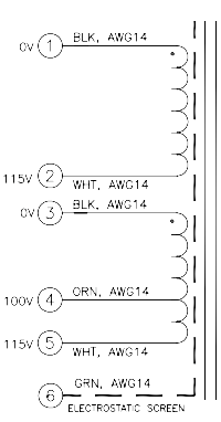

@Nelson Pass could you please advise how I should adjust these Japanese SIT1s to work optimally at 230v? Should I swap out the transformers to replicate their original config (in Japan @100Vac the channels would have seen 110Vdc), or shall I do as ZM suggested: simply adjust the course bias pot P1 to set Iq in the middle of the meter position. I believe this will set Iq where it needs to be but Vgs and Vds might be in a different spot.
I want to ensure the operating point on the SITs is where they were intended to be so I can experience these amps in their full splendour. Thank you!

US amp is having 36Vac + 36Vac secs, connected in series, ending in 72Vac; your pic of original US Donut is confirmed by pics I have from other source, showing same numbers
to split a hair, Donut with 115Vac primary, nowadays mains in US is 120Vac, ending in 72Vac*120/115=75Vac
Japanese amp is having 45Vac+45Vac secs, primary 115Vac on 100Vac mains, thus ending in (90*(100/115))Vac=78Vac effectively
difference between 75Vac and 78Vac is irrelevant
now, as is, you'll need to order pair of new Donuts
300VA, 230Vac primary, 75Vac secondary; or - if lookiing for ready made/standard values, you can search for 36+36Vac, and connect it in series
