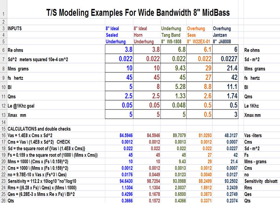

academia50, QMS by itself doesn't affect how crossover works, only total QTS which is the same. The only reason new driver "won't work" with old crossover is minor differences in impedance and frequency response which will result in larger peaks/dips in crossover region making it less optimal. For non-T35 DTQWT at least. I believe i can make it work with my T35 variant, maybe with additional LCR circuit

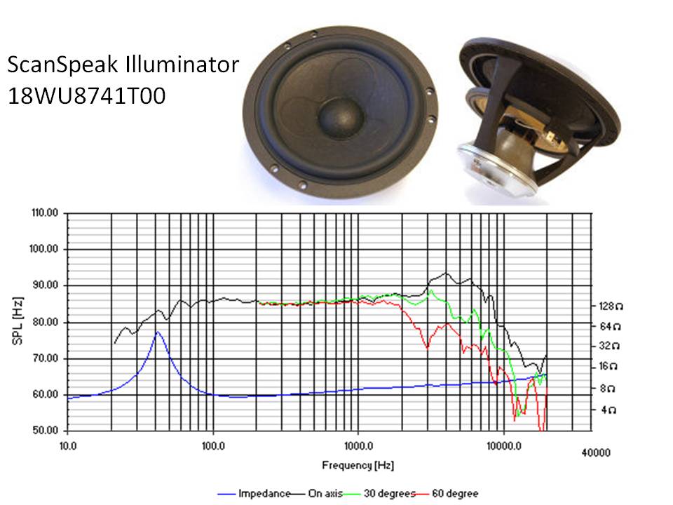

Seas H566 does what you want.
I can't seem to find such driver... Does it have a normal name like ER18RNX etc.?
