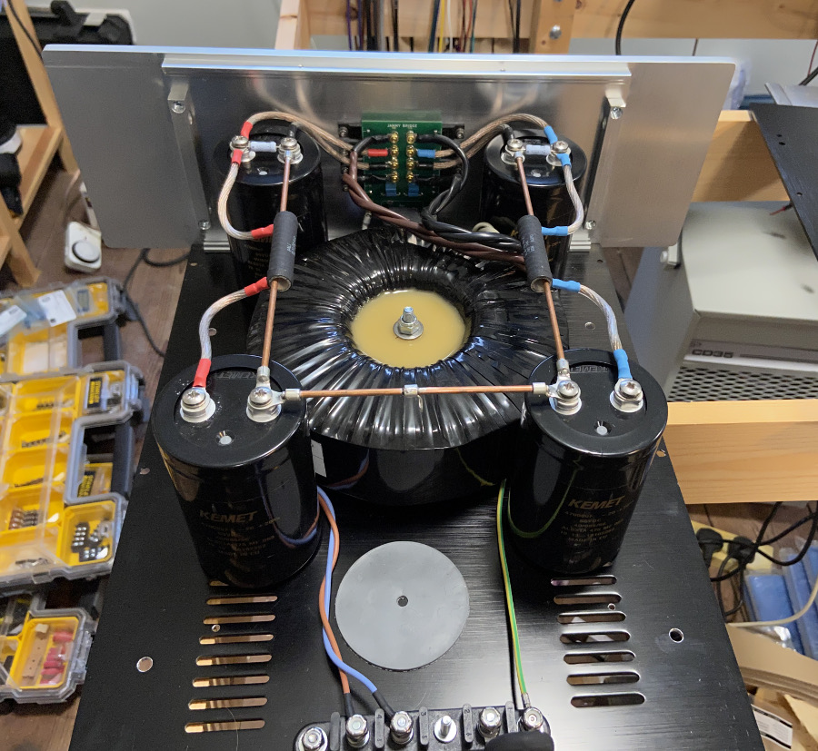

It's a box made of aluminum, which contains circuit boards made of epoxy fiberglass. Soldered to these circuit boards are passive devices (resistors etc) and active devices (field effect transistors etc) made of silicon. Connecting these boards together are wires made of copper. On the periphery of the box, a few electrical connectors are disposed. These communicate signal-in, loudspeaker-out, power-in, as they transition between the external world and the interior of the box. Pretty straightforward really. You've seen similar examples before.

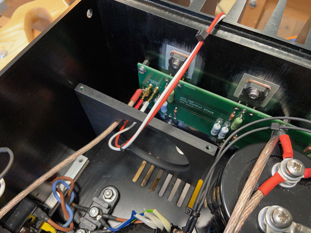

The Richlite I used for the front-end-board brackets wasn't up to holding M3 tapped holes. I've tapped successfully into other phenolic boards before, so I'm not sure if it's the difference between paper-based phenolic (Richlite) and linen/cotton-based ones, or if it's just the tiny threads on M3.
In any event, I had to Helicoil them:

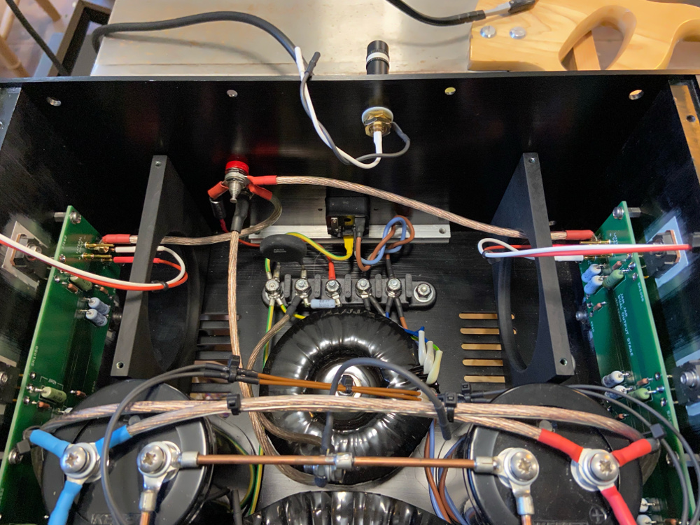

This shows the new routing of the output wires along the back panel instead of from the fronts of the output boards. While not in this picture, the feedback wire also attaches to the output post.

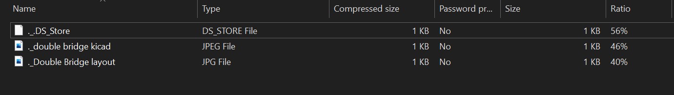

post #642 of the F3 builders thread, contains Gerbers.
And then later, he enhanced the PCB as shown in post #17 of his Beefcake thread. Notice the new nickname on the beefed up diode board.
