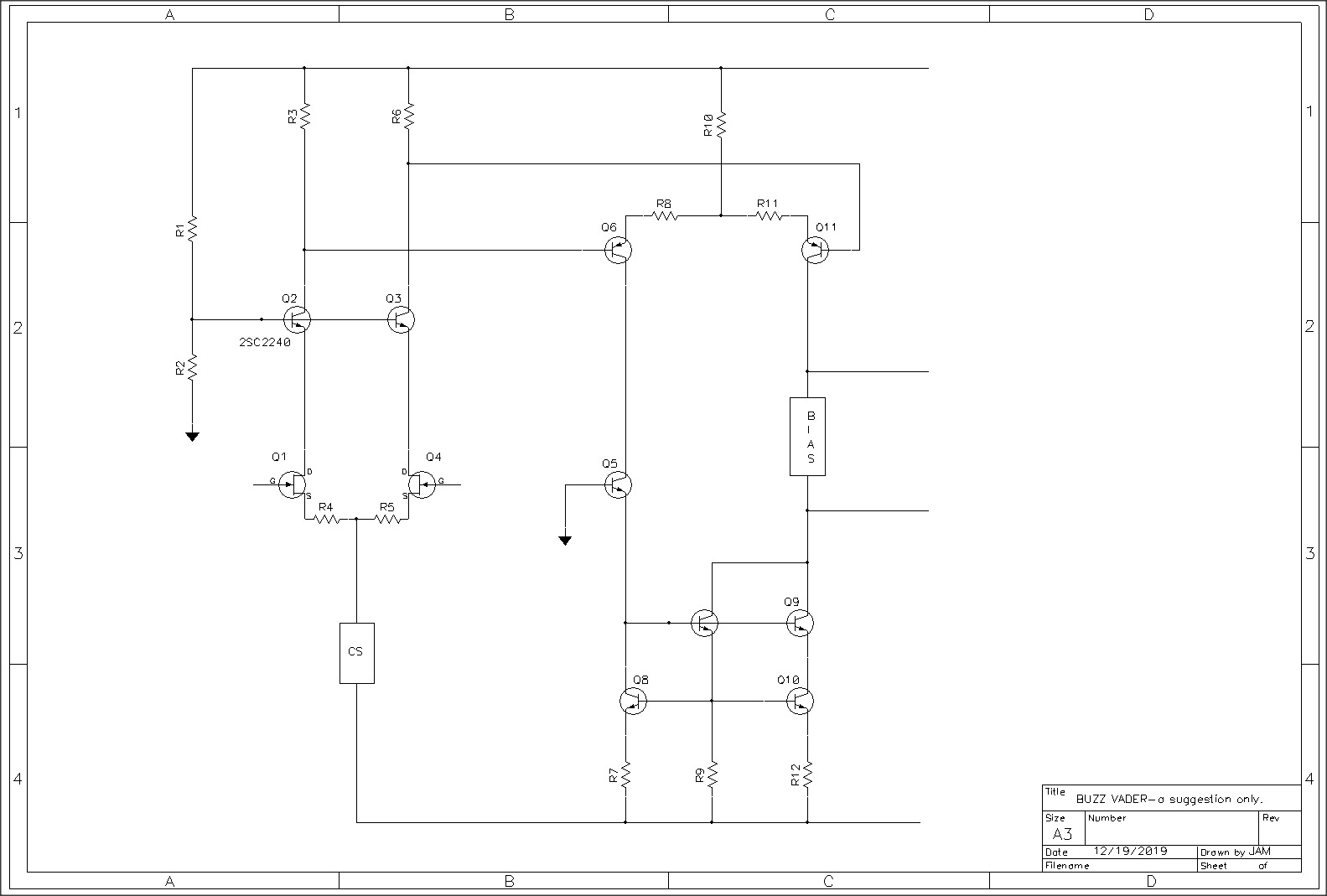

I believe I see three suggestions here:
1) degenerate both LTPs
2) improve the current mirror in the second
3) Q5, but I have no idea what it's doing
It's also upside down, but I assume that's just to use easier-to-find N-channel JFETs? (I happen to have some 2SJ109s burning a hole in the bottom of a drawer, so I like the other orientation.)
I'm going to play with (1) first because stability is still marginal with a decent slew rate and perhaps I can increase the current for better slew rate without increasing the gain.

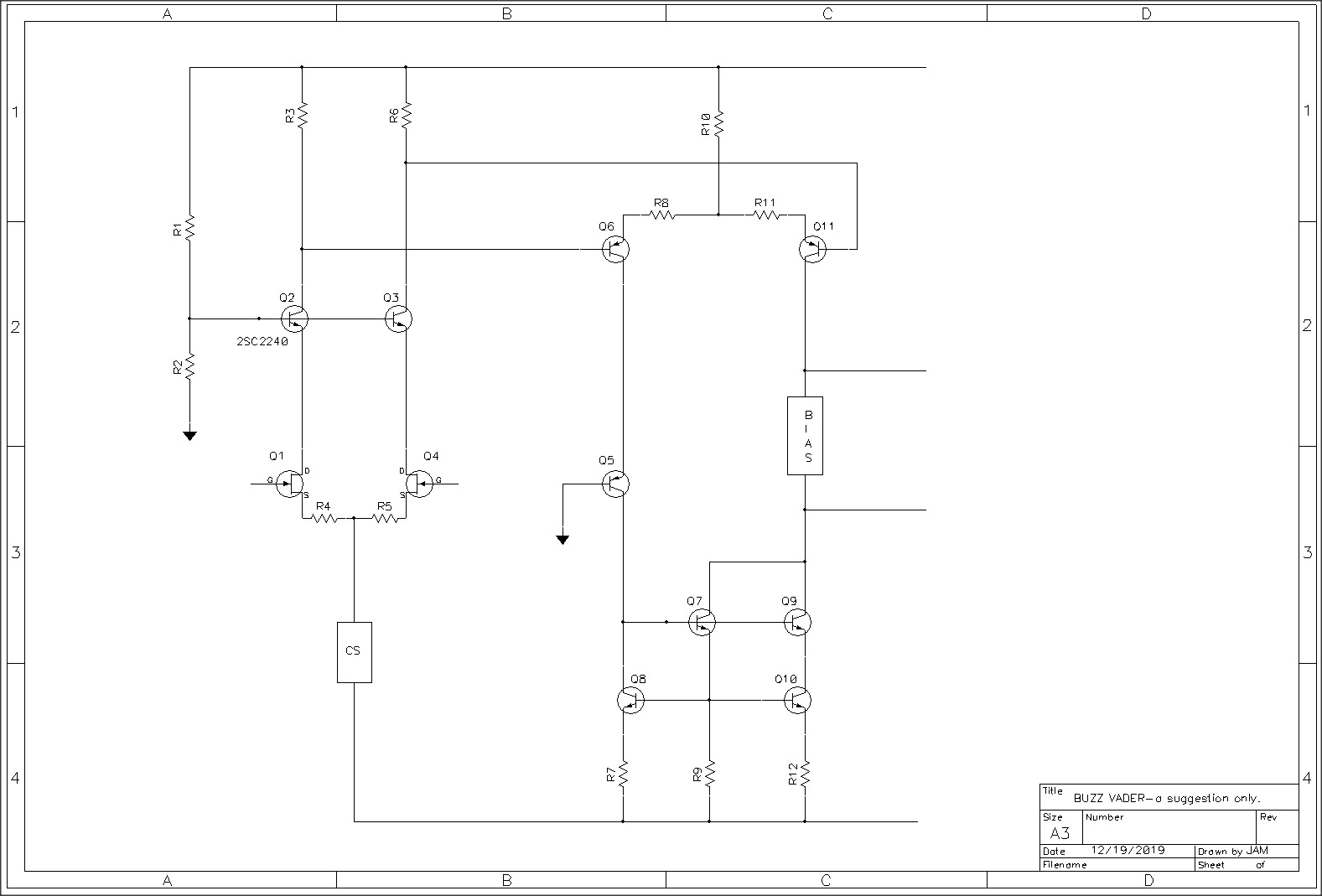

Jam your Q5 is the wrong gender. As drawn it will push gerbillions of amperes thru R9. And R7 & R12.

Degeneration on second diff is slight or can be removed........just a matter of balance.

Most degeneration I've seen has been on the order of 100 ohms. Can I use something like 5 or 10 ohms in the first diff, or would that be pointless?
(Otherwise I need bigger resistors in the legs to get the gain back, and then I run out of voltage on the negative swing.)
I didn't have to use that little after all. With 47R in the first diff I'm getting 50uV/sec and DC - 100kHz frequency response with reasonable margins (45º and 7dB). Whoo hooo!

at the currents you're showing in R10, R11, and R23, that's a fair amount of wasted volts (headroom loss) and resistor warmth ...

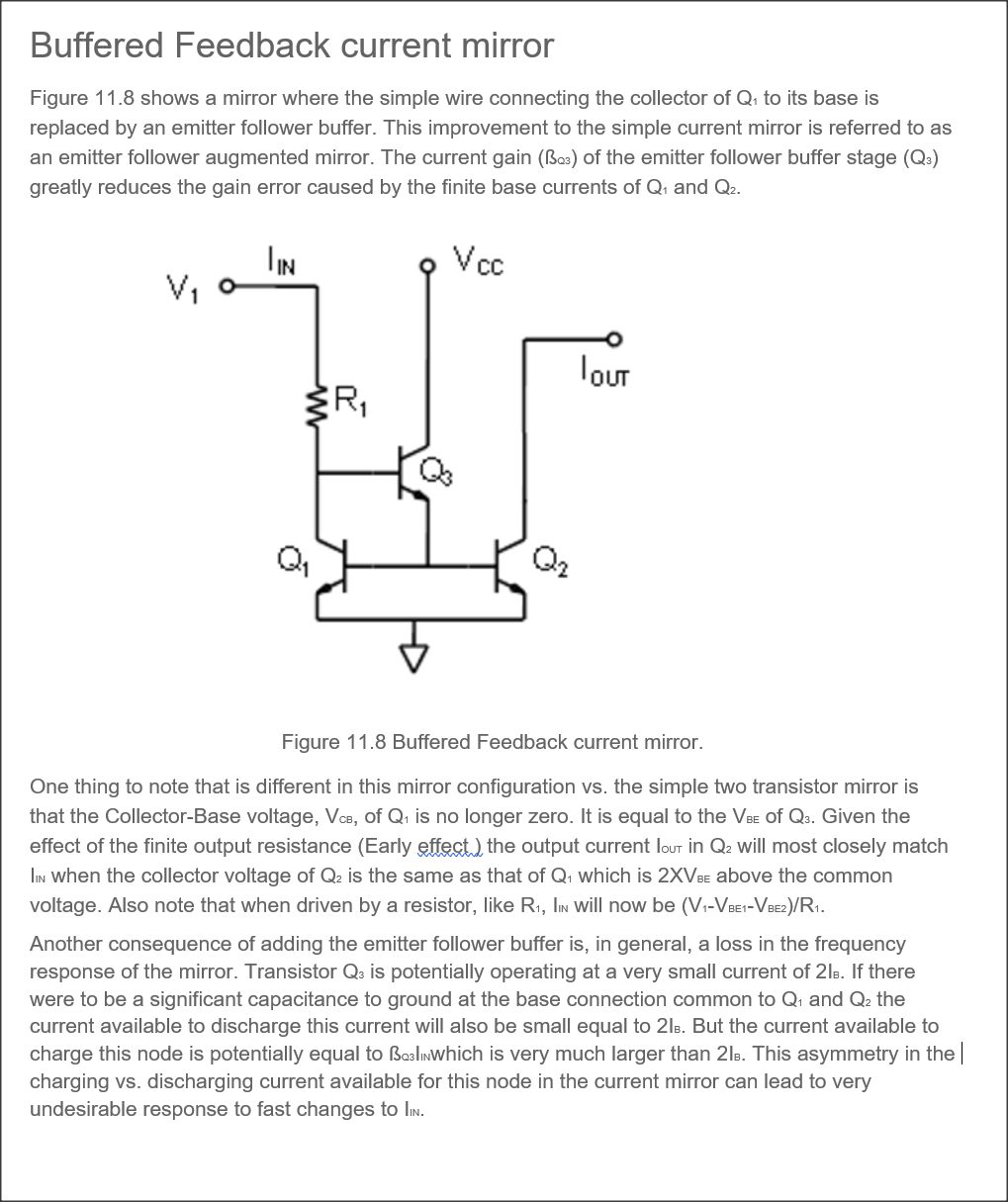

Michael has a point (but if you make the front end rails high enough and reduced the current in the second differential since you have drivers)........I woulds still address early effect in the mirror and improve its accuracy.

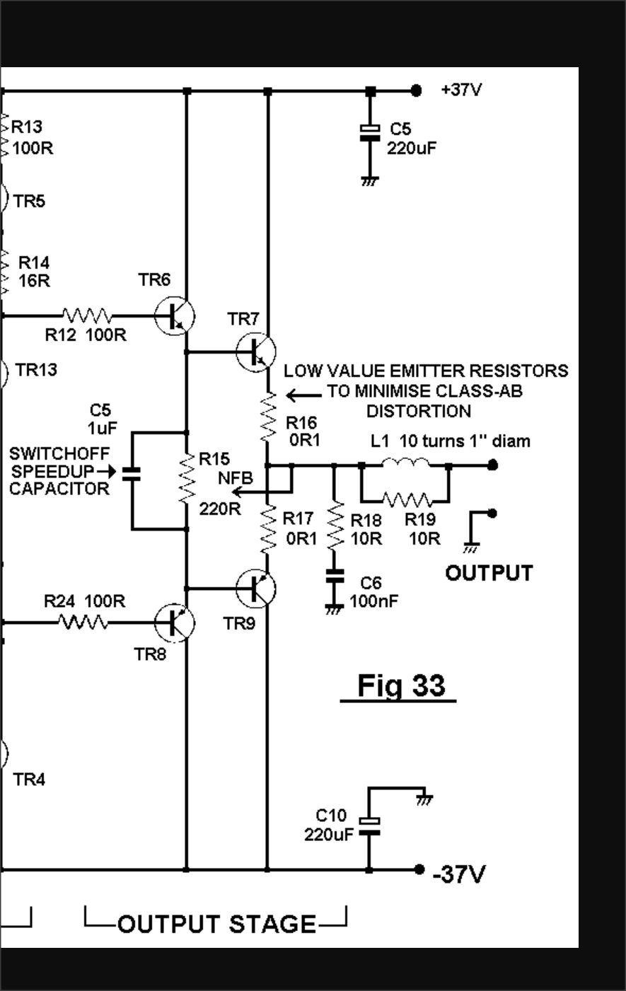

Also try removing the connection of the driver emitter resistors to the output, it might reduce crossover distortion.

I'll have to have a look at that again. Boosting the second diff current was the only way I could get the slew rate up. But I have no Miller comp on the drivers, so I'm not sure what the extra current is required for....

Another thing I need to give another go at. When I tried that earlier something went haywire. (I think it was the phase angle, but I can't remember.)
But cross-over distortion? Pfffft. What cross-over? This baby's biased at 3A!
But cross-over distortion? Pfffft. What cross-over? This baby's biased at 3A!![]()

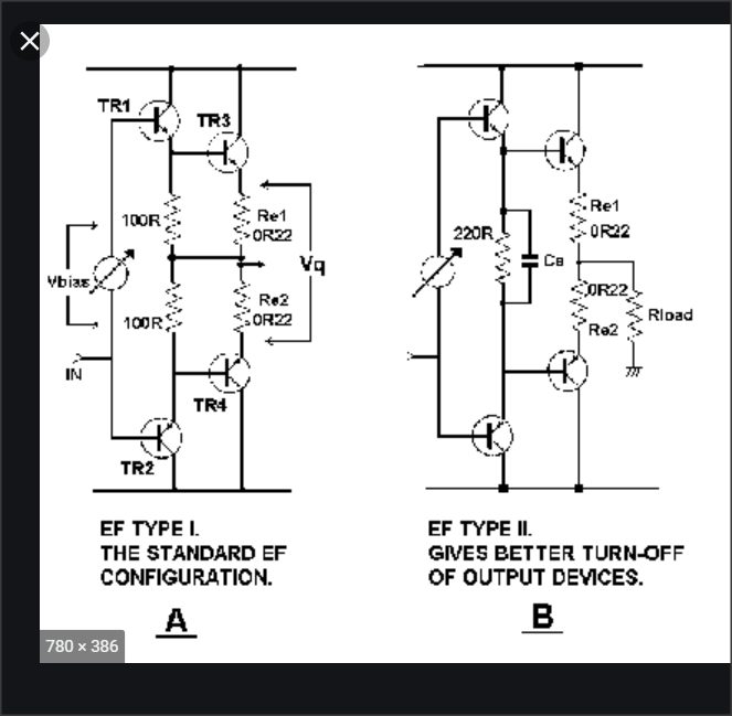

I think he is referring to R32, R33
Pico is correct. If R32 and R33 are connected to the output there may be added asymmetry during zero-cross. I think it was James Bongiono was the first to point this out, I will try to find the relevant article.

Doug Self has also noted this in the design of his Blameless Amplifier. 🙂
Switching speed seems to be the issue here. Granted the example is for bi-ploars it remains to be seen what it does in the Buzz Bomb,
