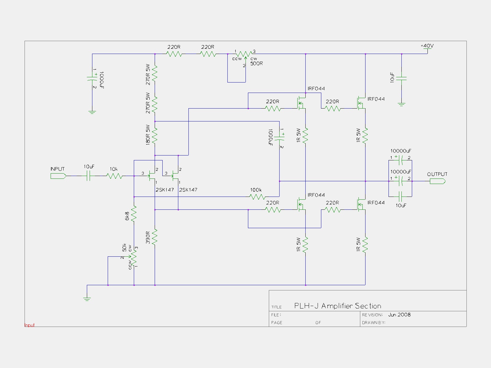

J-JLH or PLH-J ?
You can transformer couple the input so as to use a split supply with DC
coupled output - this way you can reject the supply rail noise, something
you don't have to do when ground is the lower rail.
Alternatively you would put one or two front end transistors to level-shift
the input down to the Gate of the driver transistor - but then you have the
original JLH circuit with three stages instead of two.
If you had a very very quiet negative rail, you could make it work as is.

I asked to re-open this thread because it seems to be the course that I am on.
Given this circuit and costs aside would it be best to use a LSK389 setup in parallel?
I would like to try it in Pass PLH instead of IRF610 use LSK389 tied in Parallel or is it better to use 2x LSK170 descrete devices. May help on setting it up properly. Papa, I see your interview with them over there. Can you suggest one of their products for use as input stage of PLH in place of IRF610? I am in the process to make a PCB for this!
