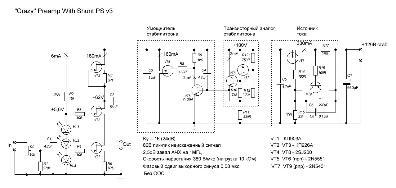

This is my high-voltage SS preamp, with simple parametric-like (no NFB) shunt power supply. Excuse me for notions in russian, but I guess the schematics is simple and quite clear. Design needs transistor matching, since it has no NFB. Voltage amplification 22dB. Maximum output voltage swing 80V peak-to-peak.
VT8,9 - current source
VT6,7 - zener substitute
VT4,5 - zener power booster
VT1 - high Idss j-FET (Idss=600mA), Ciss=12pF
VT2,3 - russian SIT transistors KP926A (something resembling 2SK60 from SONY)
I believe, this shunt PS schematics is just OK, using more complicated ones with NFB loops can be counterproductive.
Don't let it fool you, since it counter amplifies the rail against the reference, that is feedback.😉 Nice clean conceptual work as always. Well done.

Nice circuit. Consider this: Halve R2 to 6K8, connect top to drain of VT2. Remove C1, HL1-3, connect 1K5 in place of C1.
Ultra-linear cascode?

I afraid, the big gate capacitances of VT2, VT3 (2000pF) can cause some problems in the version you propose, although your idea is nice and thanks for creative look on the things.
You can always tie the voltage divider to the base of an EF; that would shake rather than stiir the gate, n'est pas?

Different case..... what I propose is modulating the base of the cascoding jfet at half the AC output to confer a type of ultra-linear operation. This has advantages in that it promotes even over odd harmonic generation.
I have nothing against LEDs as voltage references for CCSs and use them in most of my amps. I also like bootstraps, since by varying the resistor ratio one can tailor the harmonic profile as well as load up the amplifying device at higher frequencies when the ESR of the electro rises. This helps with Bode/Nyquist stability by reducing loop gain at supersonic frequencies.
Would anyone have a suggestion for replacing the obsolete Toshiba 2SJ200 MosFet in the shunt ps section? I’m not coming up with much using online cross reference charts? 😕
I think the Exicon transistor EC-10P16 could be a replacement for 2SJ200

Thanks for the suggestion Vladimir. But, I believe the 2SJ200 is a vertical mosfet (drain is center leg) and not interchangeable with the Exicon Lateral mosfet. Also, I’d like to use a standard TO-3P/TO-247 type package.

You are right. You could also look at 2SJ618 datasheet, Toshiba, input capacitance is 2300pF instead of 1300pF, but I think thios should not be a problem for application in shunt PS.
