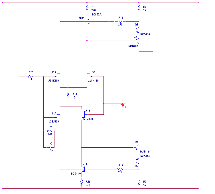

Playing with the idea of 4 jfets, self biasing input.
A "mirror with gain" intermideate stage, having current feedback.
The simmilarity with other symmetrical input circuits are obvius. My fokus is on the intermediate 'interface' stage and hopfully improove it.
Oh by the way i was playing with 30v supply's
