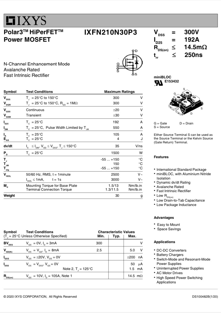

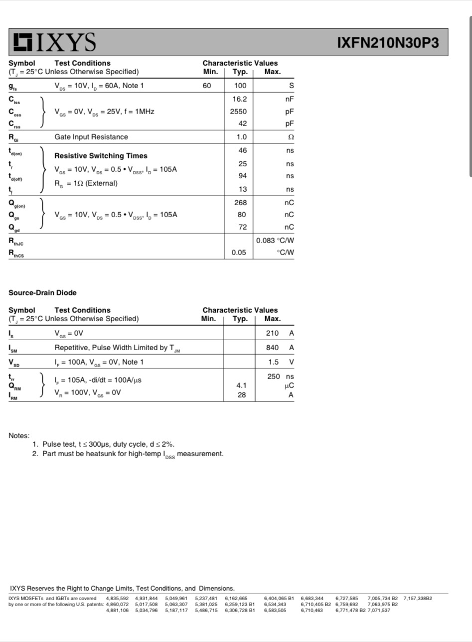

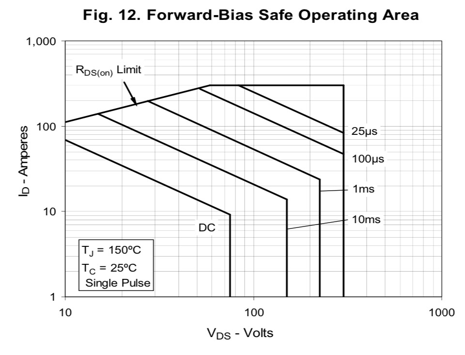

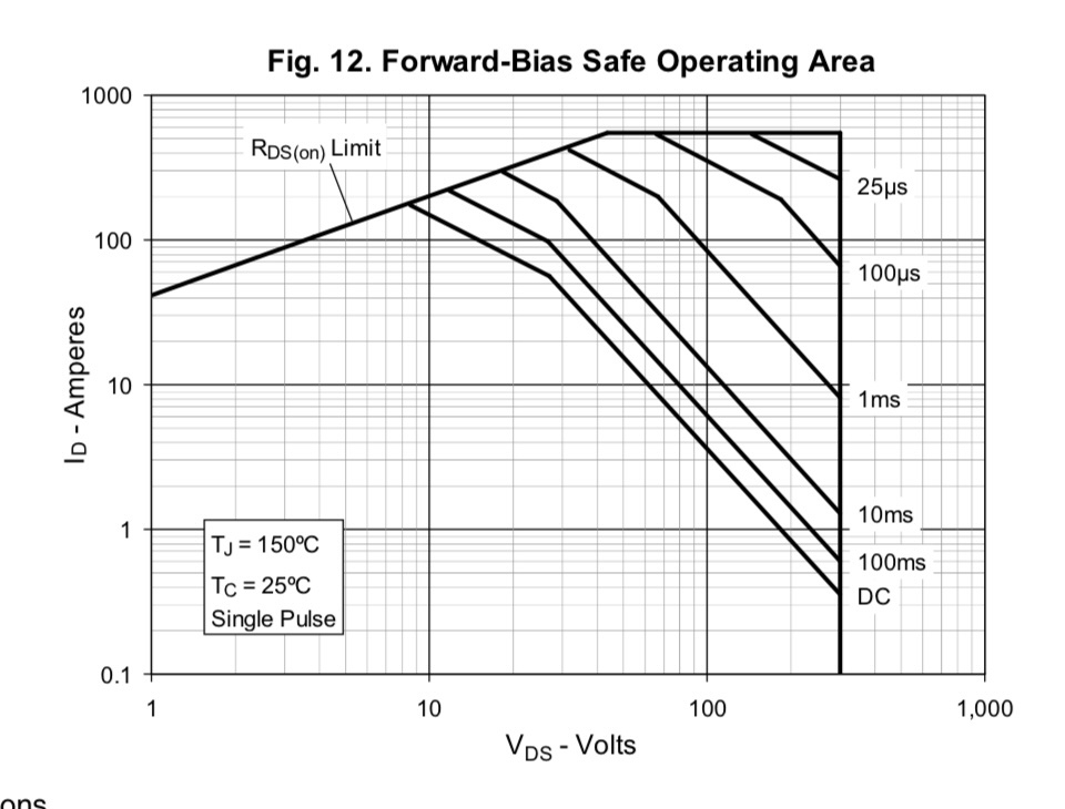

Hi Dirk
Thanks for the SOA reminder. Do I use the DC curve in the SOA since the other curves are for single pulse.
For Aleph 5 with VCC +-35, with the intent to drive speakers with low impedance of 1 ohm, sonic quality aside, from SOA, would the IXFN210N30P3 (SOA 3rd pic) be a better candidate than IXFN140N30P (SOA 4th pic) electrically?
IXFN210N30P3’s:
RDS is 14.5mOhm (vs. 24mOhm)
dV/dt is 35 V/ns (vs. 20 V/ns)
Ciss is worse at 16.2 nF (vs. 14.8 nF)
Qg is worse at 268 nC (vs. 185 nC)
existence of DC curve in SOA is condition that part can be even considered
if yes, then look at interelectrode capacitance as next criteria
you'll not find any guidance for pairing by xconductance, simply by lacking proper info for area of our interest
but, they're so wild in xconductance department, that info is hardly of any practical importance
edit: regarding SOA graph DC values, matter of perspective - think about conditions in circuit - in moment of greatest current through part, what is voltage across the same?
suddenly, part is much more potent than looking blindly at numbers
