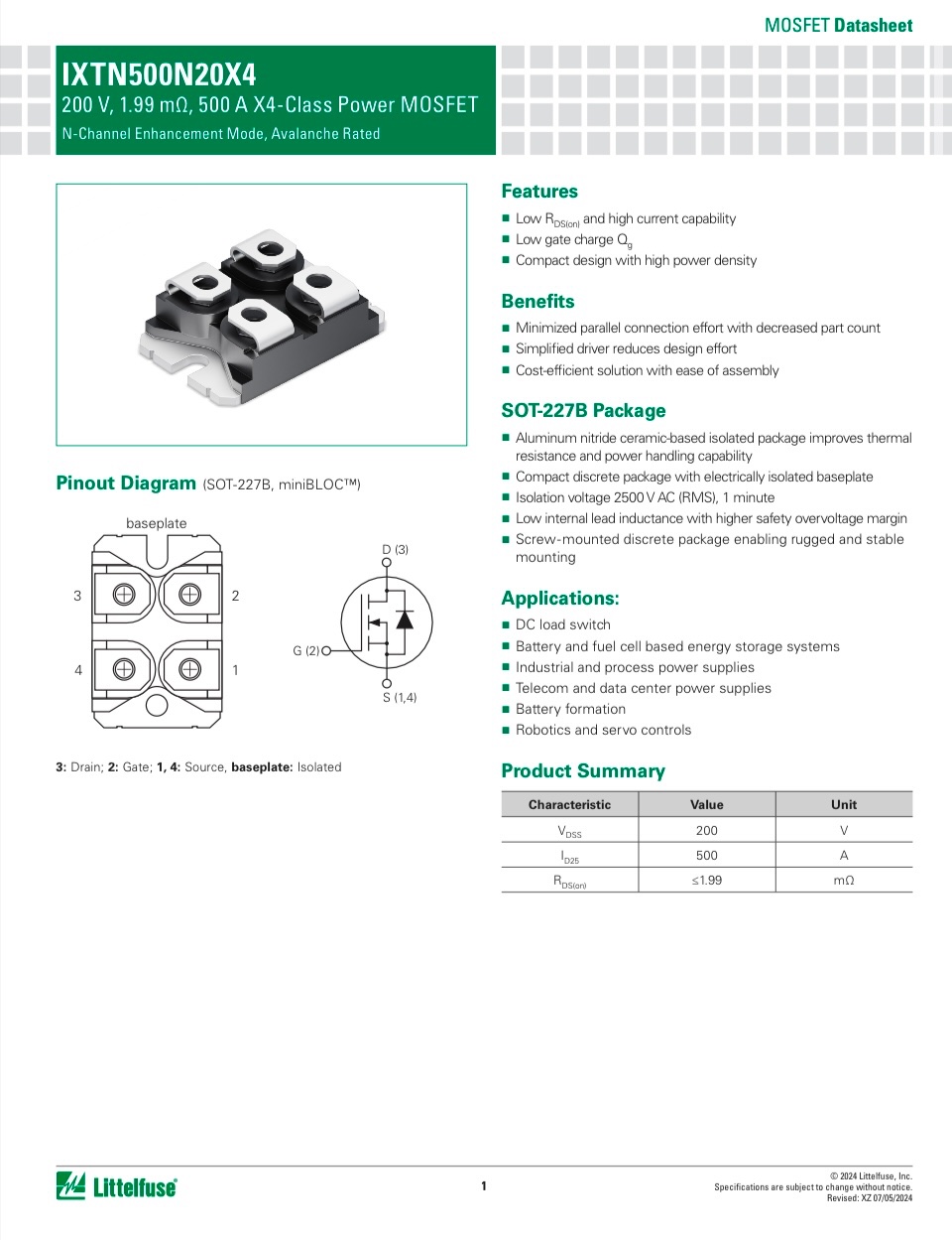

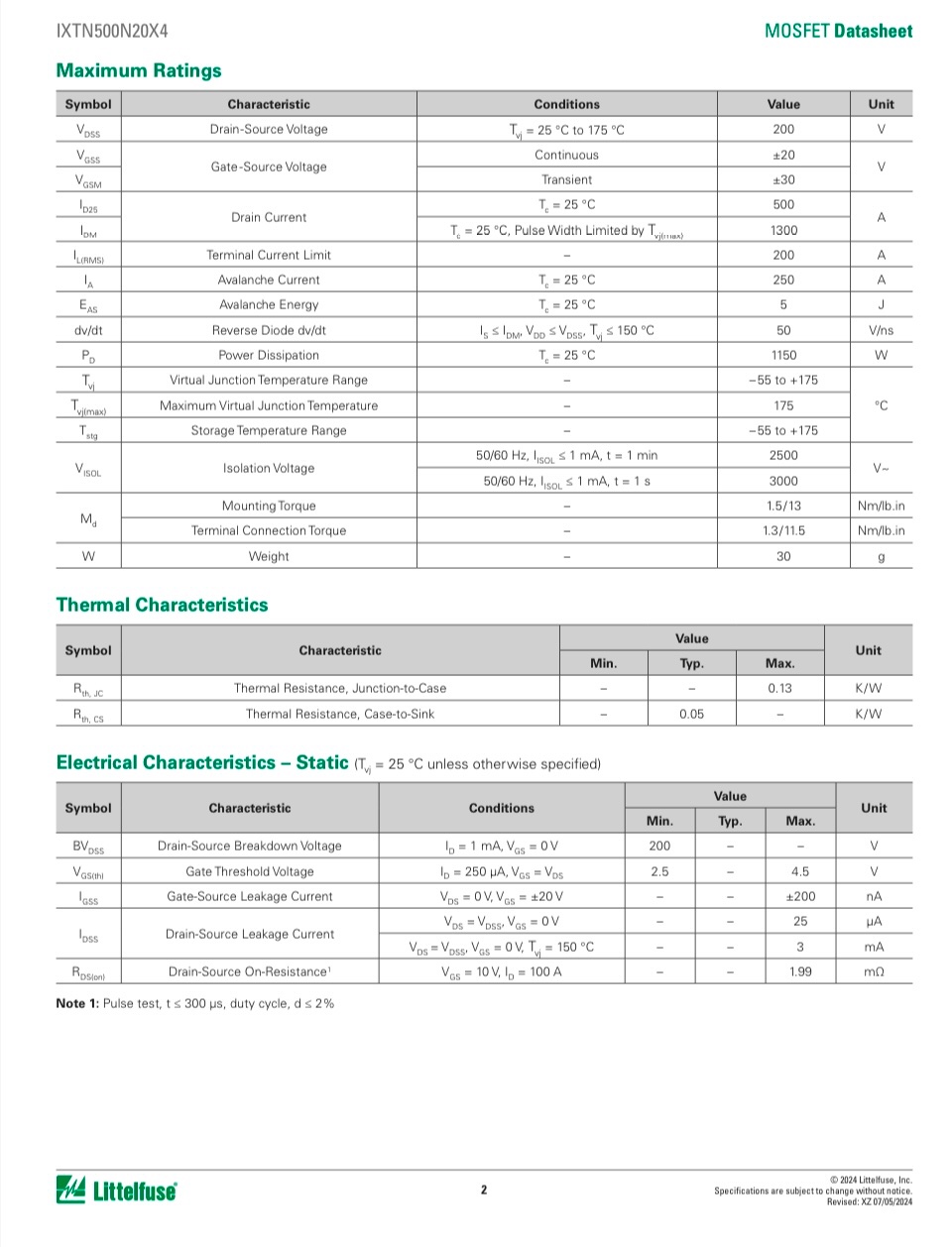

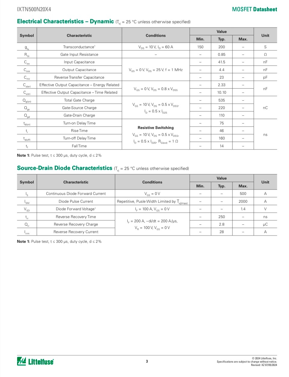

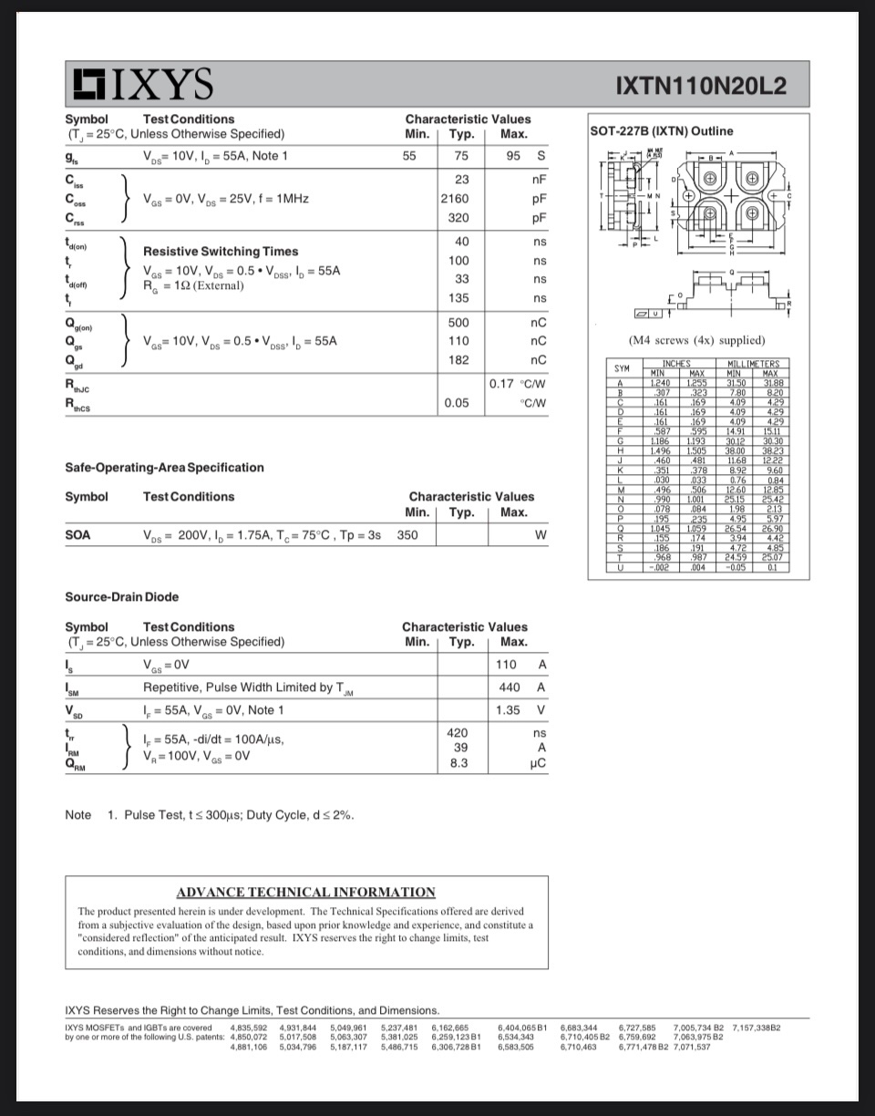

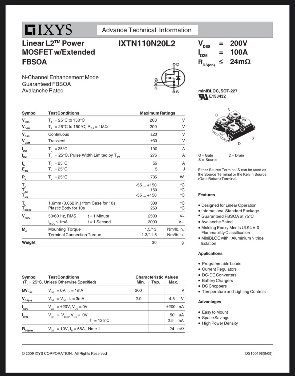

I am contemplating using a pair IXFN400N15X3 in TO-227 packaging to replace the 6 IRF244 in my Aleph 5 build, to get away from the matching issue.
On paper it seems to be impressive RDS, lower than 3 IRF244 in parallel, VDS is lower but adequate for my Aleph 5, ID 400A, Qg higher than 3 IRF244, PD 695W.
Anyone knows if this is suitable as IRF244 replacement?
If some expert here could help with designing the output stage of the Aleph 5, I shall be happy to be the guinea pig to report the outcome, with fire extinguisher on standby, of course.
Here is the data sheet.

There is also a IXTN500N20X4 released last November that has an ID of 500, VDS=200, RDS=2mOhm.
This of course, may be totally unsuitable for audio amplifier.
Pardon my ignorance.

I would be careful. Besides the problematic input capacitance, most of these big beefy looking SOT packages are meant for switching operation and if you look at the DC performance in the SOA graph it's pathetic. Unless you really need 10A at 10V.
I would consult littelfuse.com, and find the so-called extended Forward Bias Safe Operating Areas (FBSOA) types. These are linear operation guaranteed. I am not sure what you're going to find because most of these, although they are in production, are not stocked by any of the usual places.
The matching issue is no big deal, so that should not be the motivation. If you want to play with the bigger chips,
I say OK, but maybe start with something a little more modest... 23 nF is quite a lot of capacitance.

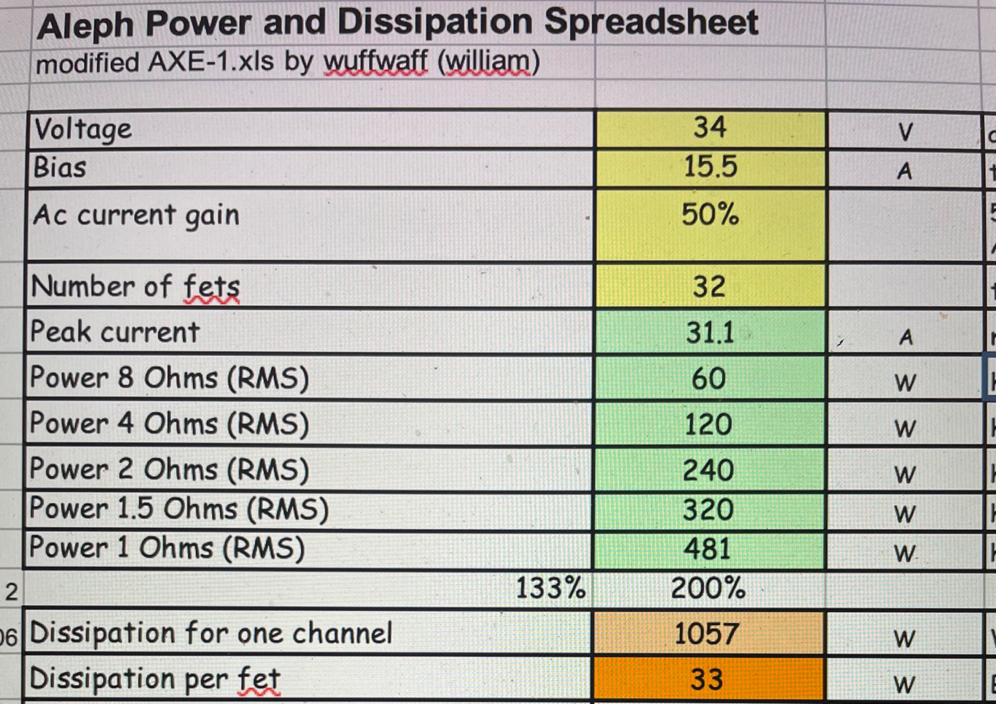

I was trying to build an Aleph 5 that is capable of driving low impedance speakers, hoping that it would deliver 200W@2 Ohm, and if possible, 400W@1 Ohm.
But matching the many transistors is a challenge, and I managed to overcome that, but the suppliers who sold me the 64 matched MOSFET, from more than a thousand MOSFET, whether it was an exaggeration or truth I wouldn’t know. He couldn’t sell me another batch of 64 matched MOSFET, even though I did pay a little premium for those.
But the next problem arises when I read somewhere that one can’t go more than 6~12 MOSFET, depending on the specific MOSFET, and I was giving on my earlier intent.
So your information just open another avenue for me. I am going to read up a bit more, hopefully could use the massive MOSFET to achieve my objective.

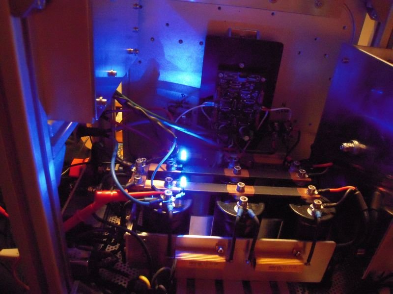

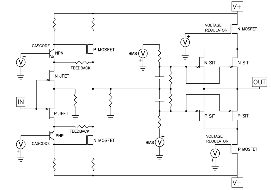

I used the bias mechanism of Zen Mod and paired it with a pair (N-ch / P-ch) 'Hockeypuck'-MosFets from IXYS.
As the driver board I made something similar like Sony V-Fet -driverboard from Mr. Pass (see pic below).
Something like a cascoded BA-3-frontend.
If you want to build something crazy like this, I would use ZEn Mods boards (Babelfish XA252 full Mos).
Cheers
Dirk
p.s.: and be sure, that you need a lot of aluminum / heatsink for the IXYS-Mosfets biased to 2.7 A! :rofl:

why you need 64 matched mosfets?
you need matched group of those sitting on same rail
so, even for Aleph having 12 pairs in OS, you need one matched dozen and another matched dozen
no use and no need to have all 24 matched
Yes and no, I started with a modest target, and the 64 MOSFET that I got fit in nicely with 32 MOSFET per channel, calculated using the spreadsheet that a kind gentleman on this forum shared, delivering 60W@8 Ohm and 480W@1 Ohm(theoretically).
Then I got greedy, I thought that the MOSFET only need to be matched on one channel (just as you said), and if I get another matched 64 then I will be able to get 100W@8 Ohm, 800W@1 Ohm. That was when I am told that he couldn’t get another 64 matched.
The rest is history now that I read that I can’t use more than 12 in one channel due to Ciss being too large when more than 12 are connected in parallel together.
I am still tempted to try 32 MOSFET in one channel, that will still give me 50W ~ 60W@8 Ohm, and 400~480W@1 Ohm, if it works.
