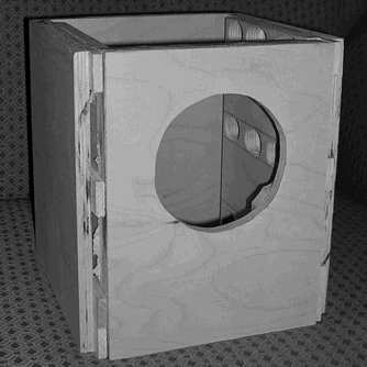

Well, one day into the project I'm learning how to use a friends router, how to make more wood dust than a continent of wood beetles. It pays to have good tools. I'm using a box of ceramic floor tiles to weigh down parts for gluing but despite the situation progress continues. I think it has a chance of working, and - it's going to be much better 2nd time around (if this pair works I have to make several more for the HT system)
Joined 2009
planet10 said:What are those holes on the inside, side walls?
dave
well, I got to play with this router and I just got carried away and made some holes. I started with some strange ideas of increasing Vb because the Fonken is quite inefficient user of space for small boxes but I don't think this saves much. Then I had an idea about a surface with odd holes in it being less likely to set up standing waves inside the box. In the end it just became a bout of madness - sometimes a man just has to make his mark.
I pulled out the wires from the back of my regular speaker and held them on the bare terminals of my new FE127 driver. I was quite surprised how much I liked the sound so at this point it would seem that any box will be good !
Bigun said:increasing Vb... a surface with odd holes in it being less likely to set up standing waves inside the box.
You do get both of those, but at the expense of the rigidity of the side walls.

yeah I don't think it's worthwhile making them holes. I think the rigidity is still good mind, give the small size of the box (Vb=6 litres) but for the front speakers I can afford taller boxes and the rigidity will be more important then.

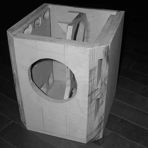

I took the plunge tonight and set up my hand-held circular saw for the 45 degree corner cut. I had quite some trouble. I had to duct tape the blade guard out of the way - not something you could ever recommend (and there's a little groove in my work bench to remind me). I had to nail a strip of wood on the front of the box to guide the foot plate or it simply wandered off the corner. The saw didn't half groan through this job!
Still, it's done and the boxes survived ! I wasn't patient enough to put the lids on until I'd satisfied myself that the batten would do, so I'll hand finish the chamfer on those before I glue them in and then do a final sand to ensure the chamfer lines up nicely.
I do like this Onken design, it's been a lot of fun to build so far, more than I had expected. Unless they sound like cats fighting in an alley I'll most likely be happy with 'em.

Bigun said:I'm not that knowledgeable about the cups. I bought a small round one as this seems best size-wise and I wanted something that was both gold plated and that accepts both banana-plugs and can also screw down on bare wire.
The little ones are goof (smaller hole cut into the box, but the solid ones with gold are to be avoided...
You got these ones? (everyone sells these)
These are preferred (but a lot of people think they look cheesy)

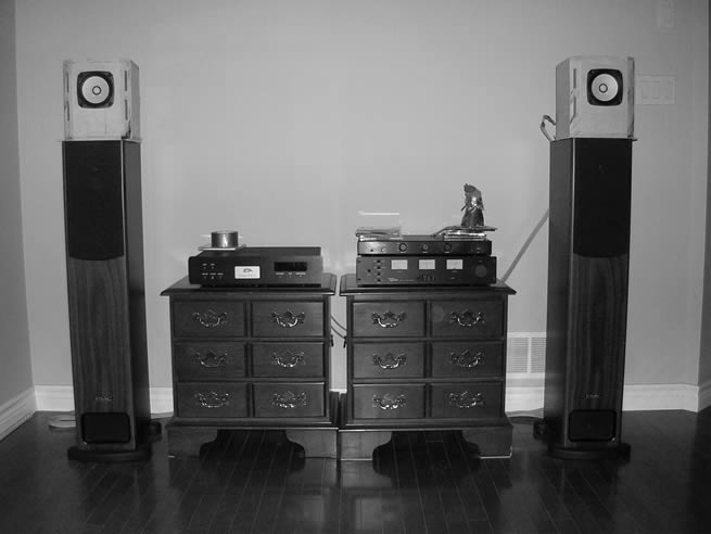

Well, a pair of new Fonkens are born.
The terminal cups are held in with duct-tape for now and the box isn't sealed (I will caulk it on the outside prior to finishing).
Compared with my floor-standing PMC FB1s you clearly notice something is missing. It's the extended LF. The bass is fine and it's tight, but of course it can't go as deep. No complaints. I think the tuning is close to where it should be, I thought I heard a bit of 'boom' but then a couple of tight drums dispels any doubt.
Imaging is amazing, I can't easily do an A-B with my PMCs but the Fonkens are at least as good, if not better.
There is something not yet right though. The high's are a bit harsh, slightly confused, a 'fuzzy' edge to them. It ain't smooth enough. Male voices are superb, female voices suffer at the high end from the 'fuzzy' edge.
Of course the drivers have had no time to break in yet (not sure how much change to expect after break-in) and I strongly suspect that there isn't enough damping on the inside-back of the box directly behind the driver (which I could readily fix if I get convinced of the need).
It's quite a record for me, entering a new 'hobby', contemplating and finalizing a design for what - maybe 2 weeks at most (accelerated by planet10) and then building it to this point in 5 days.
sounds like a bit of tweeter distortion - either tweeter XO frequency is too low or you're driving them too hard.
What do you think?
Edit: DOH! fullrange!
edit: by the way, a can of bondo, a sander and a paint job will do wonders!
Bigun said:There is something not yet right though. The high's are a bit harsh, slightly confused, a 'fuzzy' edge to them. It ain't smooth enough. Male voices are superb, female voices suffer at the high end from the 'fuzzy' edge.
With break-in the bottom should improve, and the top end should smooth a bit. The issues caused by the 7 k peak and the cone self-noise will not completely dissappear. The pre-treatment that i do mostly cures that. The rest of my regimine adds a couple layers of icing, and some ice cream & whip cream.

I'll give it a week or so, seal the box and finish it off then listen some more. I have read about your treatments but hadn't thought of putting my hand to the cone yet - but now that I've got this far I may just as well put that on the list of things to have a go at.
